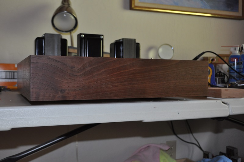

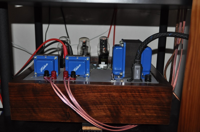

EP on one amp, Edcor on the other. The EP iron replaced Hammond iron. Both SE. They each have their virtues. nothing wrong with Hammond iron, especially if you impatient.
