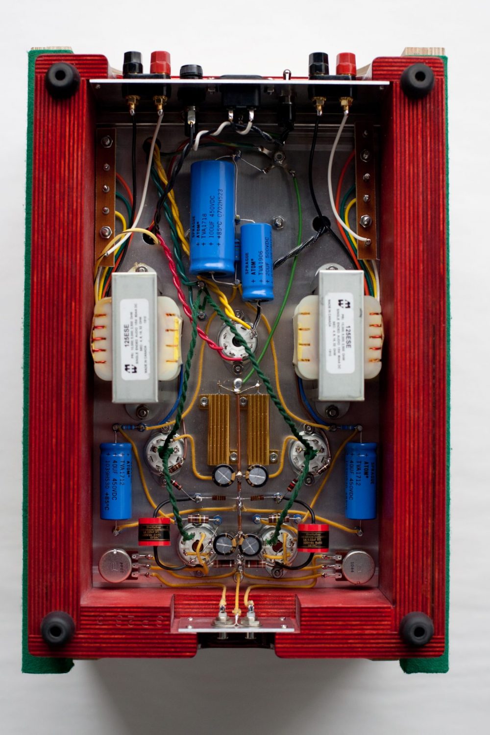

These Hammond graphics goes only to 50kHz not the usual 100kHz, they are useful for hi-fi evaluation purposes ?
Why its not rec for hi-fi use by the manufacturer?
Designed for general purpose or replacement use (not Hi-Fi),
This trafo could be suited to Headphone amp use?
Primary impedance range from 2,500 to 10,000 Ohms.
Secondary impedance range from 4 to 32 Ohms.
(amp are EL34/KT66 SET to HifiMan 32 Ohms 90dB)
Frequency response: 100 Hz. - 15 Khz at full rated power . Good for some AM radios restauration .
So low inductance and poor interleaving for high frequency .
And the graphs are misleading😀 , 0dbm = 0,001W , useless to draw meaningful conclusions

All true,
Measurement on that low level is not realistic, inductance on 1Khz is also not useful - I would say based on experience that is at least double that value on 100Hz - if not more.
Yet - it does not stop companies to use this transformer in their final product.

I have a pair of 125ESE here - about a dozen years old.
I used one of those Mega 328 component tester things to look at the inductance, and got 11.5H on one, and 13H on the other. For whatever that is worth.
I measured the frequency response at one watt in an actual amplifier, and it seems like it was a bit better than spec at the low end, and on the high end began a gentle roll off at 6 KHz, and was down about -1 dB at 15 KHz. I thought they did pretty well on two tone SMPTE IMD. The measurements are on here somewhere, don't feel like searching for them.
I measured primary resistance at 91R on one, and 92R on the other.
