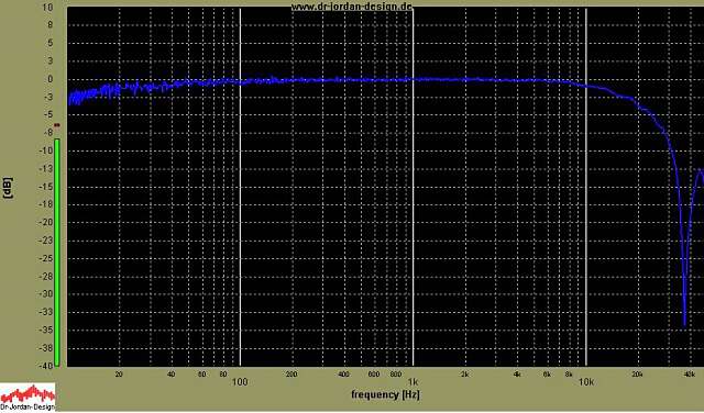

I spent much of yesterday testing, and listening to transformers. Two sets in particular, the big Edcors, and the 1628SE's. I noticed during listening tests that one of the Hammond transformers sounded significantly different than the other. Upon further testing, I discovered that one tested far better than the other. The two transformers LOOKED different. They were both made on 11-17-2004, however it appears that one was dipped in varnish, and the other drowned. The leads are all black for the first 6 inches. That one is the good one!
I was about to dismiss the other as a defective transformer when I decided to check it with an ohmmeter (because of the comments made by RDF). Well the secondaries look normal, but the primary does NOT. After a little head scratching, I came to the realization that the blue and the blue - yellow wires are SWITCHED! I have been testing these transformers in UL mode, and this would really confuse the poor tube, so I swapped the wires and tried again.
OK, these things sound pretty good. It is immediately obvious that the bass is far better than my speakers are. I can see 1/2 inch cone movement, but very little sound comes out. I have only seen this before with a SS amp. The SE "sparkle" (noticible on piano transients and cymbals) is not as good as the $18 Edcors, but it is similar to the big Edcors.

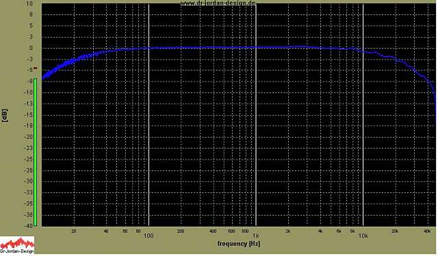

OK, test time. I re-ran the freqiency response tests. The 1628SE's now look reasonable, there is a gentle rolloff starting at 10KHz, with the 3db point at about 19 KHz. No 13KHz notch, or funny ripple. Both transformers now test and sound the same. The HF response can be improved about 1 db with about 3 db of cathode feedback.
Further testing is underway. See the next post.
The picture is the frequency response of the 1628SE in UL mode without any feedback. It is being driven with a 6L6. I am using a cheap 6L6 because I can pound these hard without fear of them blowing up, and If it does blow up, it cost $4. I am running it slightly above maximum ratings, for the most available power.
I have been looking for a way to quantify the ability of a transformer (and the entire amplifier) to handle big bass. I have run frequency response curves on all of the transformers, and they all look pretty good. It is evident from listening that the physically small ones saturate heavilly below 100 Hz. This does not show up on a frequency response test. I need a better test.
The SS boys use a test called power bandwidth. It is basically a distortion sweep made at full power. I tried this on several SE amps and the results look pretty bad. I still need a better test.
I am now doing distortion VS power curves. I do one set at 1KHz which reveal the capabilities of the basic amplifier, and also tell you about the losses in the transformer. (look at the power available at the knee in the curve). I started to do a second set of curves at 20 Hz but the ONLY transformer that worked here is the Hammond 1628SE. The big Edcor can't make it. I think that 3 sets of curves are needed 1KHz, 100Hz, and for big transformers 20Hz (or maybe 30 or 40 HZ). I am working on these tests now.
Now that I have figured out the mystery of the 1628SE's (at least the set that I have) I will keep them. The 1628SEA's are still on "special order" and I will report on them when they arrive. If they do have improved HF response as Hammond claims they may be the low cost (under $100 USD) winner. They are by far the heaviest. So far I can not disprove the "bass is sold by the pound" theory.
Included is the frequency response plot for the big Edcor transformers. The test conditions are the same as the Hammonds. The HF response and efficiency is slightly better than the Hammonds, but the low end is not as good.
