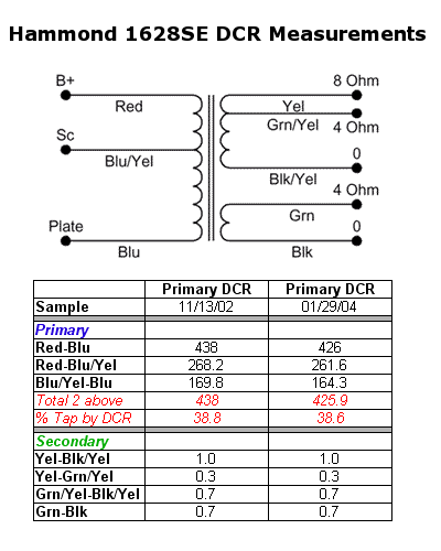

tubelab.com said:Well the secondaries look normal, but the primary does NOT. After a little head scratching, I came to the realization that the blue and the blue - yellow wires are SWITCHED!
Thanks tubelab. The mystery deepens. Your results spurred me to finally pry the Hammonds from the chassis and re-measure them. To first rectify earlier misinformation I propagated, the secondaries of my 1628SE OPTs measure in the sequence shown in Hammond's wiring documentation. The DCR between windings however don't correspond with the labels. The earlier repeated measurements I can only blame on over/under medicating or low batteries in the Fluke 87. The secondaries are split.
However my primaries appear to have been wired properly and the dreaded 13 kHz null appeared in multiple EL84 circuits (pentode and triode.) The full set of DCR measurements is shown below. The numbers in red are sanity-check calcs. Did your response tests use the 8-ohm taps wired as per Hammond's directions?
Yes the transformers were wired according to Hammonds diagram. I have spent most of today testing these transformers in UL and triode mode, with cathode feedback and without. I will graph the results and put it on the website in the near future. At power levels below 10 watts, the distortion at 44 Hz is nearly the same as 1KHz. These are the only transformers that I have that pass this test.

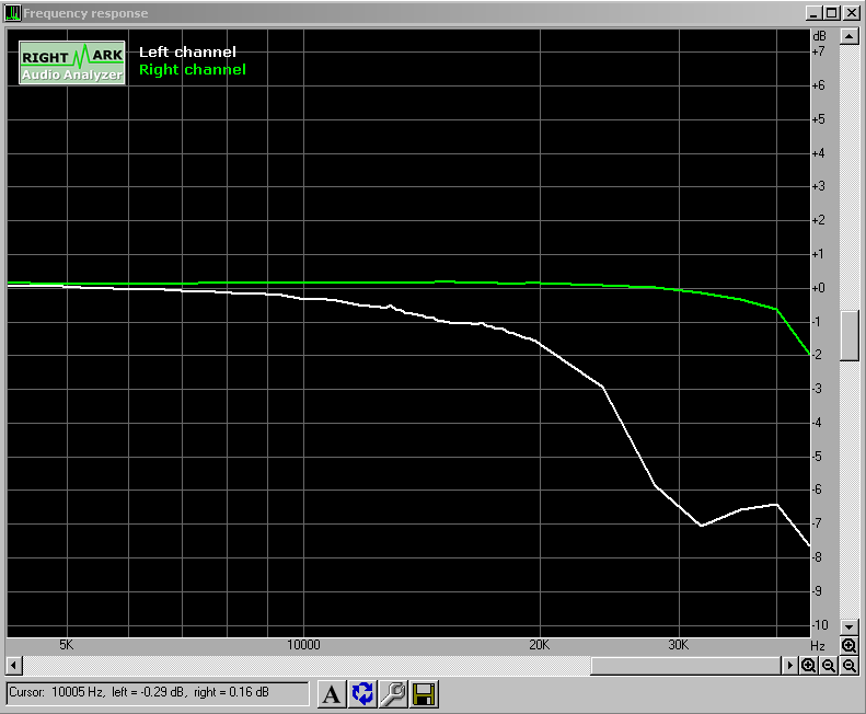

I tested the frequency response for 4 -ohm of the 1628SE OPT. It appears almost flat from 10 to 20kHz.

kmtang said:I tested the frequency response for 4 -ohm of the 1628SE OPT. It appears almost flat from 10 to 20kHz.

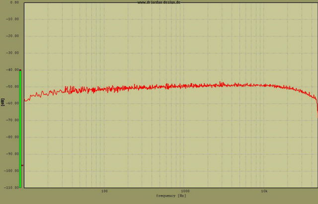

I guess that there are many versions of this transformer, or maybe each batch is different, I don't know. I posted the measured response (in UL mode) of my transformers (both are now the same) back in post number 39. I retested them wired for 4 ohms, I got the same result. The rolloff (-3.2 db at 20 KHz) is not quite as severe when wired for 16 ohms (-2.8 db at 20 KHz).
I also ran these transformers in triode mode (same response). I then tried them with cathode feedback this improved the high end by over a db in UL or triode mode. I took a lot of power VS distortion measurements. These things will run at full power (12 watt amp) down to 25 Hz without distorting! The big Edcors will not. I will be doing simplar testing on the Edcors this weekend. All data will be on the web site when I am finished.

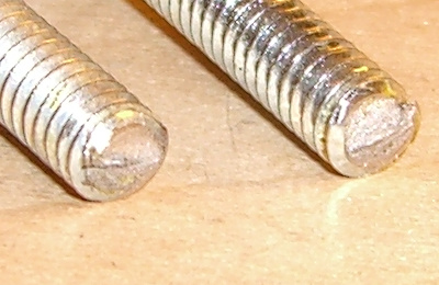

Don't know, lucky? Mine have been stripped and repainted because of the poor finish (not a task I enjoyed though they look great now) but I kept the screws:

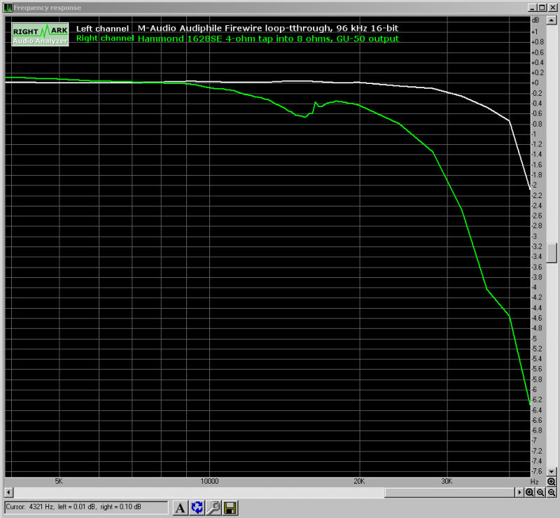

The 5K James was pulled from a GU-50 circuit on the bench and the Hammond 1628SE substituted. In the frequency response plots shown below the 8 ohm run was set at 1 watt into an 8 ohm resistor. For the 4 ohm plot only the ouput tap was changed and a 1000 ohm pot adjusted (it was in circuit for both runs) to match the 8 ohm level into the soundcard.

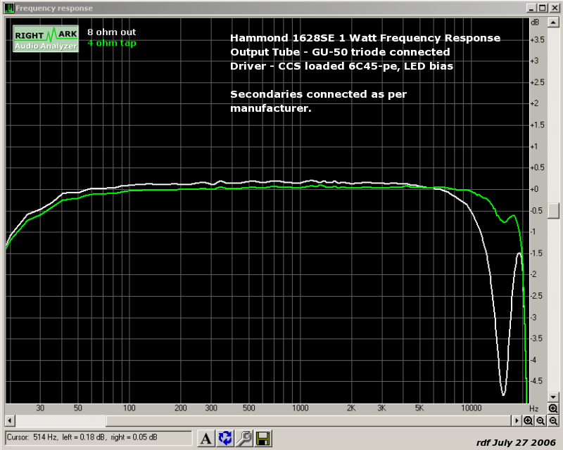

Well it gets more interesting still. The secondary windings were split and measured independently. The results are once again below. The 20 kHz limit is mostly soundcard. A level mismatch above 10 kHz appears between the two 4 ohm windings. The independent 4 ohm also has a bit of a null and most likely significant phase shift. Tying the two together as designed results in partial cancellation above 10 kHz. The bright side is there appeared to be little-to-no level difference into an 8 ohm load between using one 4 ohm winding and parallelling them. An approach might be to use the independent 4 ohm winding for output tube cathode feedback instead.

Ouch that IS nasty. Mine was not that bad even when it was wired wrong. I did some digging around on the web and it seems that the problem has to do with a phase imbalance between the 2 secondary windings. They try (successfully in your case) to cancel each other when they are wired in parallel. Try using just one secondary. leave the one that only has two wires open, you will get more loss, but the frequency response may not be as bad. Others have reported good luck running them in 16 ohm configuration. Use with an 8 ohm speaker results in a 2500 ohm transformer. Others have decided to use them as plate chokes for parafeed amplifiers (all secondaries open).

I'm not 100% convinced though that the 4 ohm phase imbalance explains everything. The 4 ohm response alone doesn't display a deep null. It's not until the remainder of the 8 ohm winding is tacked on top that things go south. It's appears instead some weird complex reaction between the phase imbalance you describe and that remaining section winding.
So I have at least a couple options (including splitting the secondaries and using one for cathode feedback) for turning these trannies around. And the 813 might just be the tube to provide the required power overhead. Also have a box of 828's if that's overkill. Given your accolades regarding the bass I can't wait to hear what they'll do running an effective 10K:8 driven with a big transmitter tube. 🙂

Re: the 1628, I spent the last couple days beating on it with an 828 and an 813. Something I found worth trying even with tubes like these which bias at -100 VDC: split the secondary windings, take the output from the 4-ohm tap of the 8-ohm winding and use the individual 4-ohm as a cathode feedback winding to the output. In the case of the 813 the result is a DF ~ 4 and a smooth high end rolloff about 1.5 dB down at 20 kHz. See results below:
