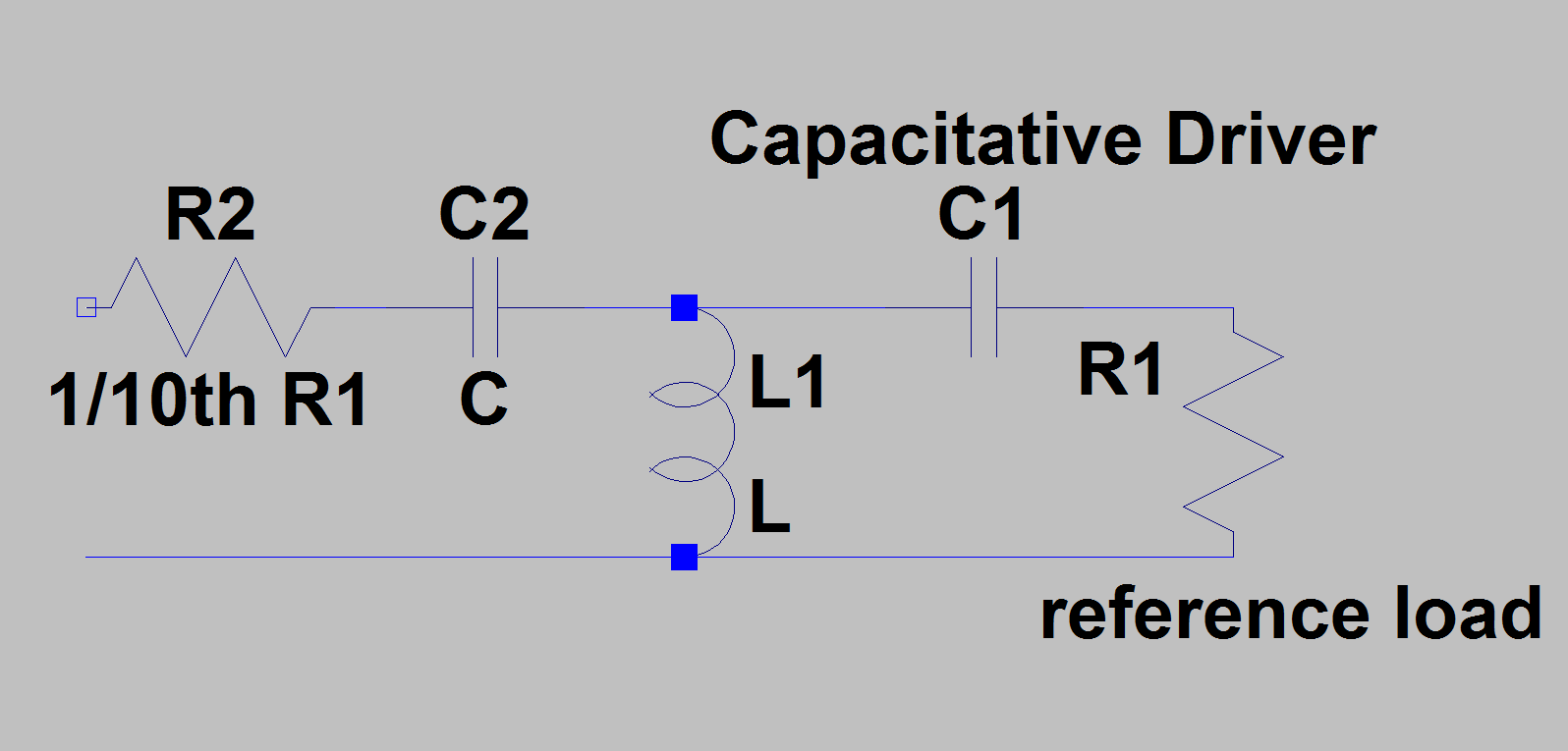

If the high frequency driver was of another form other than a coil, how would that crossover look ?
I haven't figured it out. Electrostatics can be treated as capacitors.
Could look like this passively
But due to loses maybe this is where actives come in
I would imagine you can treat it much like a Piezo-electric tweeter, and shunt it with a resistor say 8 Ohms, or 16 Ohms for (perhaps) convenience. then design crossover as a ~ 8 Ohm load, or more exactly, like a Parallel RC network. Potentially high Capacitance might be an issue...Im not 100% sure....Maybe that an avenue worth persuing?
Maybe something like this...im not 100%
Series cap for protection only,may want to add a series R instead. Though it may not be needed at all, the trap may be enough.
