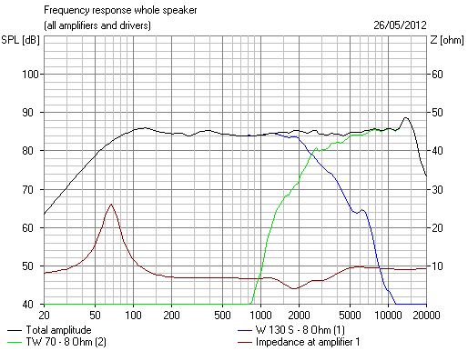

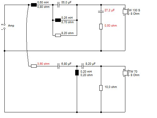

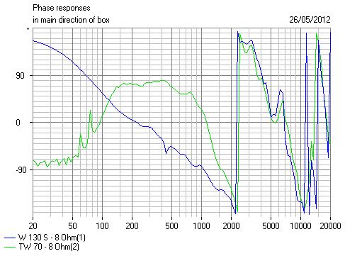

Meantime I've been modelling the TW70 with the W130S, and getting great results with second order bass and third order tweeter in conventional flat-baffle BBC type tiny 12L bookshelf. Very reminiscent of the Acoustic Research AR-7 which I know speaker dave is familiar with and has modified in its AR-4 version. Notice how the crossover uses natural voice-coil inductance and near Zobel capacitance.
BTW, back on-topic, second order is good, but do consider third order now and then. It's whatever works really! 🙂

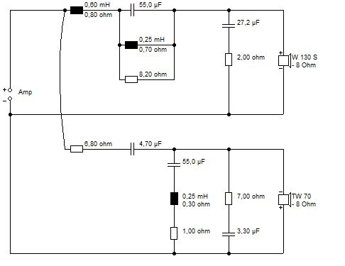

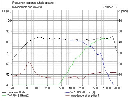

This is interesting, IMO. Here's a comparison of the Visaton TW70 tweeter with a standard 3rd order filter, and with a first order plus a tweeter Fs notch at 1400Hz and a Zobel. In fact you won't get it to work at all without the notch with first order. 🙂
Strangely, if you look at the diagrams, you end up with much the same result. I haven't included phase, but it's good in both cases. It is also interesting that both paper woofer and paper tweeter need a trap or notch at exactly 1400Hz. Is that a signature paper resonance? Not sure.
Overall, the tweeter notch makes it behave far more like the Visaton FRS 5x8 Fullrange. It's as if the stiff surround of the TW70 has been replaced by a soft surround! 😎
One other thing to bear in mind, is that a third order filter (or anything higher) doesn't really bring anything new to the table. In reality, it is a cascade of first and second order filters. Nature only does first and second order, if you follow. 🙂
