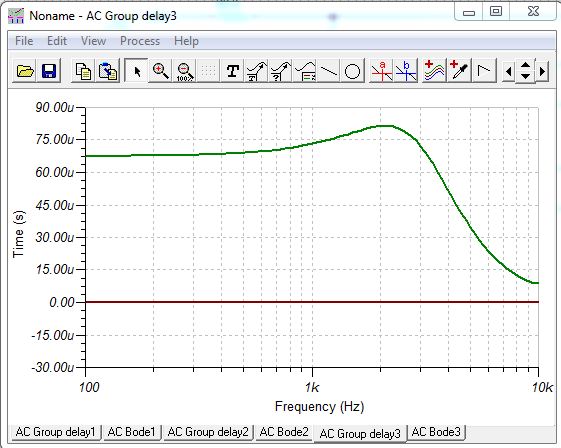

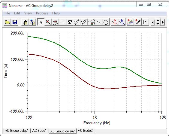

It's simple physics, my friend. All things being equal a closed box 2nd order butterworth bass rolloff has less group delay than the sharper rolloff of a 4th order reflex.
When you pull the speaker away from the wall, you then need to apply bafflestep correction aka bass boost. The coil that does that also adds group delay, as illustrated for this 3kHz 2nd order filter.
Bottom line is the modern freestanding bass reflex has slow bass. You'll hear this on drums particularly, which lack punch! Put a sock in your reflex and try it. 🙂
Not so.
It's not valid to look at the group delay caused by the baffle step correction circuit by itself.
The loss of bass due to the baffle step effect is a minimum phase phenomenon, and the BSC applied in a crossover which accurately corrects this loss of bass is also minimum phase. Fix the amplitude response, and the phase response and therefore the group delay will also be fixed.
The group delay of the speaker with accurate baffle step correction will be better than the one without correction, not worse...
