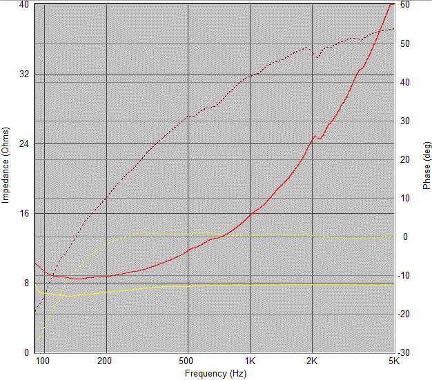

Here I've taken a plain 2nd order passive electrical with tweeter L-pad and woofer rise compensation and added a single RLC conjugate (yellow), vs the woofer as the amp sees it on its own.

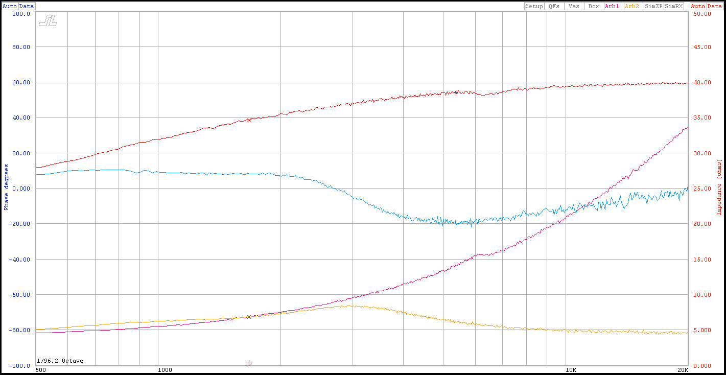

This is a measurement of raw driver (impedance cyan, elect. phase red) and the same driver in a 2nd order 2way with a Zobel (impedance orange, phase blue). So, not that much difference when done right with drivers that fall in place.
Actually, my concern with passive filters is more in the other direction; the fact that around xover your effective damping factor gets really low. I am a control freak and I want my amplifiers to control my drivers.
