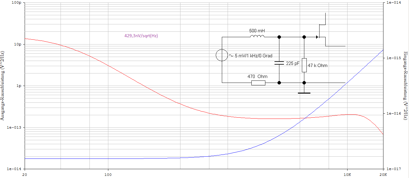

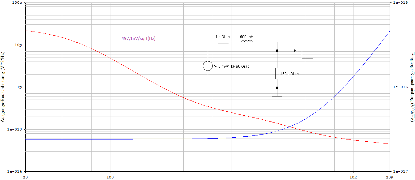

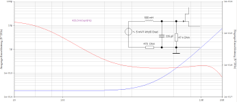

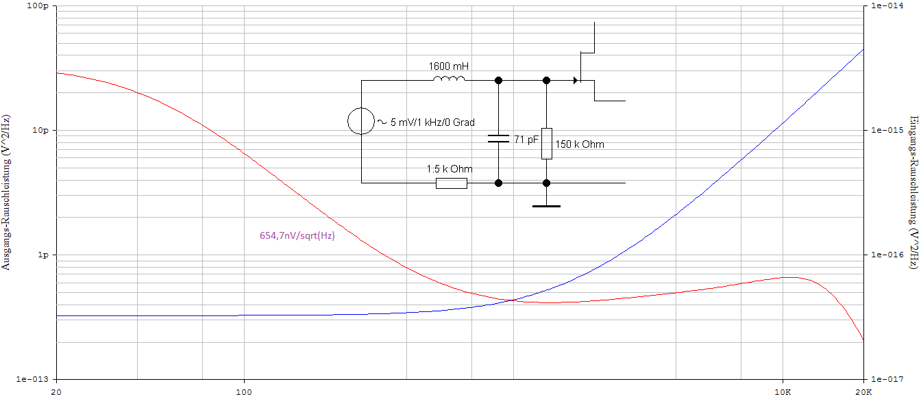

After Marcel feels misunderstood and Nick Sukhov offended, I can provide two curves that tip the scales back in favor of this party. Unfortunately, the tables can also be turned again, so for goodness sake I suggest thinking about two points: the evaluation / weighting and thus also the trasducer model used, as well as a comparative practical measurement under operating conditions.
The assertion that a higher resistance is fundamentally better because it produces less noise than a lower resistance is still wrong, as is the assertion that the actual amplifier with a higher input resistance produces less noise than one with a lower resistance.
Kind regards
HBt.
PS
Taken from the Aladdin simulation, the Sukhov SNR advantage is a full 0.331dB. It's basically nothing more than a trick.

Now let's finally clear up the trick or the fairy tale: the typical TP2 behavior is used to distract from a non-constant transducer in a generalized way, to simplify inadmissibly! For a theoretically viable comparison, as a thought experiment, the frequency-dependent internal resistance of the signal source must also match our terminating resistor ..!
And then all is right with the world. What do we learn from this, the termination always consists of an Rp & Cp and should result in a filter quality between 0.707 and 1. A Bessel characteristic is also fine with me.
This comparison is valid and leads to the aforementioned SNR advantage of >3dB on the 47k side.
The apodictic assertion that a termination with 150kOhms always leads to better results is not honest. That's all there is to it, so for me the Sukhov topic is actually over. I have already said, that the generator model used cannot be correct. This model is only a simplification to make the correct termination more comprehensible.

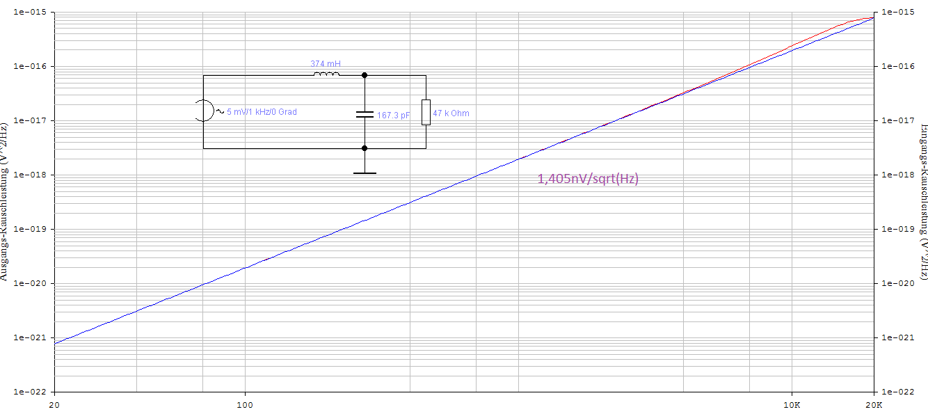

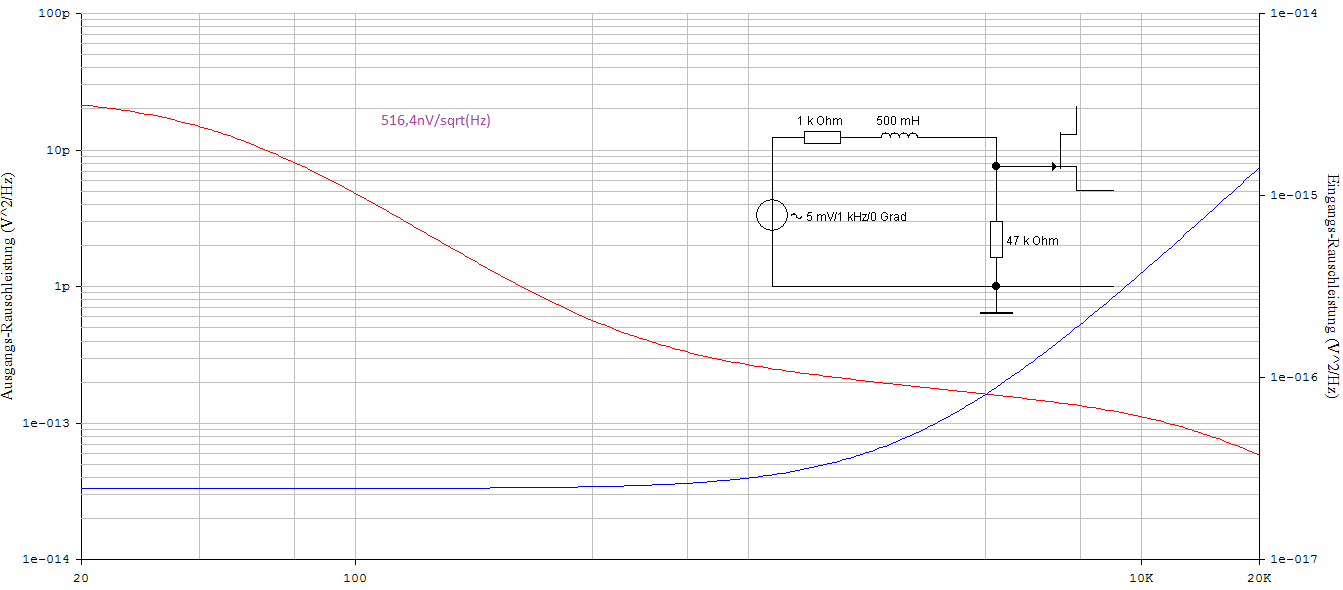

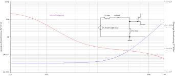

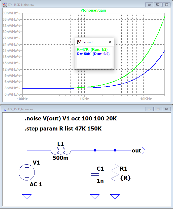

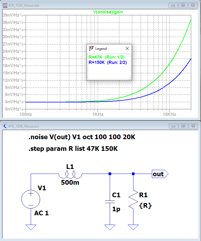

L1 is the cartridge equivalent, 500mH 500 Ohm. The first screenshot for C1=1nF, the second for C1=1pF. The "V(onoise)/gain" function takes care of the response changes and makes it clear that the real SNR at the input of the phono stage would not change with the load capacitance value (you could make it, say, 100nF in this simulation and the curves will not change). It also makes it clear that the SNR of the cartridge + load combination here is better with a 150K load resistor. There are other implications of the increased load resistance however these up to a certain degree can be addressed further down the signal chain.
Cheers
Alex
Cheers
Alex
Years ago I did a SPICE noise analysis of the simple model of the phono cartridge and load with RIAA deemphasis. I played with the load to see the effect it had. The first thing you notice is that about half the noise is in the first decade, 20-200 Hz and the other half is in the remaining two decades, 200-20000 Hz. The load capacitor didn't have any noticeable effect on the noise. It might put a little resonant hump in the noise, but it was way down in amplitude.

I'll try again.
1) The SNR at the input does not depend on the load capacitance value. As soon as you correct the response, you'll get the same SNR for the same load resistor. That what my sim shows.
2) Please explain how you define "the correct termination of our cartridge".
Cheers
Alex

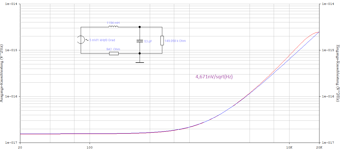

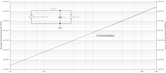

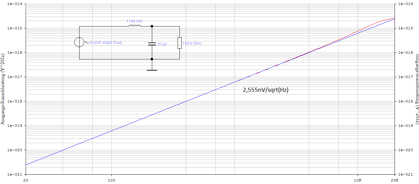

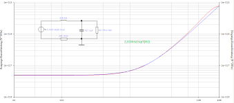

Compare A (1.194H; 53pF; 150kOhm) with B (0.374H; 167.3pF; 47kOhm) and set R1 to zero - I would be interested in this simulation comparison, then you compare almost identical H(jOmega), only the resulting (the frequency-dependent) internal resistance of our replacement signal source now differs.
I myself' am not interested in apples and oranges comparisons, only in clarifications

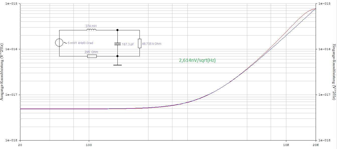

Now with the resulting COIL-DC-Resistor:
A => 4,671nV/sqrt(Hz)
vs.
B => 2,614nV/sqrt(Hz)
Perhaps we can now slowly see the nonsensical thread and the question of what is less noisy as answered.

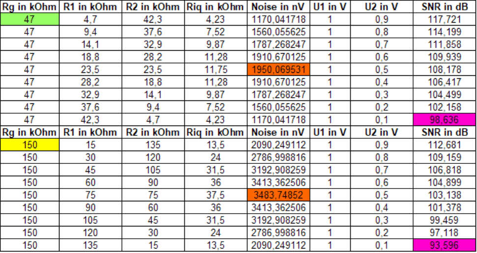

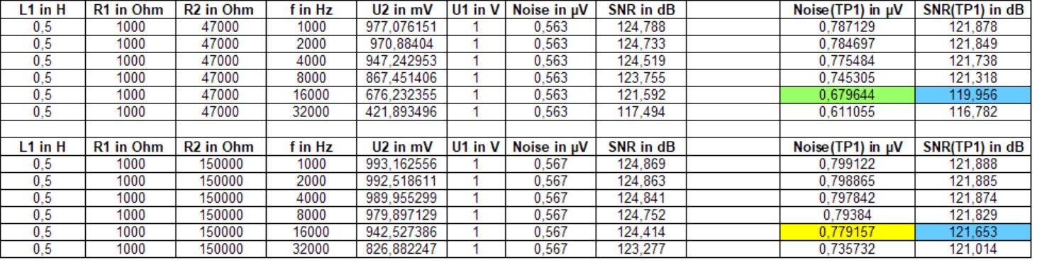

Rg in kOhm | R1 in kOhm | R2 in kOhm | Riq in kOhm | Noise in nV | U1 in V | U2 in V | SNR in dB |
48 | 1 | 47 | 0,9791666667 | 562,936584 | 1 | 0,9791666667 | 124,808 |
151 | 1 | 150 | 0,9933774834 | 567,006868 | 1 | 0,9933774834 | 124,871 |

Finally, a spreadsheet calculation, the resulting internal resistance was not used to calculate the measured resulting noise and SNR.
I apologize for any mistakes, they are due to my dwindling attention - I just don't feel any energy left to score a point.
An attentive reader will recognize the relevant problems and the fundamental error in the mental exercise - and will also be able to understand and comprehend my statements.
