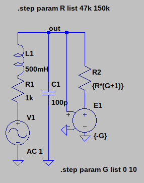

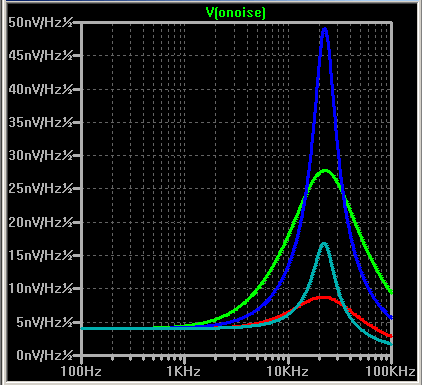

It's not immediately intuitive, so I did a quick sim:Hence, the noise density at 1 kHz at the loaded cartridge output is somewhat higher with 47 kohm than with 150 kohm. For a fair comparison, you would have to look at the input side, where the difference is slightly larger.
@hbtaudio, one way one can think of it is that at lower frequency the cart's DC resistance loads down the "load" resistor's own noise and 150k are easier to load down than 47k. Up to a point, that is, where the reactance gets large enough to reduce the effect to ultimately zero at very high frequencies... if there weren't for the intrinsic+cable+load capacitances. With 150k and my 100pF cap load sim we'll have significant frequency response peaking which skews the 150k load's total noise for worse, accordingly.
Note: The lower two curves are for "electrically cold" load resistors (10x).

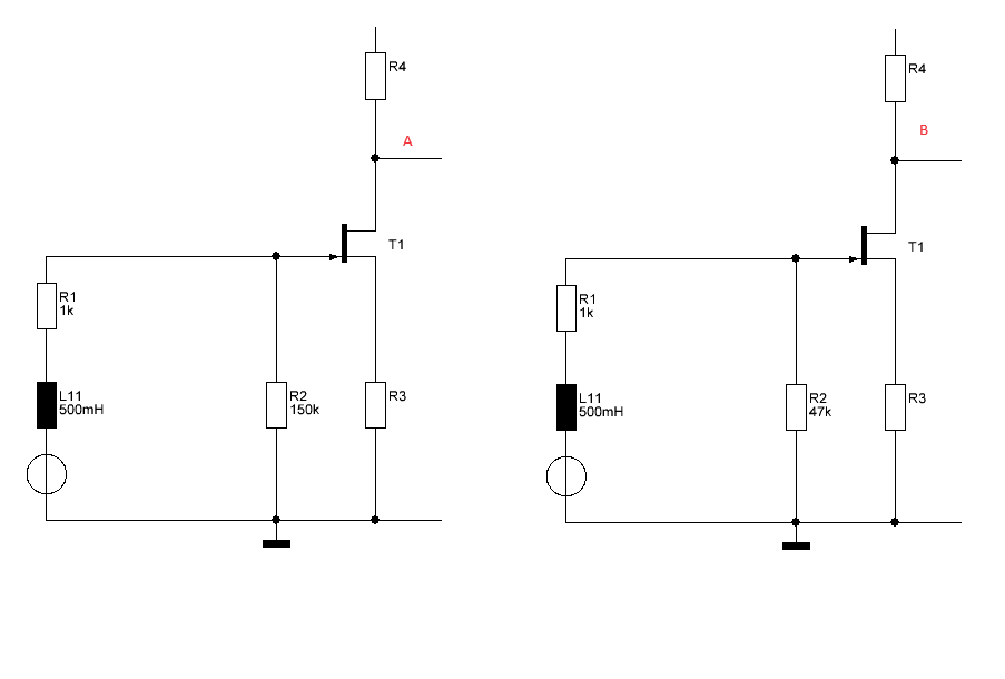

Excuse me, please ... there is no capacitive reactance in the model in question. Accordingly, there is also no second-order low-pass filter, and there is also no resonance point. And now let's be clear: we can imagine the voltage source in the video on the far left as a dynamic short circuit. Now both resistors are in parallel.
R1||R2 with
a) 1k||47k=0k9792 and b) 1k||150k=0k9934
UNRa = 562.8nV; 574.8pA
UNRb = 566.9nV; 570.7pA
Now the TP1 with L1 and R2 comes into play:
Unoise= sqrt[UNRa^2 * ( 1 + Omega^2 * (L1/47kOhm)^2]
=939.6nV
Unoise= sqrt[UNRb^2 * ( 1 + Omega^2 * (L1/150kOhm)^2]
=614.63nV
-SNR 3.687dB in favor of the 150k termination. Only this model does not correspond to the actual generator.
Let's assume a current source model:
Inoise = sqrt[INsum^2 *(1 + (R2 / Omega *L1)^2)]
a) 717.82pA*979.2Ohm = 703nV
b) 1.477nA*993.4Ohm = 1.467µV
Now the advantage is extremely clear with the correct termination with 47kOhm, namely 6.3dB less noise in relation to the SNR.
And all this is also confirmed by the simulations. Only the measurement shows now which model and which simplification was permissible!
I maintain that you are making a mistake in your thinking. Your model and your idea of a model do not correspond to the generator at hand in reality.
So who is right? No measurements, no result, even if I have typed total "Bullenkot" into my calculator because your model is not correct.
The simplified and well-known model can only be used for a TP2 to set a suitable Q. No more and no less.
Without measurement, we're going round in circles forever; my simulations could also confirm your assertions, and they do. If I model the transducer as a currentsource, they confirm my view.
Now I can only ask everyone to carry out a very simple measurement or recording and then compare the two data sets with each other. But be careful, parasitic capacitances should be completely excluded, i.e. the jFet belongs in the headshell and is also terminated there, with Rg1= 47k and Rg2=150k.
