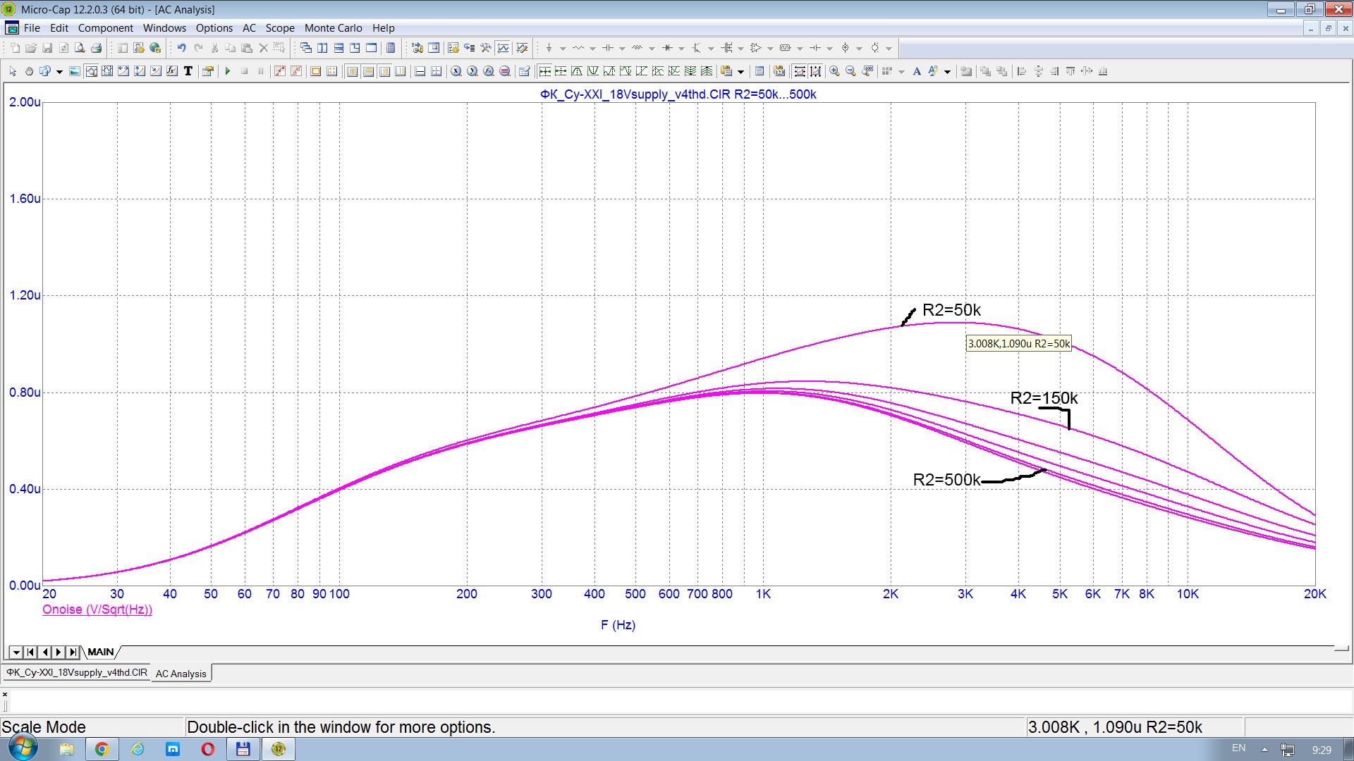

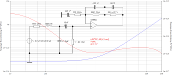

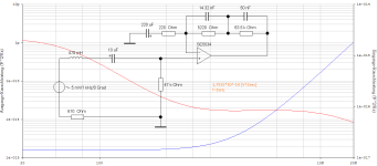

do you want me to multiply 82 by 15 = 1230, 46 by 15 = 690 and prove that 1230 > 690? 🤔 -please, if you can`t 😢 . Also attached is a simulation of my Cy-XXI phonopreamp noise density @ RIAA equalized and IEC-A wtd output with input resistor stepping from 50k "standard", to my passive cooling 150k and Marcel`s active cooling 500k. A 500 mH + 1k cart equivalent @ input attached.
Please just explain what this nonsense here "to my passive cooling 150k" [N. Sukhov] means in plain language?
same as "The 47k load resistor is synthesized to reduce its current-noise contribution" in D.Self MM preamp [ https://www.diyaudio.com/community/threads/can-an-opamp-mm-phono-preamp-be-blamefree.401679/ ] and similar MarcelvdG`s topology, but without using any additional active elements like OPamp or transistors [ https://www.phaedrus-audio.com/electronic_cooling.htm ]. Are you really so "plain" and do not know basics ? 😢
It's pure magic

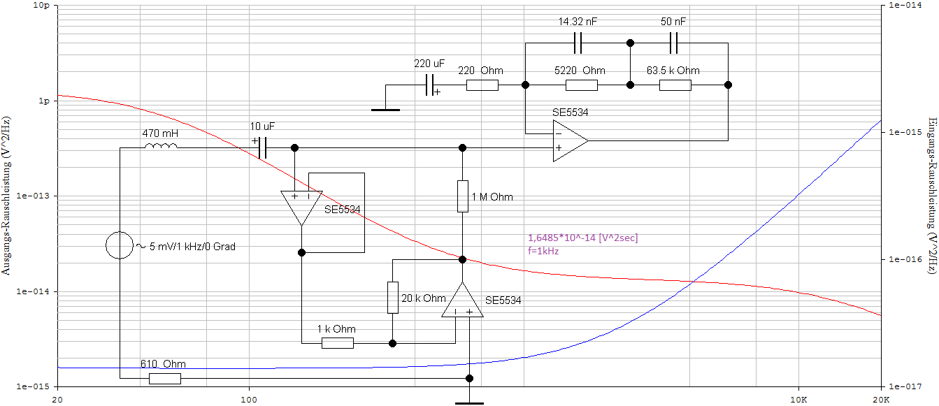

Chapter 7, page 190 to 201, Douglas Self, "small signal audio design"
Let's compare the effect of an active, i.e. dynamically acting, 47k resistor with an equally activated 150k resistor.
Douglas Self himself doesn't like the phrase "active cooling" any more than I do; he speaks of a synthesis.
1M becomes 47k or even 150k.

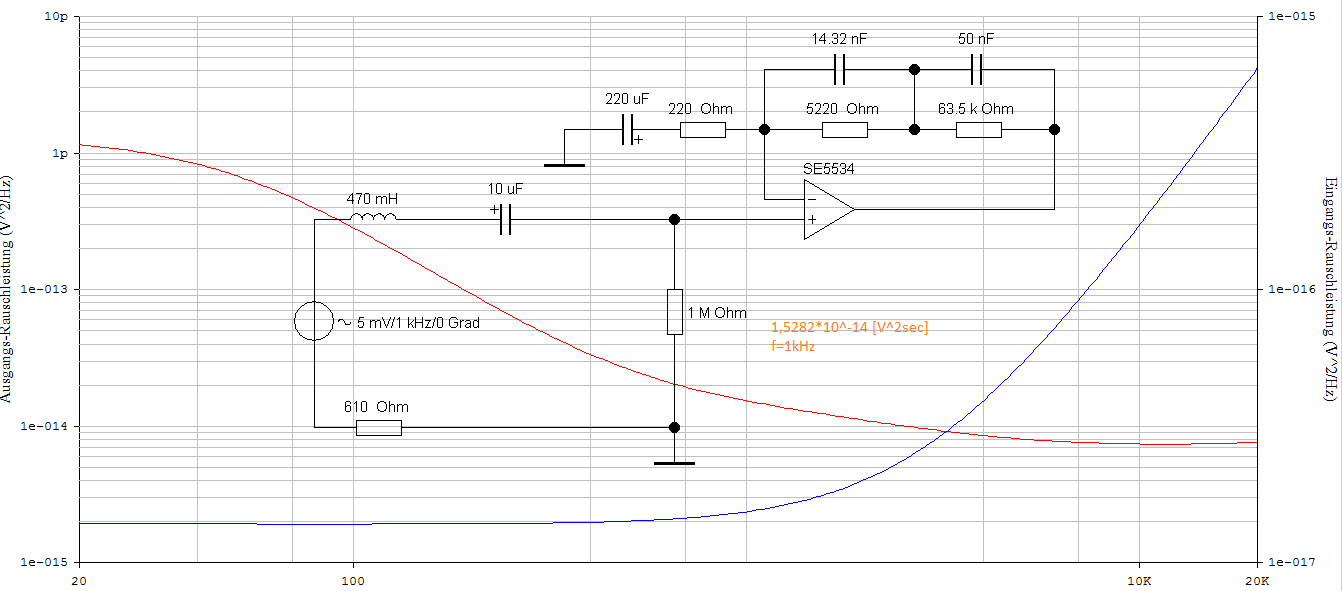

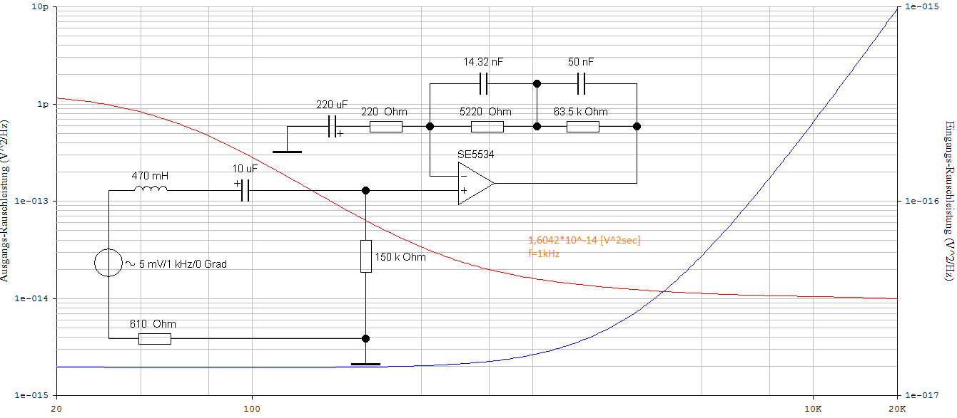

Now we compare your "passiv cooling"
150k (passiv) vs. 150k (activ) corresponds to a benefit of 0,186dB
150k (passiv) vs. 47k (passiv) corresponds to a benefit of 0,479dB
However, we are comparing apples with oranges here, as the resulting transfer functions H(jOmega) are not identical. But, the magic advantage alone is so powerful and so huge that ...

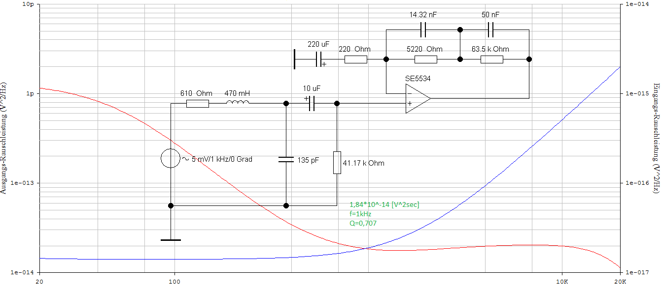

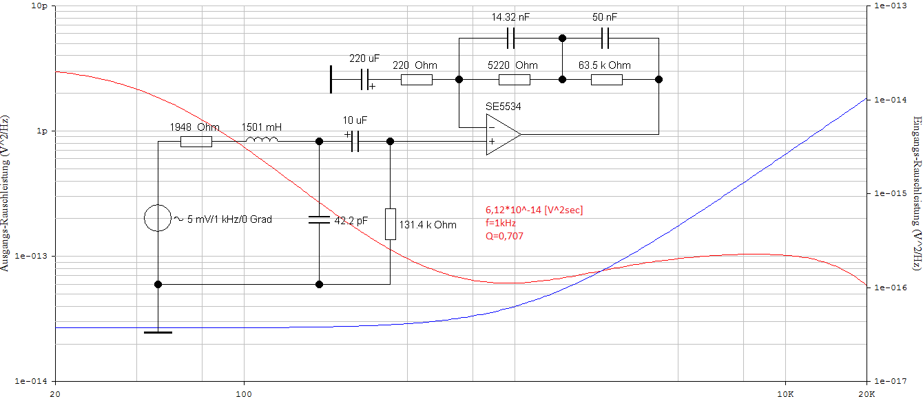

Let's compare one last time an apple called 47k with another apple called 150k, i.e. identical transfer functions of the 2nd order low-pass filter as a source before the EQ preamplifier.
And let's close the case for good. We register a really significant advantage of 5.2dB on the low impedance side.
The winner is:
Apple named 47k.

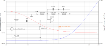

Nick my buddy!
I would very much appreciate it, and I'm sure the readers would too, if you would be honest for once and no longer throw sand in anyone's eyes.
In general,
an MM system should be terminated as specified by the manufacturer. Of course, you can also try to follow your suggestion and postulate it as universally valid - it's magic.
:hug:
Will you accept this peace offering?

Pickup AT91:
L1=0.4H
R1=410Ohm
all values are assumed to be constant, which of course they are not.
A short calculator calculation results in
1)
Rp=47kOhm & Cp=250pF
Q=1,2
fog=16kHz
2)
Rp=150kOhm & Cp=25pF
Q=1,2
fog=50kHz !
