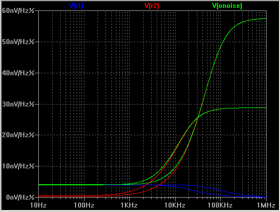

Another plot, this time with 50k vs 200k for simplicity and without capacitor.
The individual contributions of the resistors to the total output noise reveal the inner details.
- At low frequencies the total noise is strictly following the R1//R2 circuit equivalent. The 50k version thus produces a tiny bit less noise than 200k.
- There is a point at 2.3kHz (50k) and 4.5kHz (200k) where cart and load resistors contribute equal amounts.
- Above that point, R2 dominates and 200k gives lower noise (only 2/3rd of 50k version noise @10kHz). This region is the reason why one could say "150k is better".
- At 30kHz and beyond, though, 50k gives lower noise as the cart R's shorting effect is now becoming fully isolated by the inductance and accordingly its noise contribution goes to zero.
- At high frequencies the 200k load produces two times the noise vs 47k as expected.

@MarcelvdG , OK but then for a fully normalized noise spectrum comparison (same final frequency response), we should also correct for the lower gain at higher frequencies with 47k because the pole shifted down. About a 1dB (10%) at 10kHz which increases the advantage for 150k.

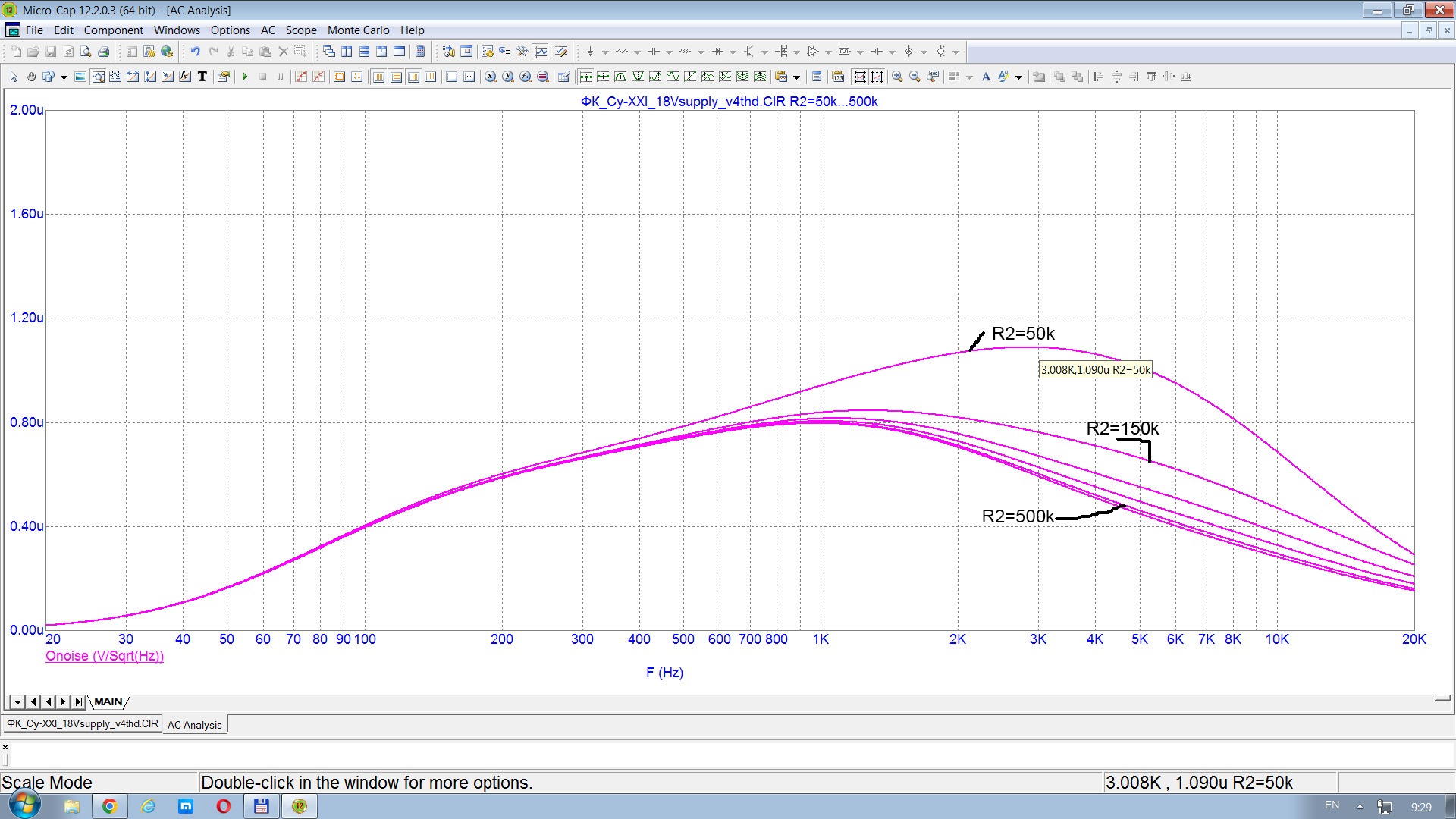

Why? Seems to be reaching. The topic is interesting because it's appropriate to real, actual use (for DIY), which is both RIAA'd and ear weighted. Shifting noise out of band is the basis of modern audio storage schemes.please lay beside all weigthings, and the RIAA-Curve ... only the transducer and Input are of our interest.

Hah. Not really. I didn't think about much at all. I just tried when I saw this, out of curiosity, because it's easy to try when the model is already sitting there.did you think it so?
Though, my result depends on model accuracy which ahas yet to be proven.Though, I have been tweaking it for a while now trying to make it as real as I can.
If it is true the total noise energy cannot be changed but maybe instead can only be manipulated in and out of the audible band, it still seems like it may be a handy tool to understand how to use.
You math gurus tell me what you decide.
