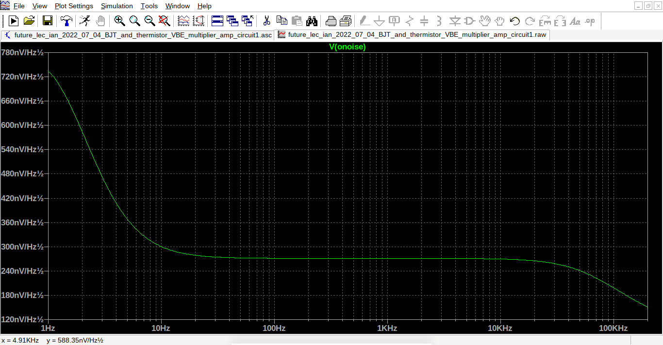

This is the noise analysis for the input voltage and output voltage. I used the LTSpice command
Code:
.noise V(output) V1 dec 100 1 200k
How is the actual noise calculated from this graph?
Comments are appreciated.
Thanks.
