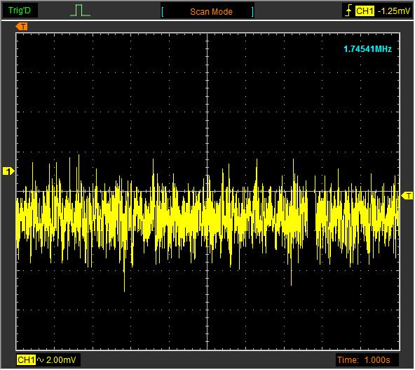

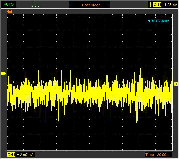

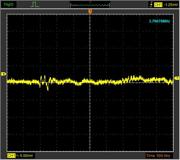

The output will be connected to an oscilloscope (USB type) connected to a laptop while operating with the battery. This avoids noise from the switched mode power supply. The noise shows as periodic ringing superposed on the signal.
The "random noise" from the defective channel has increased substantially and is characteristic of the noise gerated by a bad connection.
Switching off and then on again resulted in less noise.
I am attachment three screenshots from the oscilloscope. Two screenshots show the trace with a time base of 1s and 20s. What is causing these oscillations?
