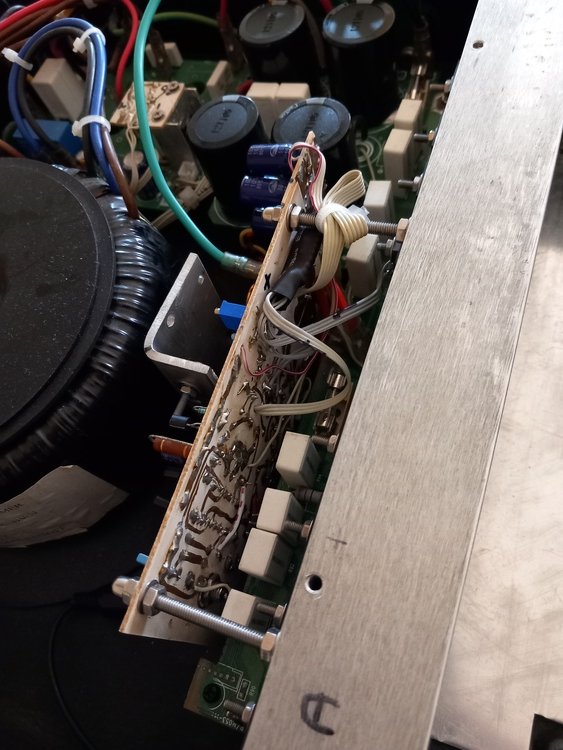

There is one multiturn trimpot per amplifier channel. This is used to set the bias. The variable resistor is a kermet 10 turn pot. Presently, I am using one channel only. I will post pictures when I open the amplifier box.
Thanks goes to all who replied. I am attaching a picture showing the blue multiturn pot.
