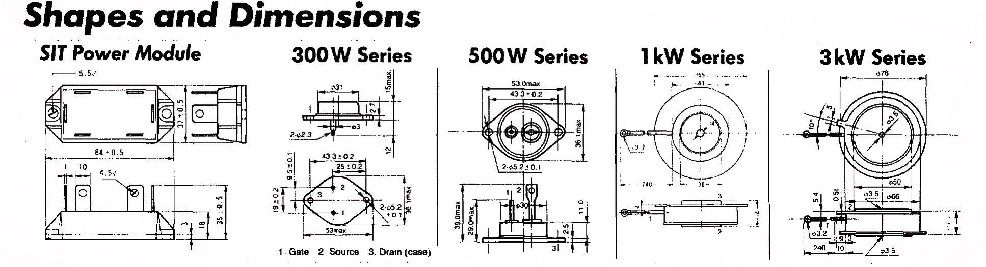

All Tokin packages pin outs
According to this list (AMPLIMOS V-Fet & SIT Amplifiers, One Stage Amplifiers)
Tonkin devices are N-channel only, designed for industrial applications.
