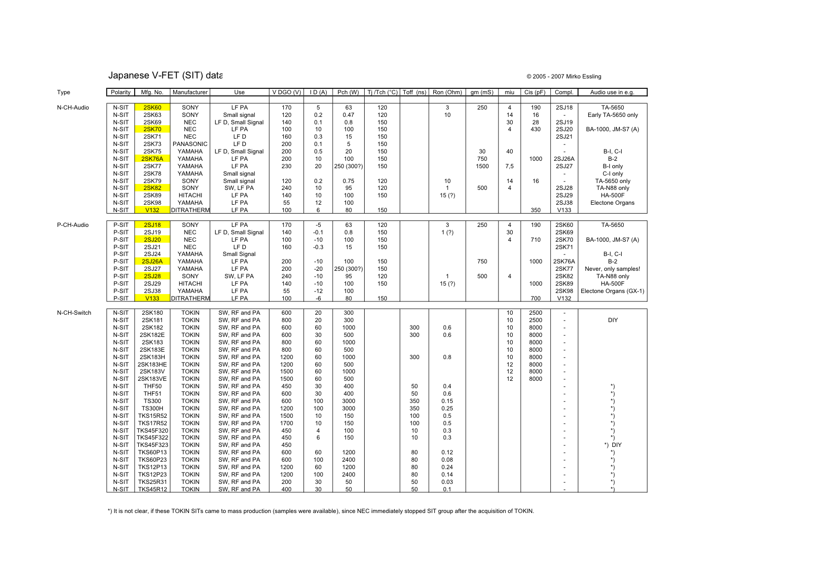

Any clues as to what VFET / SIT types might be around in TO-3 packages other than the Sony parts he has mentioned?
Can be KP926A V-FETs or NEC 2SJ20 and 2SK70 for example
Probably + other Sony Vfet's 2SK60/2SJ18 are included on the list.

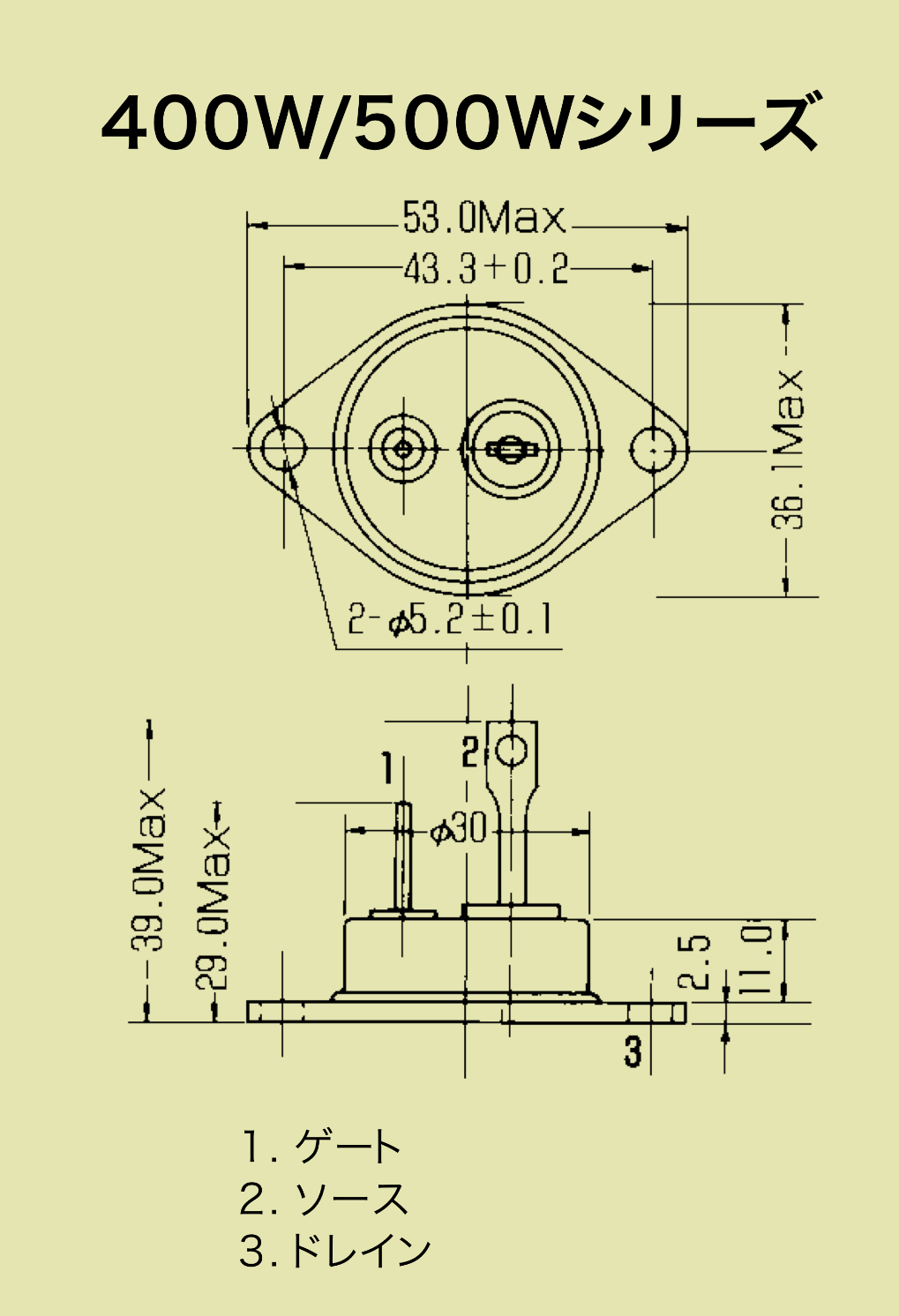

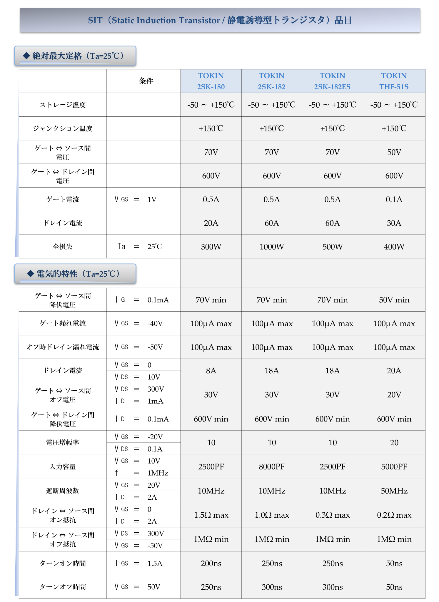

On another point, has anyone got the pinout details for the Tokin THF-51S device or even the datasheet in English. I have found the datasheet for the 2SK180, but the THF-51S and 2SK182ES datasheet is proving elusive, thanks.

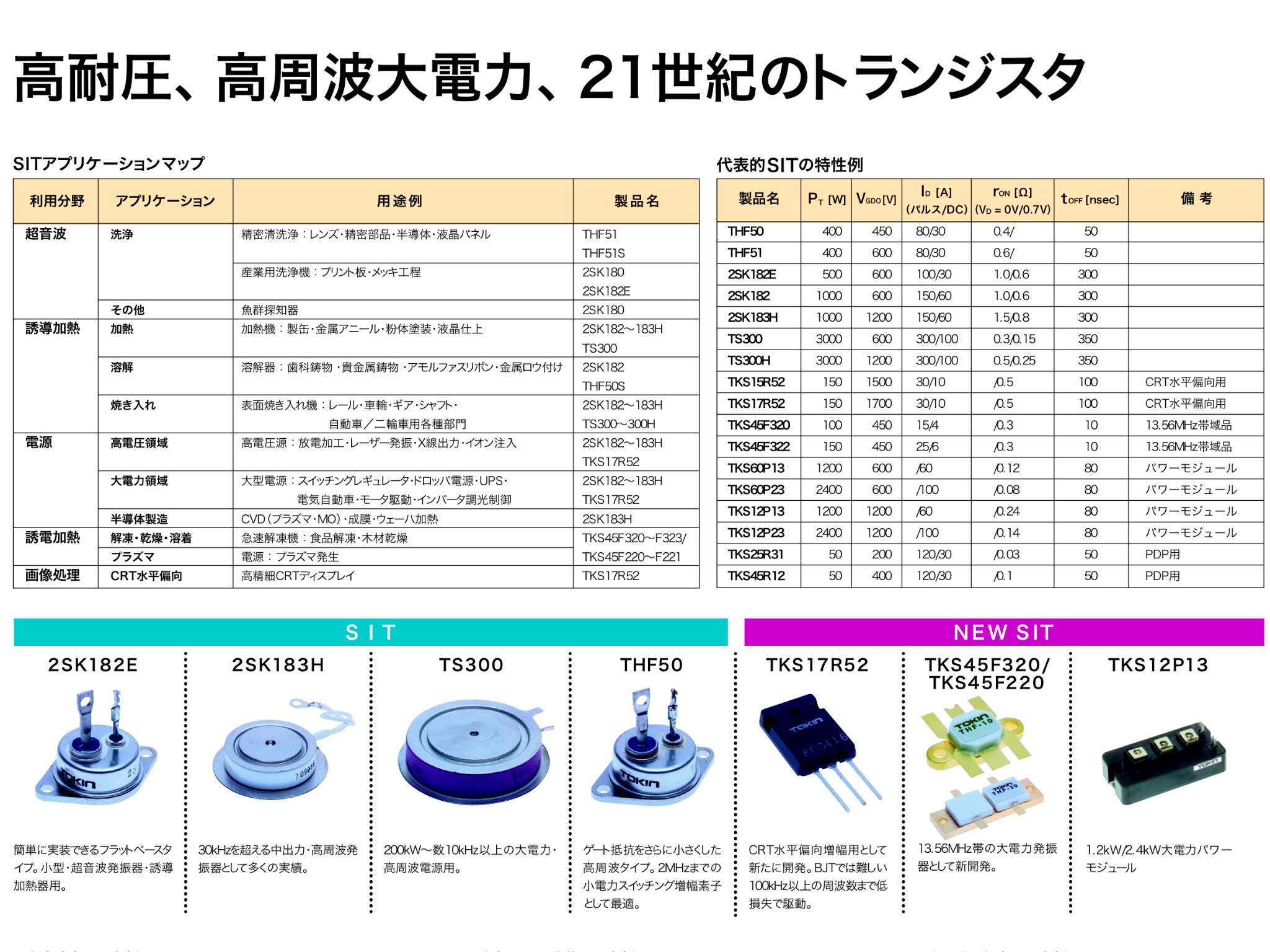

On another point, has anyone got the pinout details for the Tokin THF-51S device or even the datasheet in English. I have found the datasheet for the 2SK180 and 2SK182ES, but the THF-51S datasheet is proving elusive, thanks.
I found this with a search
RoeTest - das Computer-Röhren-Messgerät - professional tube-testing-system (c) Helmut Weigl Röhrenprüfgerät Röhrenmessgerät RoeTest
SIT – Static Induction Transistor
http://www.roehrentest.de/SIT_EN.pdf
