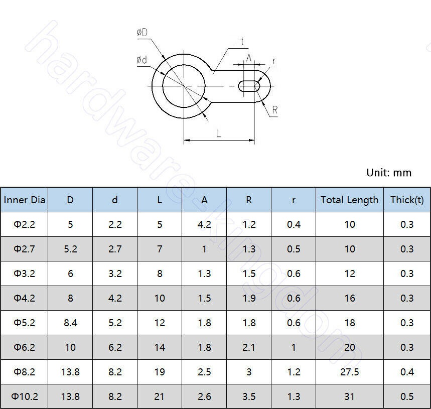

Brass Welding Washers Terminal Welding Tin-Plated Gasket M2.2 2.7 3.2 4.2 - 8.2 | eBay

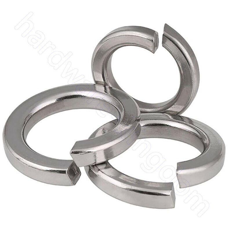

Spring Washers A4 A2 Stainless Lock Washer M1.6 M2 M2.5 M3 M4 M5 M6 M8 M10-M30 | eBay

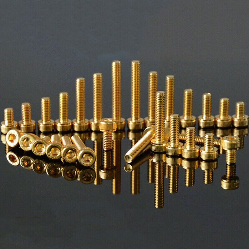

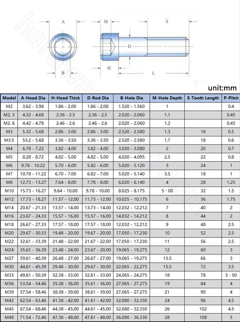

12.9 Cap Head Socket Screw Allen Key Bolts Screws Gold Metric M2 M2.5 M3 M4 M5 | eBay
