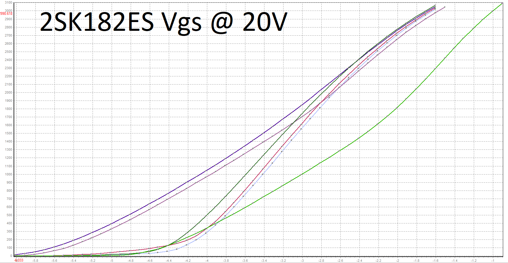

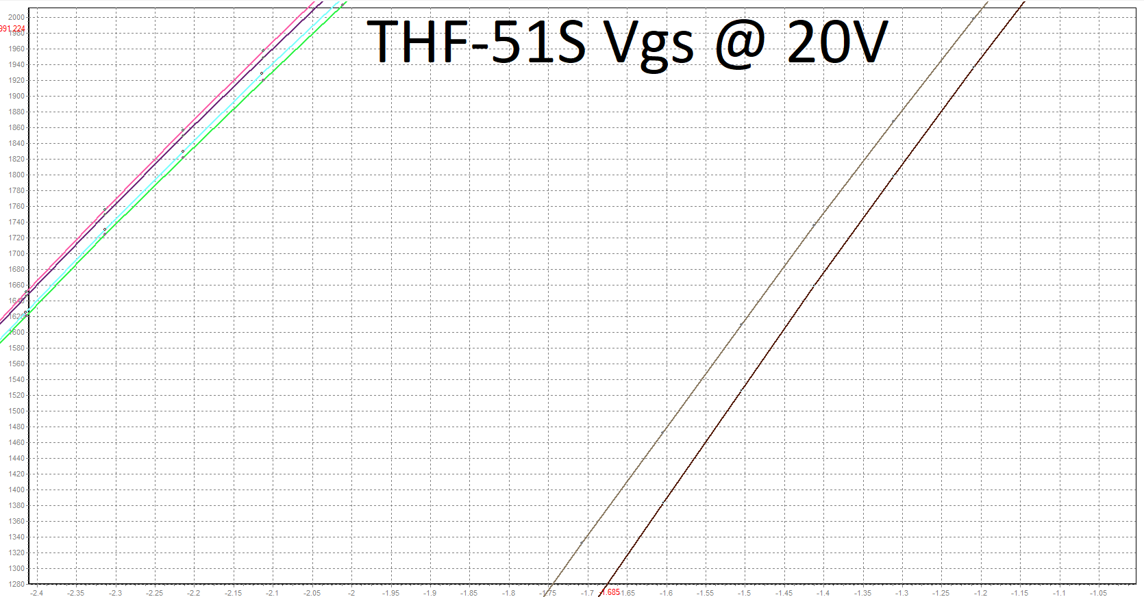

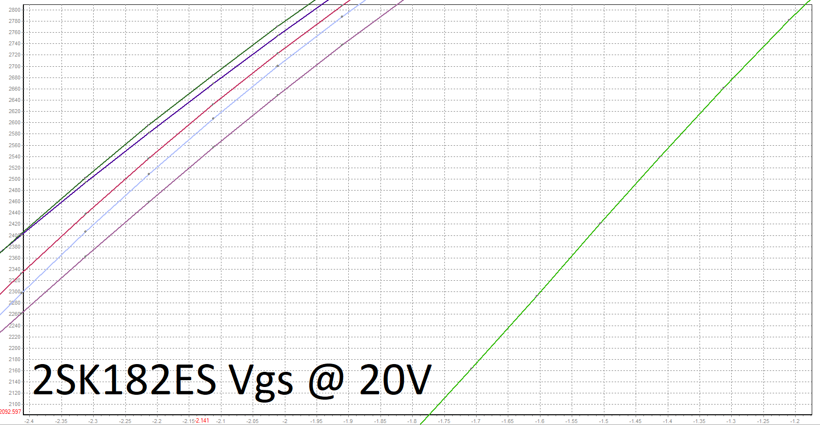

Hello Folks,
I Vgs Curve Traced my TOKINs and they aren’t too bad, I didn’t order them matched, Mr. Tomo didn’t even had that option when I ordered them.
Here are the graphics for those that enjoy pictures...
Graphic one shows us Vgs for 6 THF-51S, 4 of them are practically identical across the full measured range, then you have other 2 on the right hand that are far away but hopefully close enough to create a matched pair if needed.
The second graphic shows a closer view of the same THF-51S only from 1280mA to 2000mA.
On the third image we can see 6 of the 2SK182ES, they are not as consistent nor as close as the THF-51S but I hope they’re good enough if some matching would be necessary, in this case 5 are similarly behaved above 2000mA and 1 problem child is far away from the rest.

Finally on the fifth graphic there’s another closer look of the 2SK182ES but this time at a higher current range from 2000mA to 2800mA which shows that they behave more consistently at higher current.

Are their serial numbers close? They could be from the same box and their silicon from the same wafer.
I am contemplating a couple of projects using them..All three part types are usable and most applications
would not require matching.
For good sleep you can build excellent amp with not matched pairs 🙂
