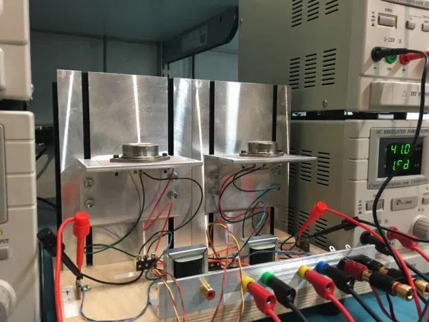

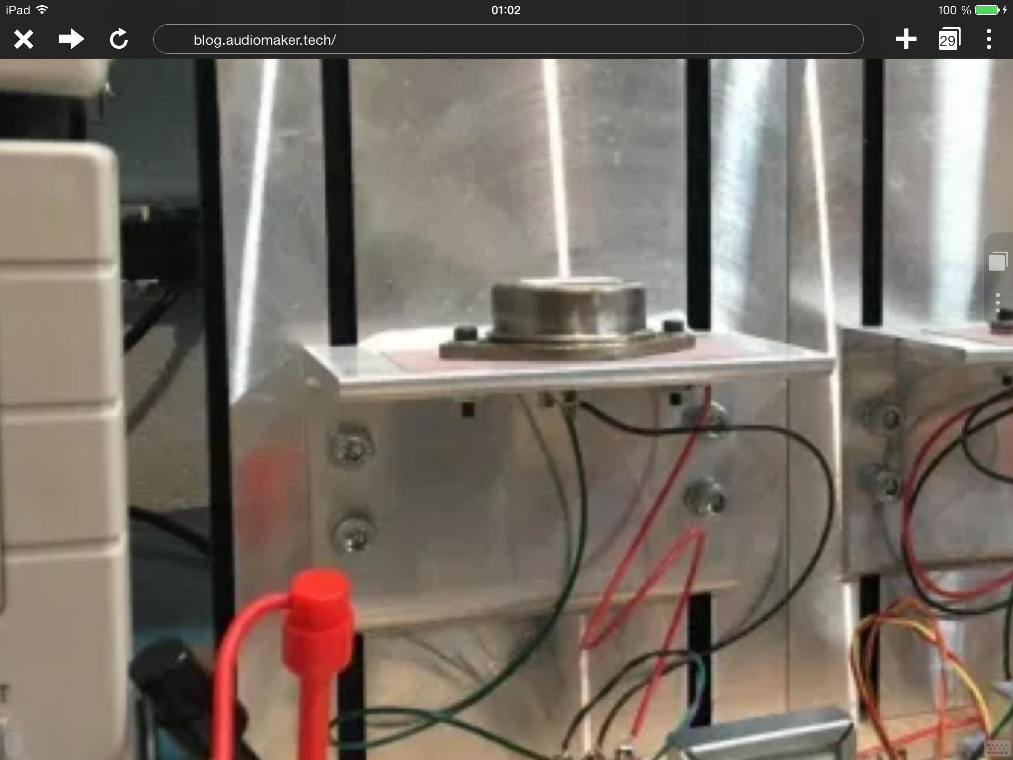

I will use custom made alumina ceramic pads that vodomore brought to our attention several pages ago. They would surely shatter under very high pressure. As many Tokin SITs are happily working in the various DIY amplifiers that is confirmation enough that any pad + some thermal paste is OK, as SIT has big surface for heat transfer
I revised my initial thought, that wouldn't be good if I use enough torque which flattens the surface of SITs.
I'm afraid, it can cause damage to silicon in the case of SITs, or even it peel off from the base, as it flattens.
Any toughts on it?
I'm thinking it would depend on the extremity of the convexity. Have you measured it? I haven't but in my case if there's any it's so small I'm not worried about it.
Maybe I'm worrying too mutch.
The big gap if I screw up two Tokins together, is about 0.5 mm at the screwholes. If I measure gap perpendicular to the SITs longer side, it is decreases in a short way below 0.05 mm.
It is quite interesting at the same time, if I try to measure at the shorter side, I almost able to put through 0.05mm gap meter.
So this side is concave a littlebit.
I think, Soundhappy is right, when he recommend Kerafoil.
Mica too hard in this case, while Kerafoil 0.25 will be able to fill the gap.
Yet, it would be nice, if we know the recommended torque settings.

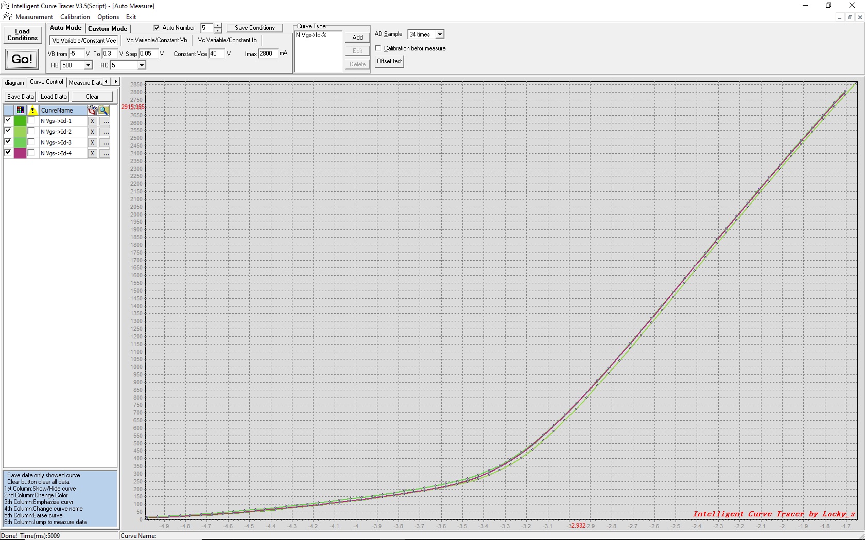

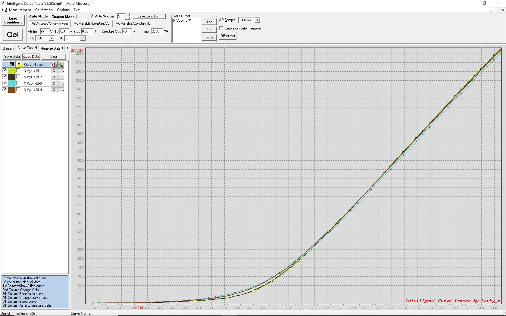

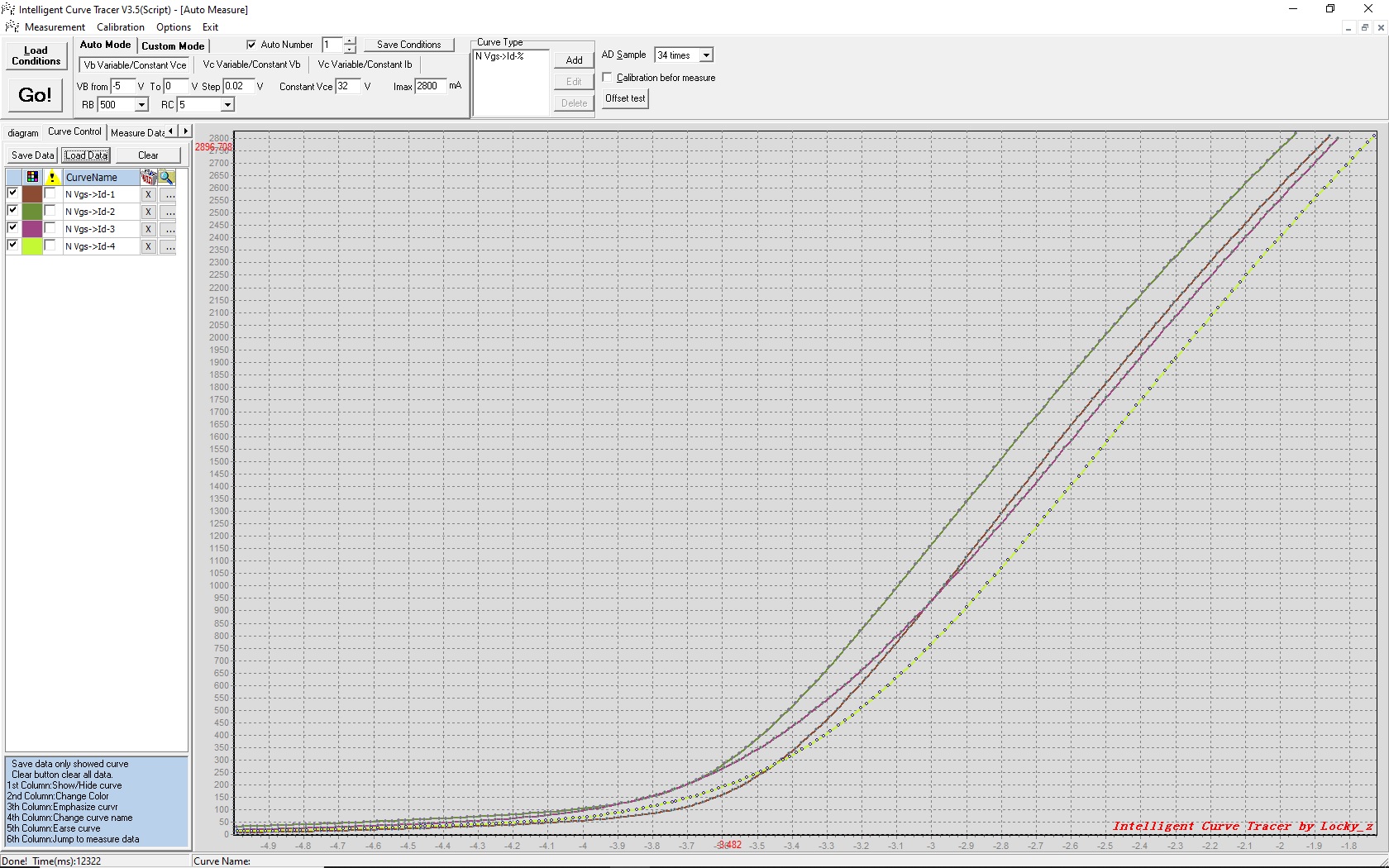

Curve traced my SITs.
First pic, THF-51S matched quad, with papers.
Second pic, THF-51S roughly matched quads.
Third pic, 2SK180 roughly matched quads.
Fourth pic, first and second on one pic.

Excuse my ignorance, but I am not an engineer and I have skimmed through the whole of this thread and perhaps I have missed it, but will it be better to buy a matched pair of the THF-51S or the 2SK180 from watanabetomoaki to potentially participate in this build once it is released?
