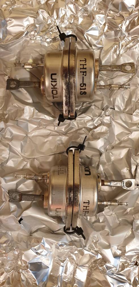

"The reason behind using two types of isolation foil with different hardness coefficients
A softer isolation foil may leave a gap between the back of the device and the heatsink if too much force was concentrated on the screw hole of the device. As for a harder isolation foil, the force on the screw hole is evenly distributed over the surface of the foil due to stiffer characteristics. Therefore there would not be a gap between the back of the device and the heatsink." (See picture page 7).
The packages (Tokin Sits) we are using are fixed using two diametrically opposite screws on a thick device base, there is very little scope for the surface to be lop sided on softer pads as long as the screws are tightened evenly to the same final approximate torque. Also remember these are devices which can conduct 300 or 400 watts, we will be using them (even brave DIY'ers) at much lower ratings.
Para3
True, but they are still underrated as their max rating temp is 150 degrees C and most will run them at around 50 to 55. As I understand it, 300w or 400w is roughly what can be thermally conducted/dissipated across the joint interface. For instance when the device is at max power and the heatsink at 25 degrees. Otherwise thermal runaway would occur.
I believe the 150C is the maximum junction temperature, which is higher than the case temperature, which is higher than the heat sink temperature.
The maximum dissipation that I have seen that is commonly recommended is 1/4 of maximum dissipation at 25C, although some push that limit. It depends on the quality of the device to heat sink interface, the amount of heat sinking, ventilation, etc.
I'm sure that you are correct as to when the device is used. The spec also states that storage temp range is Minus 50c to Plus 150c. This would mean that the whole device would have been soaked at that temp for long durations. It's all of little meaning at the end of the day in such a low stressed application.
(Where one stores a product at 150 degrees C, I don't know!)
It sounds a little like Goldilocks, not too soft and not too tight make sure to torque it just right. Anybody have an idea what "Therefore a typical screw tightening torque value of 0.8Nm was recommended." translates to in the real world?

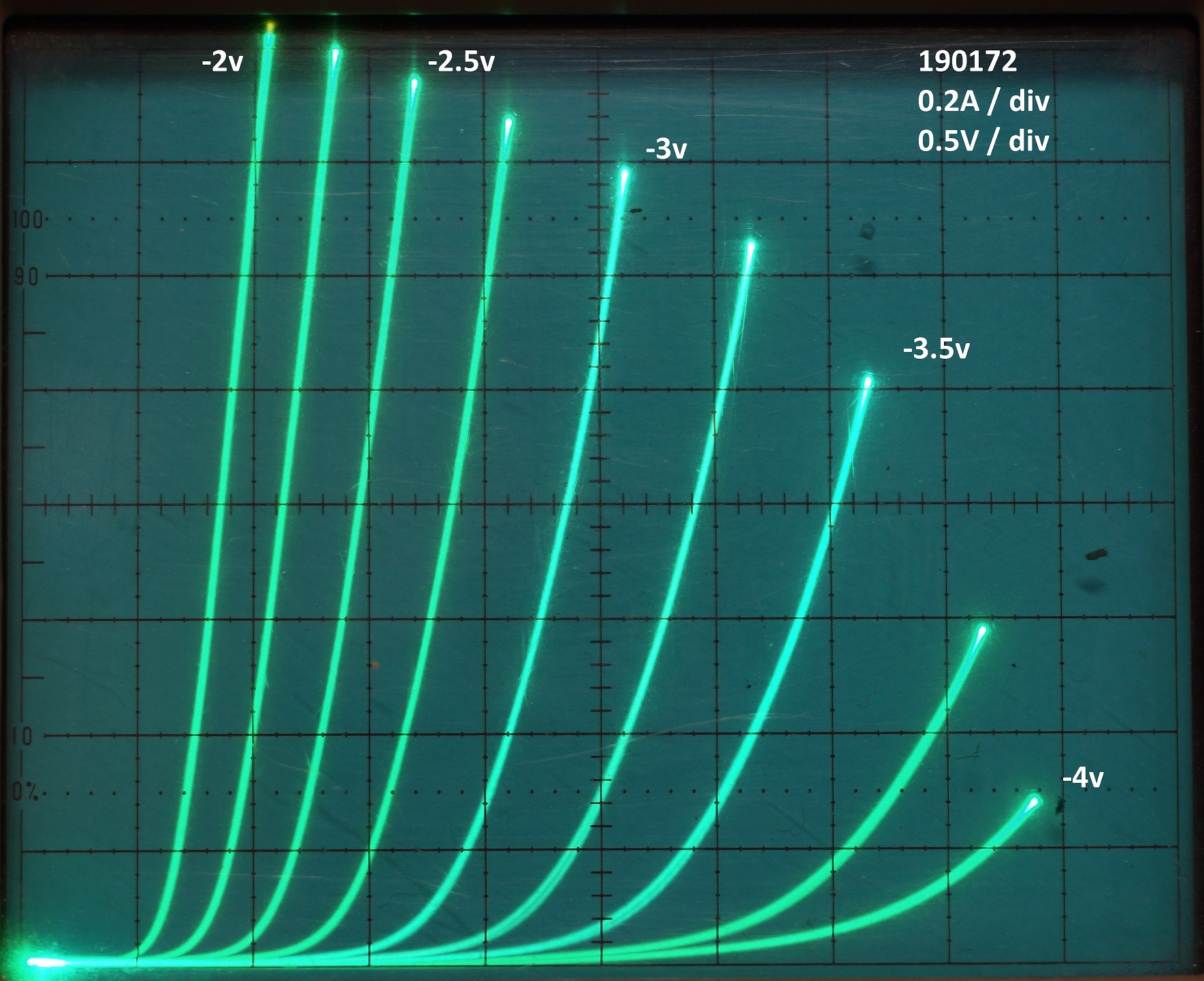

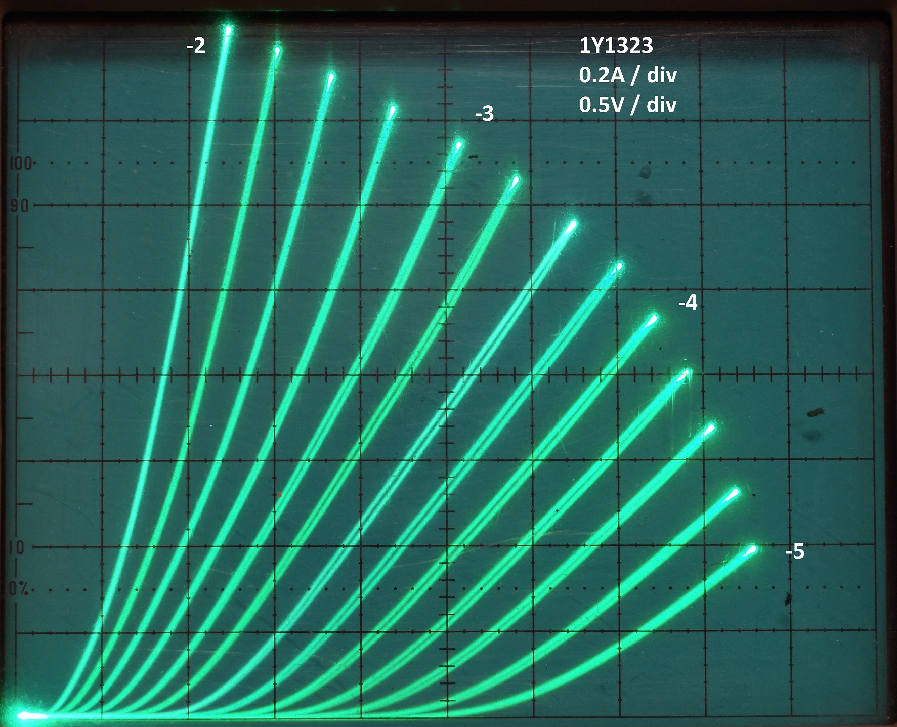

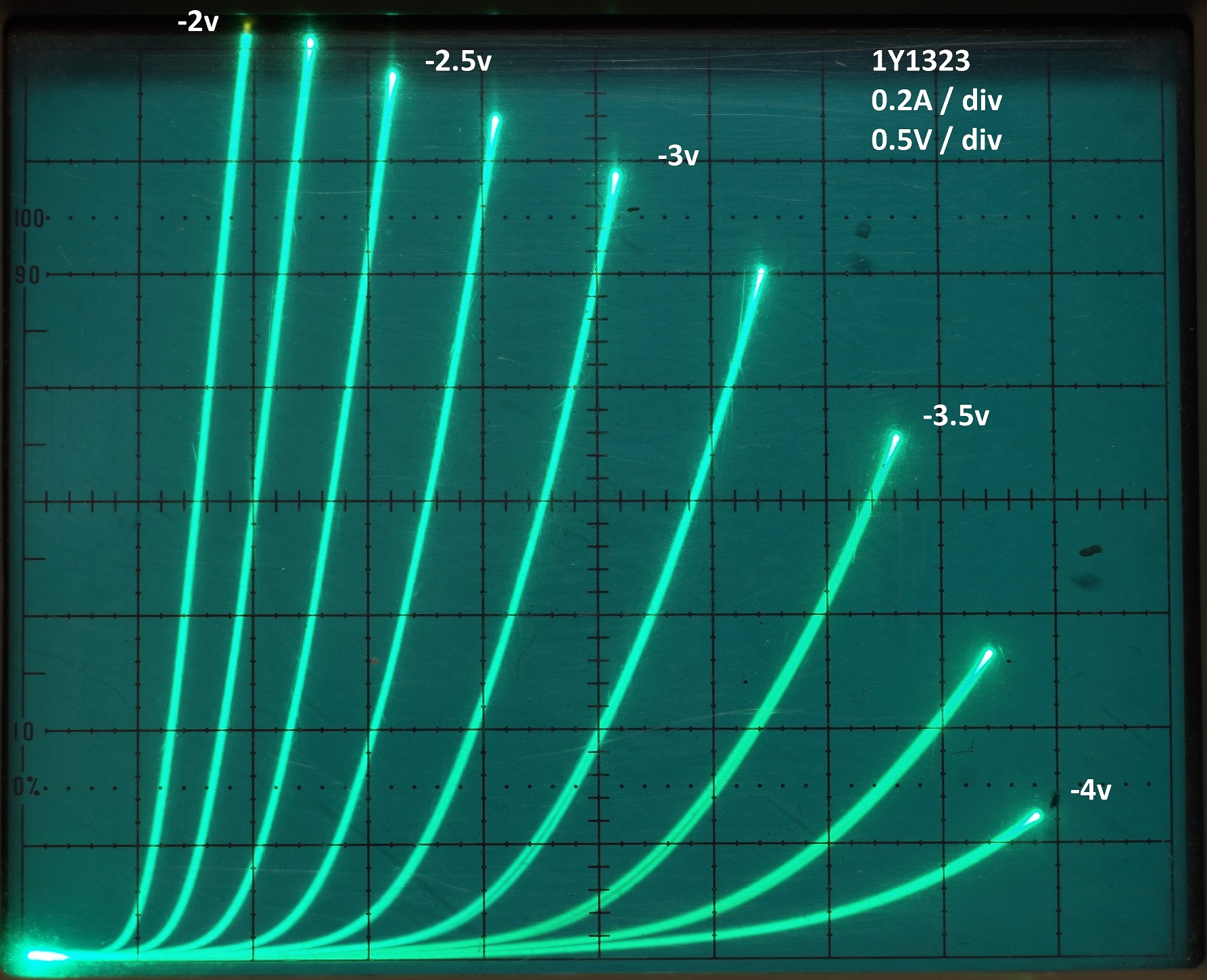

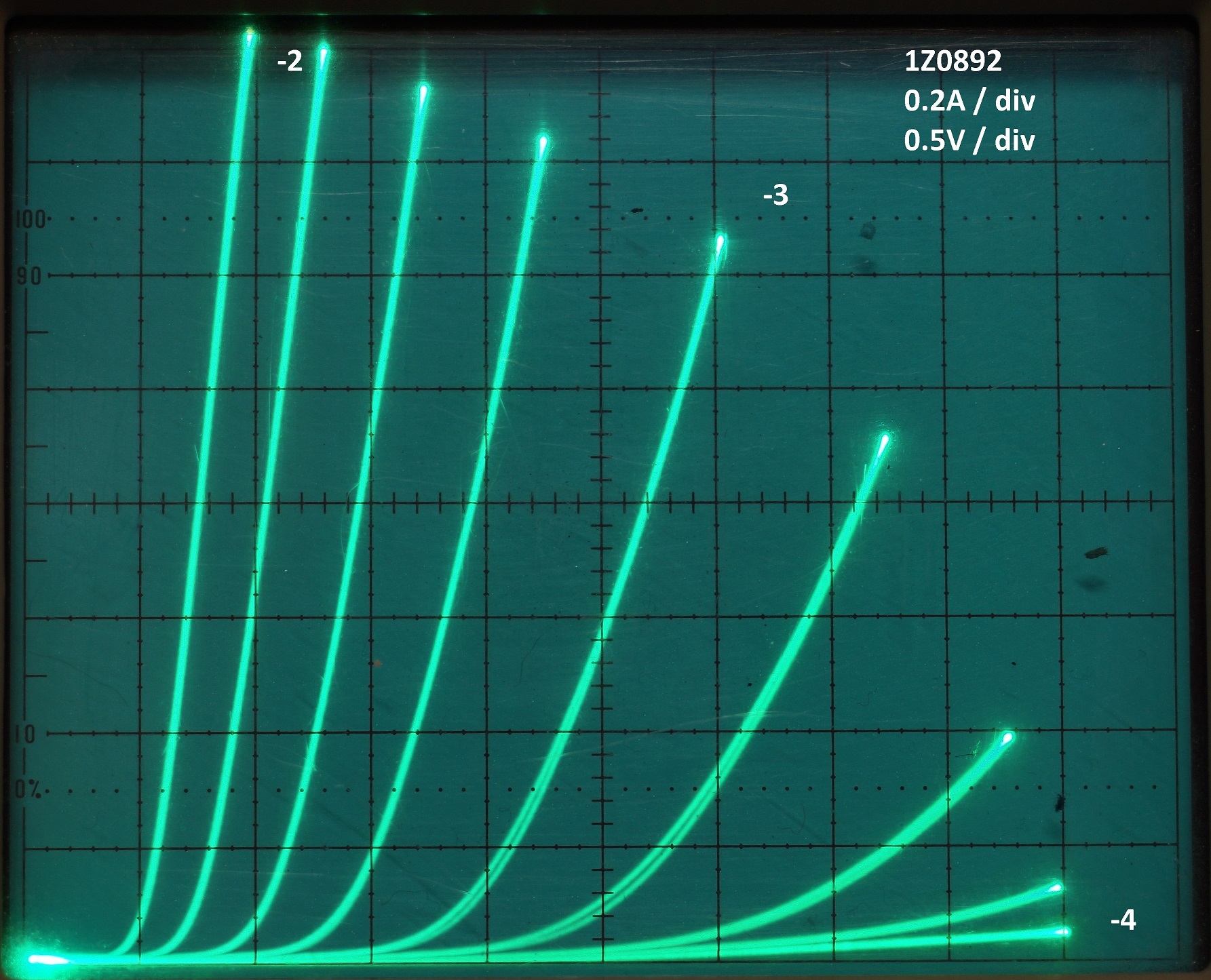

I have finally manage to assemble a Frankentracer from Michael Rothacher to trace my 2sk182es. I have 4 of them bought from pras. They were vgs matched.
1Y1323 and 190172 were labeled by Pras as 24v 2A=2.86v and 2.88v respectively
1Y3323 and 1Z0892 were labeled at 2.7v. Voltage and amp not specified so i guess 24v 2A.
Curves were traced at 0.25v interval. As we can see the first pair are close when we compare curves. Second are totally different.
Is that what mr. Pass ment when he say out of the pack curve wise? What do you guys think? Will it be possible to do something with that pair?
Could just be due to some extra gate leakage stealing some input voltage, looking at the looping. What are you using to drive the step voltage? Low impedance?
You can always just try that one in a follower. 🙂
Here’s my setup. 24v 2A transformer connected to the variac. Exactly as per your schematic. Is that low impedance ?
