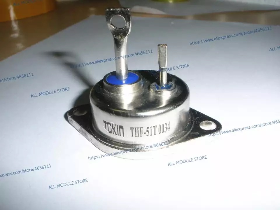

Obviously from a dodgy seller on Aliexpress.
The printing is totally different to the originals.
Gate connection is also not like the originals.
Nice pic Alex! Where'd you pick up that one?
In AliExpress, there’s the store name and url on the photo.
It has only 1 sale and the buyer reported it as fake...
There are 10 stores listed on that site that sell these SIT's - 2 look genuine and 8 are obviously dubious to say the least.
