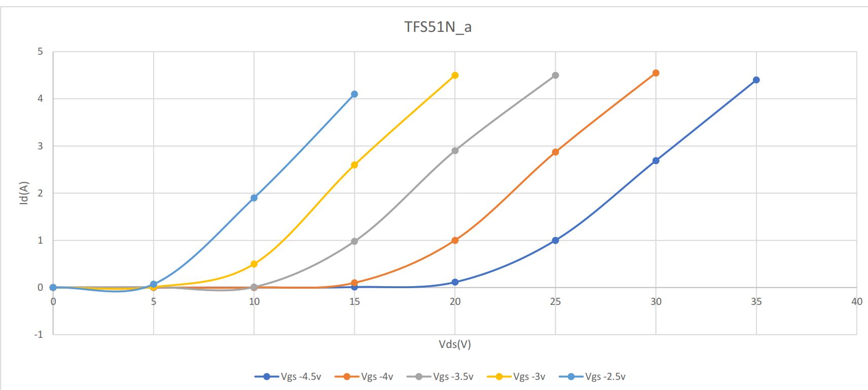

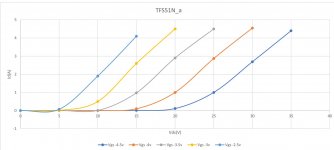

Tested some Ns today. Seems like they have roughly double the transconductance of the S. Will have to do some more testing, but these devices are definitely different.
