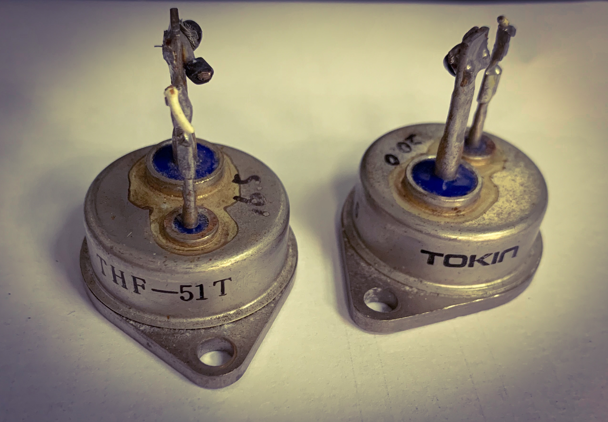

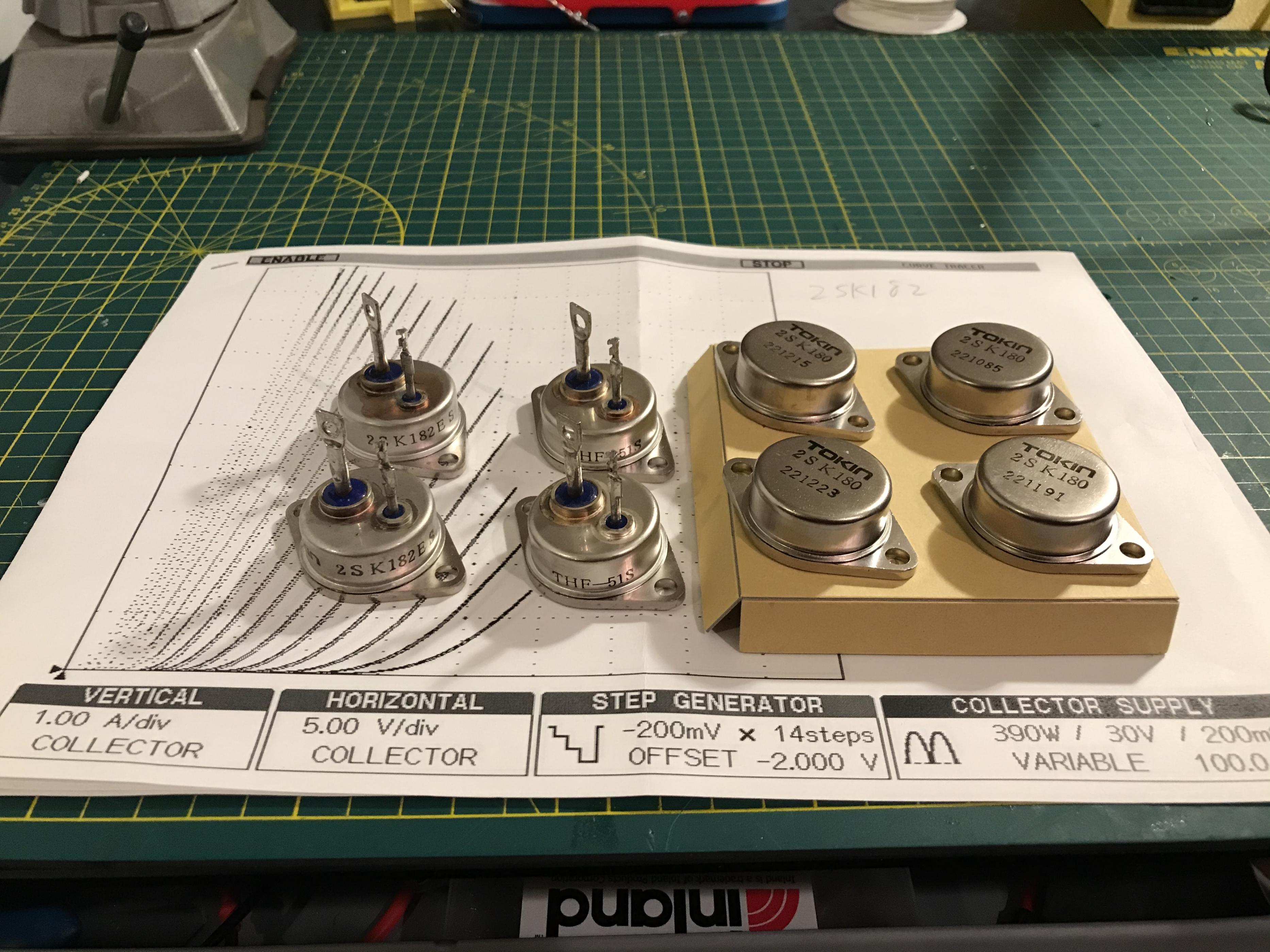

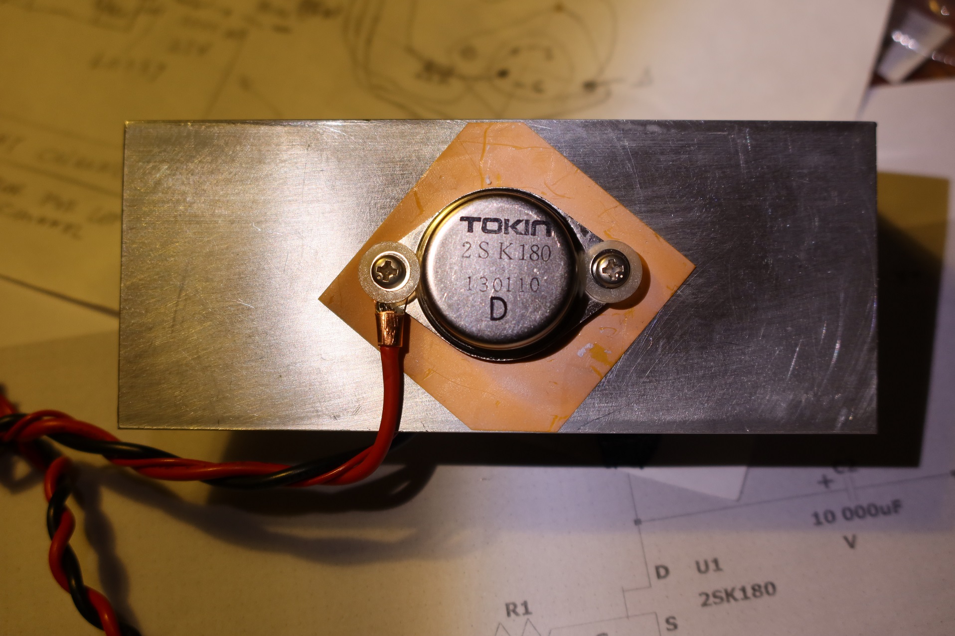

One question for the experts here, when using the THF-51S or 2SK182ES devices,and taking into account the likely power dissipation of any designs - how does one securely attach the device to the heat sink - obviously using an insulating washer and insulating bushes for the 2 mounting screws so that the screws are electrically insulated from the case (drain connection) when screwed into the heat sink. Then how does one get the electrical drain connection form the case wired to the amp circuit.
I don't see how the mounting screw which is connected to the heat sink but isolated from the case by insulation bushes, can then also be the electrical connection.
What is the correct way to use these can I ask? Maybe I am missing the obvious.
Possibly the most amps with these were built as SissySIT or maybe by now there are more 50W versions like the Singing Bush and cousins ...
Anyway, see post #494 in SissySIT thread and you see the screw is electrically isolated from the SIT but you can attach an eyelet or other connection UNDERNEATH the bushing so it makes contact with the body
