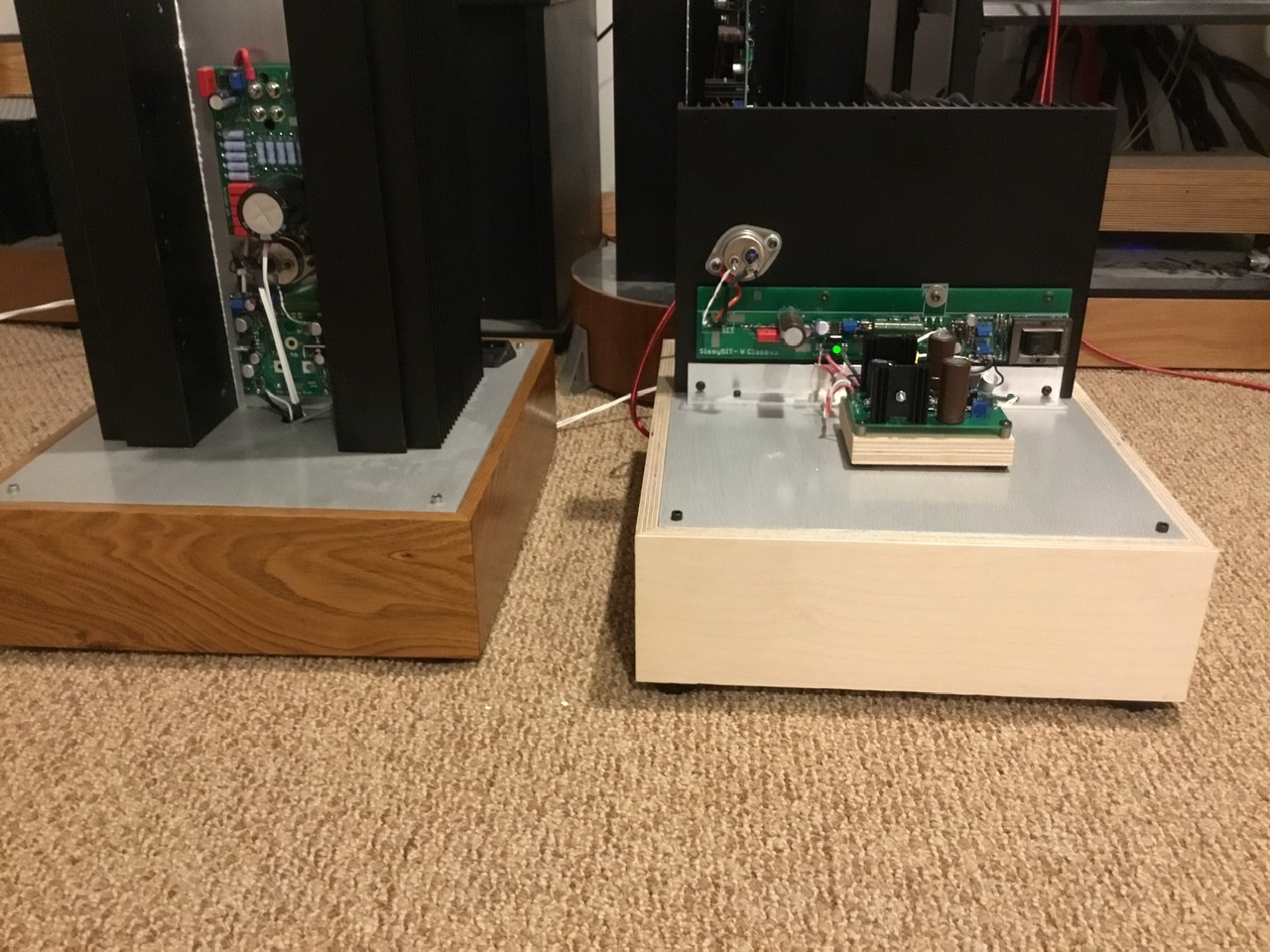

Hi Bob,
Yes I’m loving the SissySIT with the VFet part 2 driver. I did a new layout for the driver, you can see it in the picture.
IMHO the SissySIT follower is Crazy good!

Hi Bob,
Now I see it !!! Great job

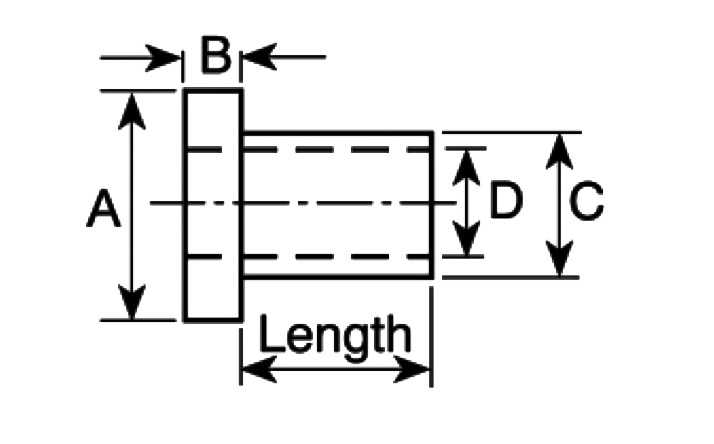

Thinking ahead a little bit I sifted through a 117 page AAVID pdf to find the correct Polyphenylene Sulfide (PPS) shoulder washer for a TO-3.
Looked up the part number at both Mouser and Digikey only to find it's listed but non-stocked at both places with a lead time of 12 weeks at Mouser.
So I'm at plan B unless someone comes up with an easier or cheaper solution or has the proper part bookmarked and ready to go. McMaster-Carr has these washers that are rated at the same 500 degree F temp as the PPS version.
McMaster-Carr
They're for a #6 screw and have a sleeve OD of 0.187 that converts to 3/16" which is the mounting hole diameter that I roughly measured on my 2SK182ES.
McMaster-Carr
Like this? RS PRO Nylon Screw Insulator, M4, 9mm | RS Components
I had to buy the length that was available and then cut to size

Nope.Like this? RS PRO Nylon Screw Insulator, M4, 9mm | RS Components
The important is right diameter C = 5mm = 0.196" see on the picture.
More lenght is a good thing, yes cut to size 🙂 Best regards
