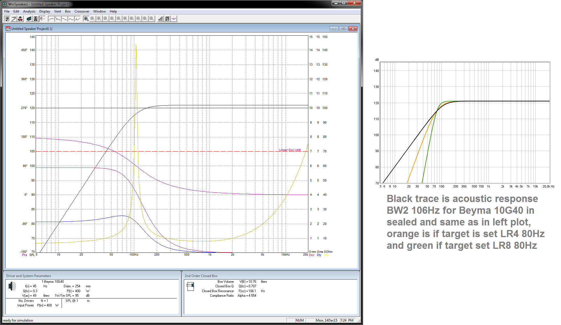

First screenshot is the 10G40 in UniBox at 150W, minimal stuffing, and a 10.3 liter box represents Qtc=0.71. In line with Derek's calculations.
I'm thinking heavier filling to minimize reflections from the box and back out through the driver, so the second screenshot is set for "walls covered" and a 9.4 liter box represents Qtc=0.71.
I model one driver because I'm planning a sealed enclosure for each driver. But I'm also planning for two drivers per side, so then I modeled two drivers in paralel in an 18.8 liter enclosure, at Qtc=0.71. That's the third screenshot.
The amp on hand is a Hypex UcD400, rated at 400W, but I believe it has clean output up to 300W so that's my upper limit for the purpose of my calculations. The amp will only drive the 10G40s, in parallel. Hence in UniBox I use 150W to each driver.
The chart displays frequency response of the two drivers in an 18.8 liter box, driven at 150W per driver. It shows at 80Hz and 150W per driver these would reach 114dB SPL. I envision DSP triming everything above the 80Hz point so SPL would look flat and the maximum achievable SPL would be 114dB.
I usually listen at 80-85dB SPL,sometimes going to 90dB, and rarely above that. Seems 114dB would be plenty of headroom. BTW, at 114dB at 80Hz each driver is displacing 4mm vs 7mm Xmax.
At least those are my thoughts! What do you think?

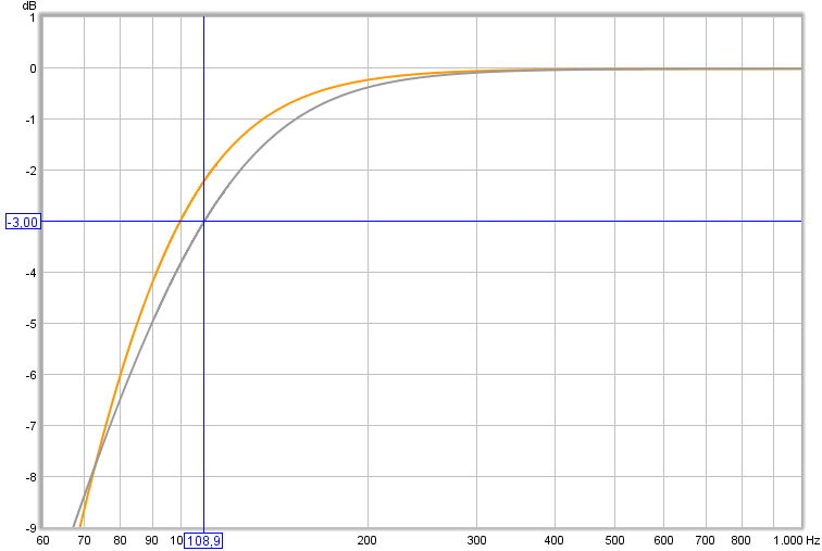

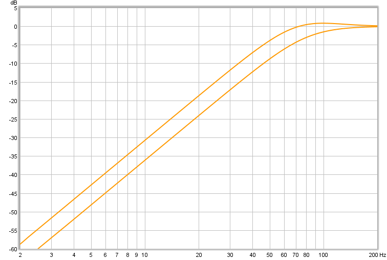

For electric domain here some visuals how many dB needed for Linkwitz transform 109Hz BW2 to 80Hz BW2, and also when cascaded a HP BW2 80Hz.
Last plot show acoustic domain.

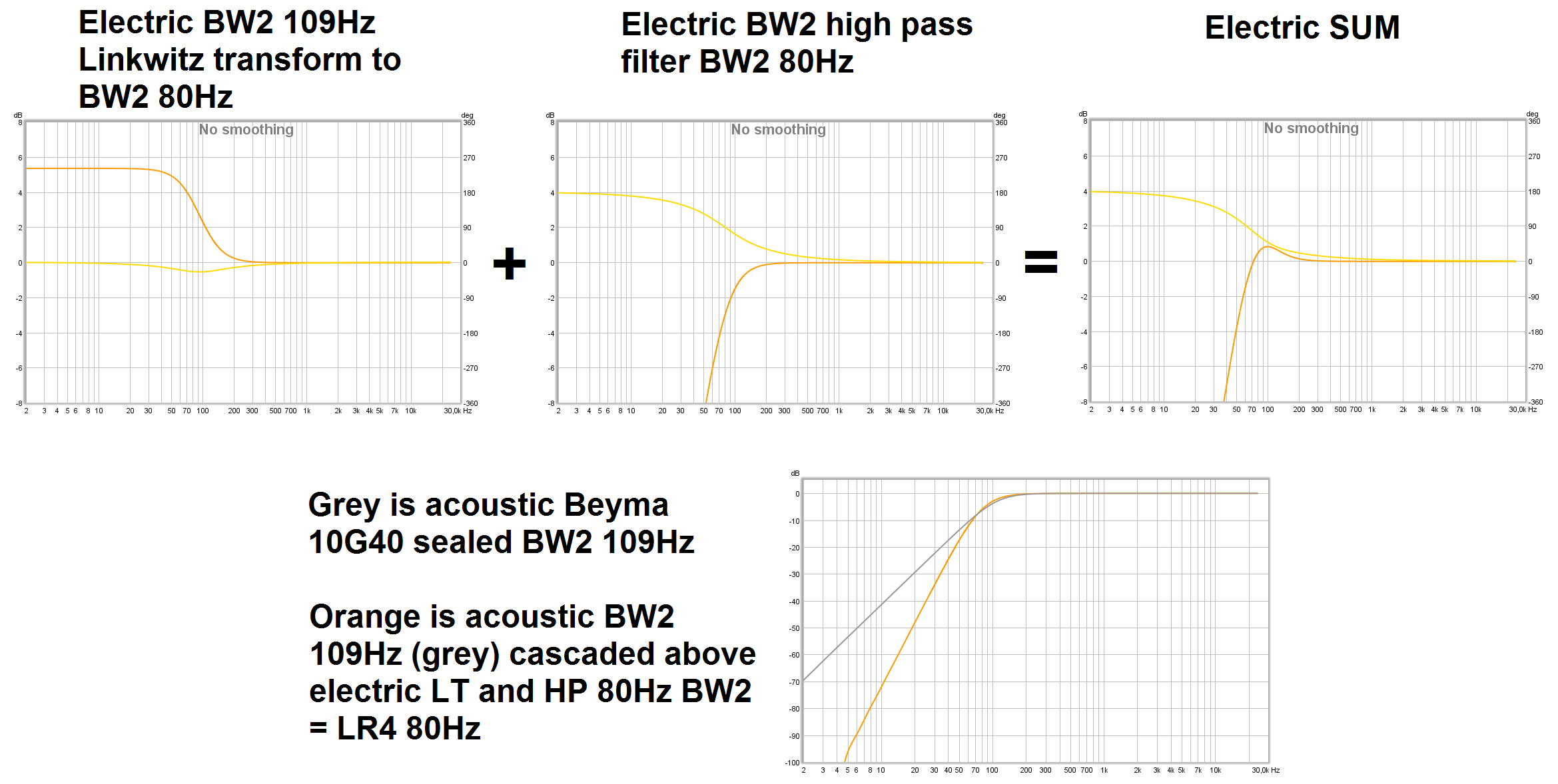

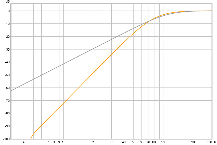

So its only 1 dB, great post Brytt!
Thanks and yes only about 1dB even LT boost is over 5dB approaching to DC but then HP BW2 80 seems save situation a lot.
Picture 1 is zoomed scale of acoustic plot from previous post, driver slope 109Hz BW2 at -3dB and system slope 80Hz LR4 at -6dB. Boost from LT stops around -7,8dB then electric 80Hz BW2 filter takes over as seen picture 2.
Picture 3 is to show electric signal routed to driver had it been inherent acoustic 80Hz BW2 verse the one that in same 80Hz BW2 HP filter also transform 109Hz Q.7071 to 80Hz Q.7071.
Should any be interested plots are created at 16bit/48kHz by pointing REW to output to JRiver's virtual soundcard then all the filters one can set inside JRiver DSP engine plots nice into REW.

Brytt,
Thank you for taking the time to do this! I'm a bit embarrassed to admit I don't know enough to interpret what these mean...
Am I right to understand you are modelling how a sealed box + an electric circuit for a Linkwitz Transform + another circuit for a a 2nd order Butterworth crossover? If this was so, how would it be different if I used the sealed box + DSP to trim so to keep it flat above 80Hz?

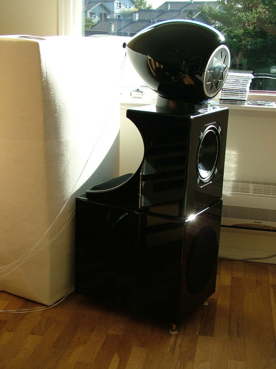

I used to use twin Volt 2500.4 with 54g Mms and 15.5 Bl giving a slightly "slower" driver ratio of 3.48. They were sweet sounding in sealed box, also great in open baffle, see attached....But thats all in the past now!
Cheers
Derek.
Brytt,
Thanks again!
Welcome but no need to be embarrassed, maybe get back later and see if i can explain in logic way why we pointed to exact those filters, but in short as you write can't i just trim with DSP, and in principle yes.
Below add a sim from another program to yours and Overkill Audio's sealed box sims for 10G40. At 400 watt input excursion is not at max yet and wow it can play loud and you plan 2 per side, also there is a 1/4 wave rule that say if ctc spacing is at 1/4 wave length or below drivers would radiate as one and offer 3dB more, so for example if your ctc spacing is 350mm then all frq from 245Hz and down will get a boost and radiate as one driver. Because i show LR8 80Hz target below is because if you have FIR power to repair 720º phase turn that eight order filter distort, one can get less stress on driver at very lows and in XO region outside design/listening axis one loose power response because of ctc spacing and comb filtering, therefor if one go steeper filter XO region get more narrow and thereby a less area to loose power response into room. A word regarding spl myself enjoy a 90dB 10" woofer together a 87dB 3" full ranger into 25 sq meters and don't miss volume : )

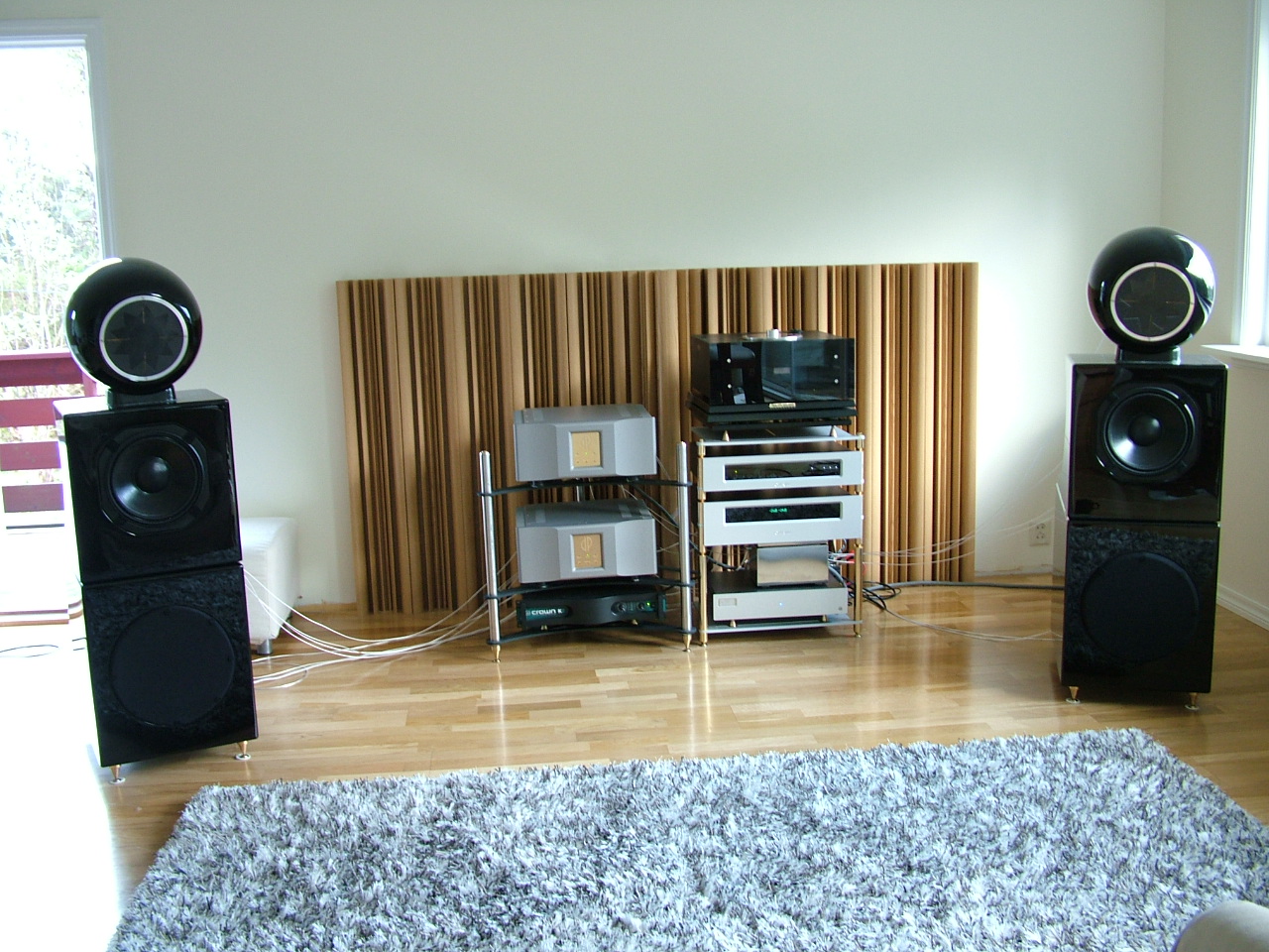

One idea to help with the CTC issue is;
(1) Cut a slightly longer and wider rectangular baffle and fit the TPL in the middle but off set to one side....Like an MTM reduced in length so the two bass chassis are only about 50mm to 100mm apart and the TPL is mounted as close to the centre as it will go, but off-set to one side allowing for separate rear chambers for all 3 drivers.
As a bonus this really helps eliminate the baffle step issue, esp if you go all creative with the baffle shape and introduce asymmetry. Proac used to offset tweeters back in the 80's and I remember liking them.
This is how I did it with the twin Volt 2500.4 and a TPL.
There might be some pics posted back about 5 years ago??
