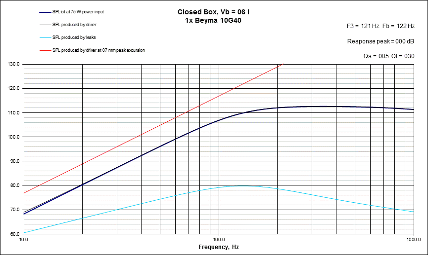

In the examples above:
  1. If Vb= 6.3 liter, then Qtc=0.71 and Fb=122Hz, and F3=121Hz
  2. If Vb=20 liter, then Qtc=0.49 and Fb=78Hz, and F3=119Hz
  3. If Vb=10 liter, then Qtc=0.60 and Fb=101Hz, and F3=119Hz
So F3 is pretty much unchanged regardless of Vb used.

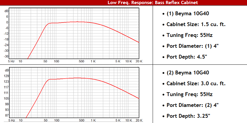

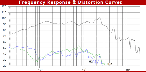

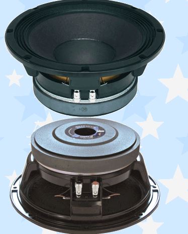

If I had a 10" PA driver like the Beyma 10G40, I'd just guess that about 2 cubic feet would suit it. Reflex or closed box might depend on the Qts of the driver. Since the rather splendid Beyma 10G40 is Qts of 0.3, I'd also guess reflex.
High Efficiency Speakers
Not a big surprise that US speaker gives you a choice of 1.5 cu feet with a long port, or 3 cu. feet with a short port then. Reflex being about 24dB/octave BW4 usually. Naturally it will start to bottom out around a mere 20-30W of bass at 60Hz. High efficiency means worse bass extension. It's how it works. Any more questions? 🙂

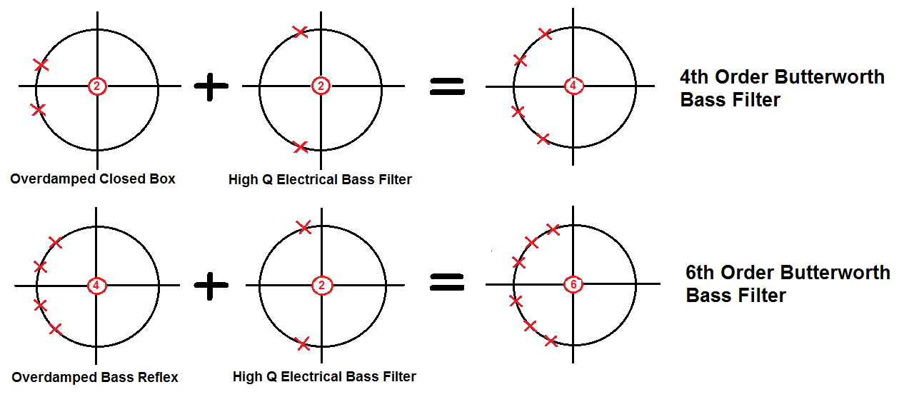

1. Second order Linkwitz Riley, where Q = 0.5 Model the closed box for a Q of 0.5. What is the 6 dB down point? that would be the crossover frequency to the sub when using the 2nd order low pass option for the sub. No DSP high pass would be used to the mid bass. Drawback of this will be reduced power handling and a really big box. You also have to have the sub and mains out of phase to get them to sum correctly
2. Fourth order Linkwitz Riley. a 4th order Linkwitz Riley is made by taking two Butterworhs at the same frequency and putting them in series. Model the closed box for Q = 0.71 (Butterworth). What is the -3 dB down point? That will be your crossover frequency because you will also need to configure the dsp high pass as Butterworth at the same frequency as the box resonance frequency (LR crossover frequency = -6 dB, Butterworth = -3 dB and -3-3 = -6). Config the sun for 4th order low pass at 121 Hz. This will give much better power handling for the mid woof and a smaller box. Drawback of this is the crossover frequency will be 121 Hz, which may be too high from the sub. Generally you don't want the sub low pass higher than about 80Hz as it becomes easier to localize, but sometimes you can get away with it. For example, my HT sub crosses at 115 Hz and it works, but in my stereo system in a different room would not work

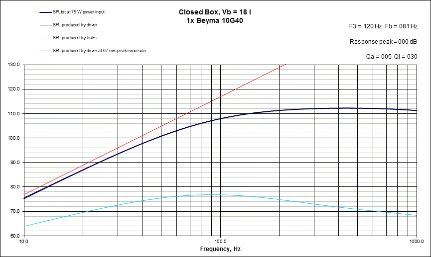

1. Second order Linkwitz Riley, where Q = 0.5 Model the closed box for a Q of 0.5. What is the 6 dB down point? that would be the crossover frequency to the sub when using the 2nd order low pass option for the sub. No DSP high pass would be used to the mid bass. Drawback of this will be reduced power handling and a really big box. You also have to have the sub and mains out of phase to get them to sum correctly.
An 18 liter sealed box returns a Q=0.5. Is 18 liter considered a really big box? Attached frequency response from UniBox. The 6dB down frequency is 80Hz.
Chart shows one 10G40 in an 18-liter sealed box driven at 75W, and reaching 106dB at 80Hz. The amp can deliver 300W cleanly (rated at 400W), and I was planning on two 10G40 per side. It seems I would have headroom in terms of power handling.
A 6.3 liter sealed box represents Q=0.71, and F3 is 121Hz, as you mentioned.

But the full LF signal is applied to the driver. It may run into power overload at LF.
If you adopt the Butterworth and use an elecrtical Butterworth Filter for an LR4, then the driver is protected from the full LF and you are much less lekely to damage the driver.
This is especially important when you don't use a sealed box speaker. Open baffle, infinite baffle, horn, tapped horn, Quarterwave and vented, all have no inherent LF protection for the driver. They need a filter if you want to apply high level signals.
You explained that well AndrewT. The electronics protects the bass from excessive excursion. A subsonic bass filter in effect. We did electrical filtering of a novel B&W reflex speaker a while back. The idea was the additional box of electronics was a steep second order filter and it ended up BW6. Like DSP really.

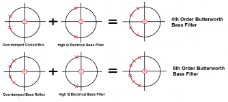

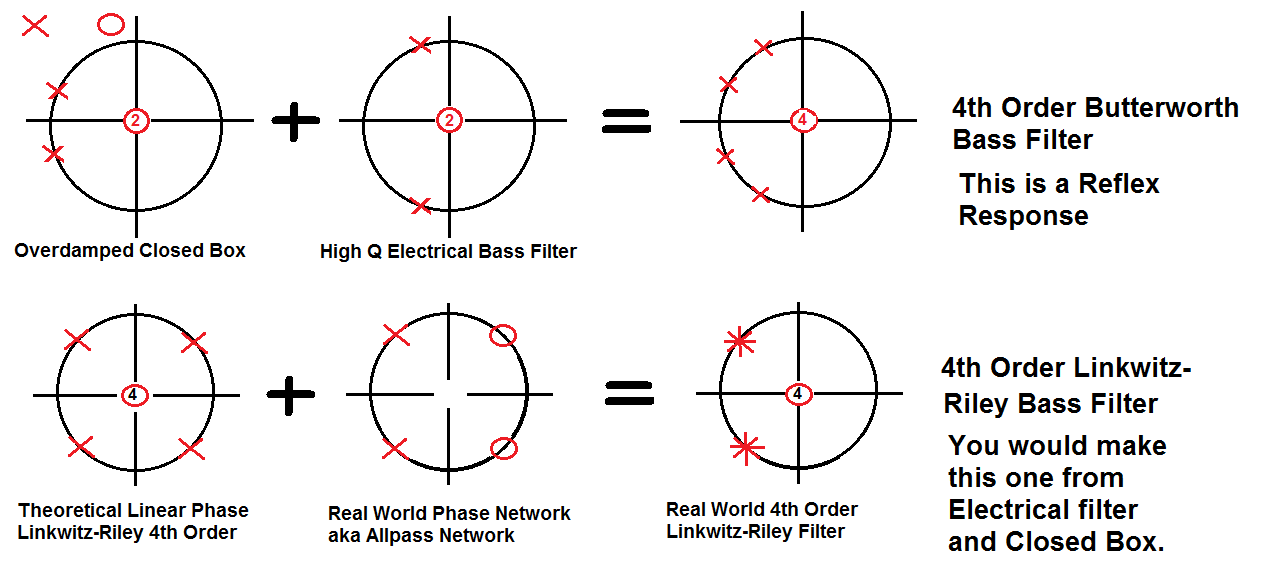

Just to make clear that Overdamped refers to a box bigger than Q=0.71 optimum. Underdamped is a box smaller than optimum. For Qts=0.38 optimum reflex it is the Vas. It is also the Vas for Qts=0.5 drivers in closed box.

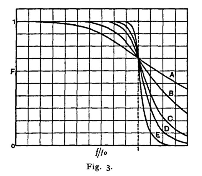

Anyway, here's some steeper Butterworth slopes of increasing order, and some pole-zero diagrams of what you can do. For shallow BW2, the -3dB point F3 is considered to be Fo, that is the radius of the circle or the Fs. For this Beyma 10G40 driver 55Hz IIRC and the reflex is about BW4.
You can see that two BW2 filters in succession make a LR4. Because you just add the poles.
Hope the images are interesting. Pole-Zero analysis is quite high level maths, called function of a complex variable. 🙂
