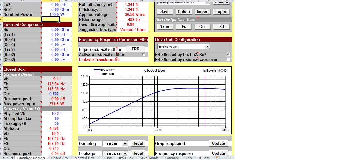

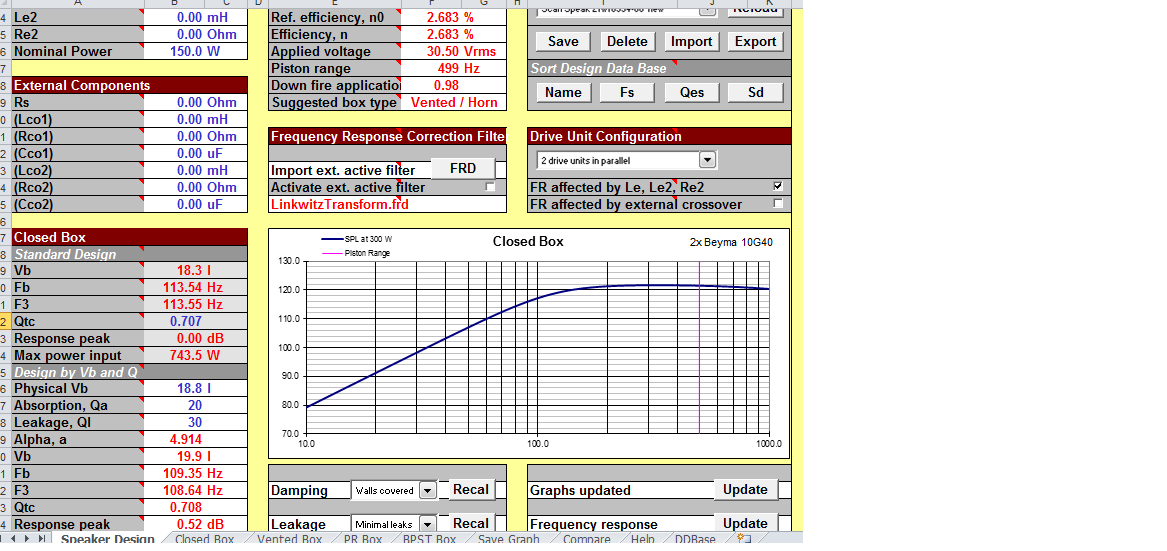

An 18 liter sealed box returns a Q=0.5. Is 18 liter considered a really big box? Attached frequency response from UniBox. The 6dB down frequency is 80Hz.
Chart shows one 10G40 in an 18-liter sealed box driven at 75W, and reaching 106dB at 80Hz. The amp can deliver 300W cleanly (rated at 400W), and I was planning on two 10G40 per side. It seems I would have headroom in terms of power handling.
A 6.3 liter sealed box represents Q=0.71, and F3 is 121Hz, as you mentioned.

I looked up the Beyma 10G40 woofer:
LOW & MID FREQUENCY 10G40 | Beyma
Vas 45L (=1.6 cu feet IIRC)
Qts 0.3
Fs 45 Hz
Optimal closed box for 0.71 Qc is 11L. That's ridiculously small, because this is actually a reflex driver. I think I showed some suggested 1.5 and 3 cu feet reflex designs. It's about right. Closed box calculations are here:

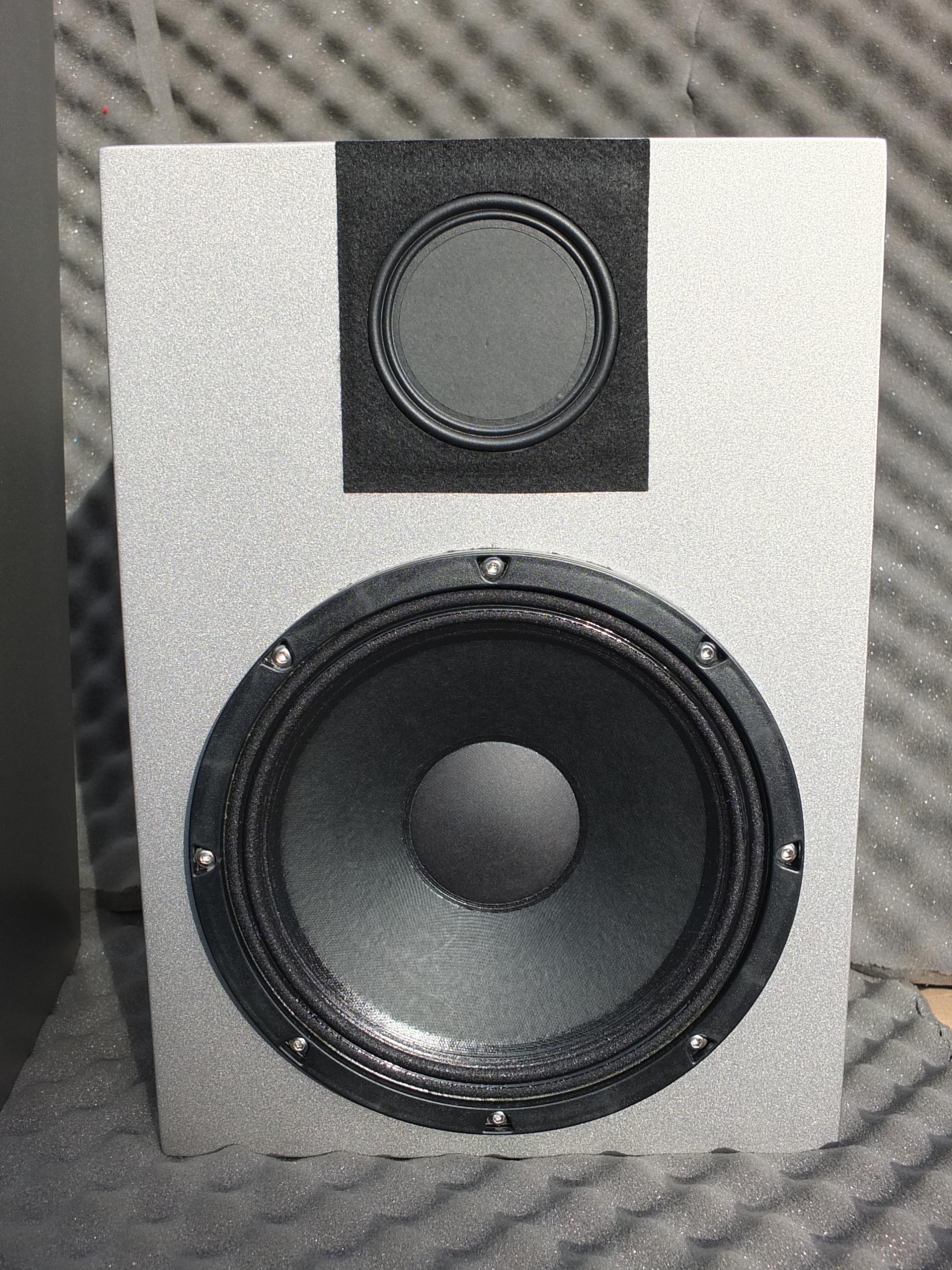

I have been working on a a range of two way active monitors and come up with SAM, MAM, and LAM....Small active monitor, medium active monitor and large active monitor....Attached is the SAM with a 10 inch bass mid (OEM'd to suit my needs), I will post a pic of LAM with my 15 inch bass/mid...Still working on MAM!
My designs are different as they use a 300Hz crossover to the mid / top driver (my own design of BMR) so they will only be of limited interest when using a conventional 1KHz to 3KHz crossover point.

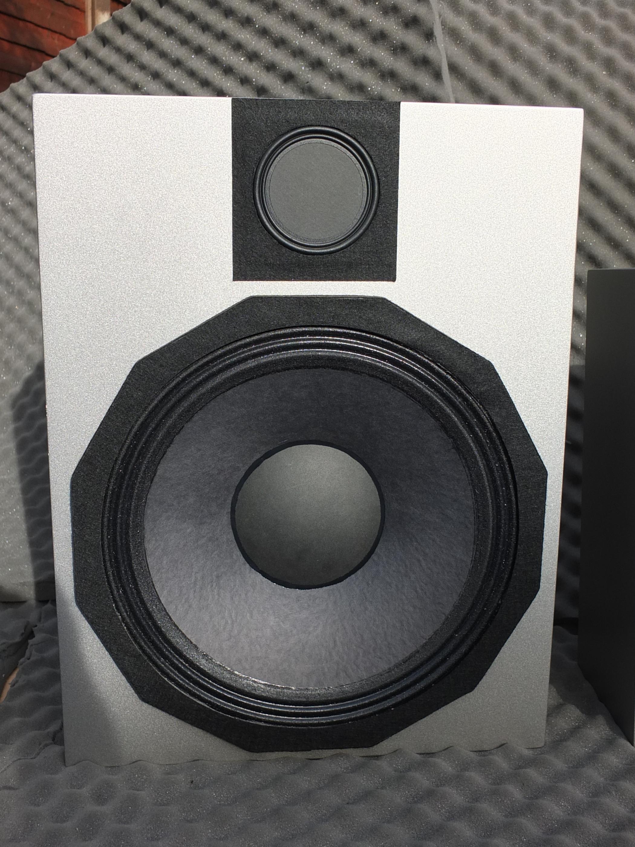

Here is the LAM
15 inch low Mms very high(!) Bl, 4 inch voice coil, crossed over at 300Hz.

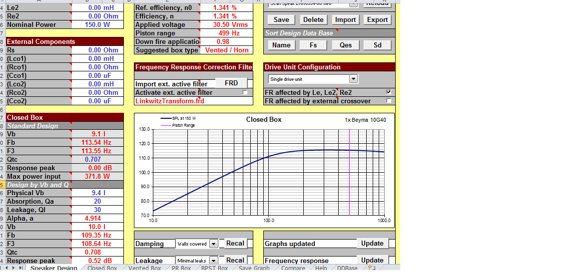

I have attached a simulation of the 10G40, Whilst I havn't used this driver and been able to compare real world results with the sim I have found this simulation very accurate with other drivers.
What is not very accurate is the plus / minus 10% or even 15% manufacturing tolerance of many manufacturers.
One of the main advantages of going OEM is the ability to specify tolerance, all be it at a £££.
Anyway, the reality is all the old school thinking as described above, is a million miles away from the best solution.
Back when this theory was valid, power amps were expensive, materials science & voice coil design had not advanced to thermally resistant adhesives, Kevlar, nomex, advanced damping compounds, cone manufacturing and precision VC windings with power cooling....Never mind high power Neo motors, carbon fibre and computer modeling / FEA / and thermal probes....
Using all the software and usual suspects of EBP, TS calculations etc etc the Beyma 10G40 is classed as a reflex design....

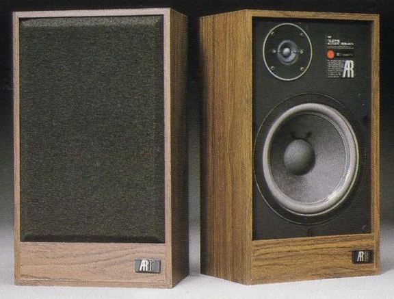

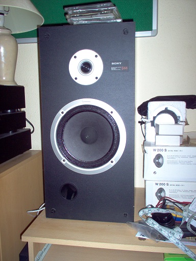

Here's two ways of using a reflex diver, ie Qts 0.3 and Vas of 49L and Fs of 45Hz.
We could use it Acoustic Research style in a tiny but neat 10L. Like the (nice) AR18S. Which incidentally had an increased cone mass (because that is the essential difference between Qts 0.3 acoustic suspension and Qts 0.5 closed box, though low loss foamed surrounds were part of the design too) to get Fs down.
Or Sony E44 style in 30L reflex. Nice retro cloth surround PA-type driver, BTW. One of the best reflex designs I have heard.
Well the fact is, on the same Beyma type PA driver (Qms = 7.1!), the Sony goes deeper. Maybe F3 (-3dB point) 55Hz.
The AR style would only manage a dismal F3 of 105Hz. TBH, that wouldn't work for me without a sub. But, hey, you can do that too:

First screenshot is the 10G40 in UniBox at 150W, minimal stuffing, and a 10.3 liter box represents Qtc=0.71. In line with Derek's calculations.
I'm thinking heavier filling to minimize reflections from the box and back out through the driver, so the second screenshot is set for "walls covered" and a 9.4 liter box represents Qtc=0.71.
I model one driver because I'm planning a sealed enclosure for each driver. But I'm also planning for two drivers per side, so then I modeled two drivers in paralel in an 18.8 liter enclosure, at Qtc=0.71. That's the third screenshot.
The amp on hand is a Hypex UcD400, rated at 400W, but I believe it has clean output up to 300W so that's my upper limit for the purpose of my calculations. The amp will only drive the 10G40s, in parallel. Hence in UniBox I use 150W to each driver.
The chart displays frequency response of the two drivers in an 18.8 liter box, driven at 150W per driver. It shows at 80Hz and 150W per driver these would reach 114dB SPL. I envision DSP triming everything above the 80Hz point so SPL would look flat and the maximum achievable SPL would be 114dB.
I usually listen at 80-85dB SPL,sometimes going to 90dB, and rarely above that. Seems 114dB would be plenty of headroom. BTW, at 114dB at 80Hz each driver is displacing 4mm vs 7mm Xmax.
At least those are my thoughts! What do you think?
