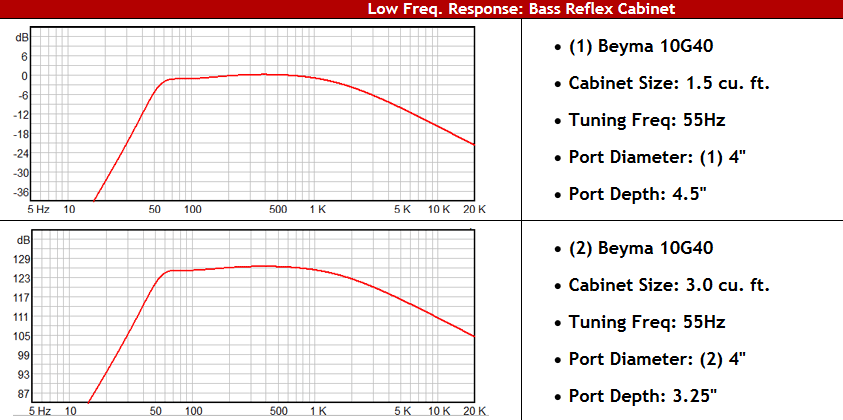

I looked up the Beyma 10G40 woofer:
LOW & MID FREQUENCY 10G40 | Beyma
Vas 45L (=1.6 cu feet IIRC)
Qts 0.3
Fs 45 Hz
Optimal closed box for 0.71 Qc is 11L. That's ridiculously small, because this is actually a reflex driver. I think I showed some suggested 1.5 and 3 cu feet reflex designs. It's about right. Closed box calculations are here:

I have attached a simulation of the 10G40, Whilst I havn't used this driver and been able to compare real world results with the sim I have found this simulation very accurate with other drivers.
What is not very accurate is the plus / minus 10% or even 15% manufacturing tolerance of many manufacturers.
One of the main advantages of going OEM is the ability to specify tolerance, all be it at a £££.
Anyway, the reality is all the old school thinking as described above, is a million miles away from the best solution.
Back when this theory was valid, power amps were expensive, materials science & voice coil design had not advanced to thermally resistant adhesives, Kevlar, nomex, advanced damping compounds, cone manufacturing and precision VC windings with power cooling....Never mind high power Neo motors, carbon fibre and computer modeling / FEA / and thermal probes....
Using all the software and usual suspects of EBP, TS calculations etc etc the Beyma 10G40 is classed as a reflex design....
Yet I can pop it in tiny (10.7 litre) sealed box with a perfect 0.707 Q and get fantastic bass which is vastly superior to any ported / transmission line / BLH time domain wrecked loading....I save on space, materials and have maximum reliability and great performance....Eq'd to perfection and room tuned to allow for different locations/ listening positions and preferences.

First screenshot is the 10G40 in UniBox at 150W, minimal stuffing, and a 10.3 liter box represents Qtc=0.71. In line with Derek's calculations.
I'm thinking heavier filling to minimize reflections from the box and back out through the driver, so the second screenshot is set for "walls covered" and a 9.4 liter box represents Qtc=0.71.
I model one driver because I'm planning a sealed enclosure for each driver. But I'm also planning for two drivers per side, so then I modeled two drivers in paralel in an 18.8 liter enclosure, at Qtc=0.71. That's the third screenshot.
The amp on hand is a Hypex UcD400, rated at 400W, but I believe it has clean output up to 300W so that's my upper limit for the purpose of my calculations. The amp will only drive the 10G40s, in parallel. Hence in UniBox I use 150W to each driver.
The chart displays frequency response of the two drivers in an 18.8 liter box, driven at 150W per driver. It shows at 80Hz and 150W per driver these would reach 114dB SPL. I envision DSP triming everything above the 80Hz point so SPL would look flat and the maximum achievable SPL would be 114dB.
I usually listen at 80-85dB SPL,sometimes going to 90dB, and rarely above that. Seems 114dB would be plenty of headroom. BTW, at 114dB at 80Hz each driver is displacing 4mm vs 7mm Xmax.
At least those are my thoughts! What do you think?
