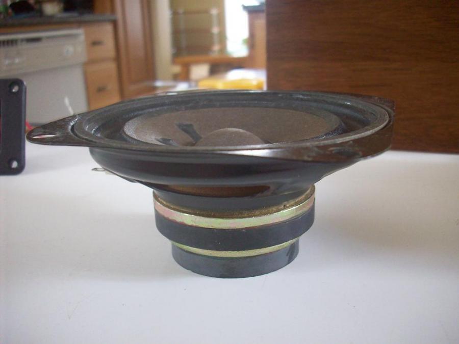

Smokehouse Bob said:Whilst perusing the local durable goods, eco-friendly, recycling management facility (thrift store), I happened upon a pair of the ubiquitous "Realistic Solo 103" loudspeakers. Charming little wood boxes with a single alnico-backed driver labelled "Foster". Mmmmm.....tasty little pair for less than the price of a quart of Natty Ice. I have read about these and their sound but never seen a pair to pick up. I'm guessing they are comparable to the Tunnel Reflex mentioned elsewhere. Enjoy!
Just came across a pair at the thrift shop just down the road from my job. In better shape visually that the ones pictured, too. $3.99 for the pair. Didn't want to wait in line, so didn't get them, just Googled and found this thread. May have to go back tomorrow...
Grab 'em, Chicks!
They are gems. I've been hunting, buying and selling them and their cream-coned Coral sisters for few years. Got maybe a dozen in my basement right now. They fetch $45-$100+ per pair for those who know what they are (and not all that many know about them). At those prices, I'd still call them highly undervalued in terms of price vs. performance. And, in just the few years since Planet10 made me aware of them, I've noticed they have gotten more and more rare.
My favorite alignment for them is assisted wideband OB, in a baffle on top of a nice big prosound woofer. IMO, they really benefit from a high-pass if they're going to do any loudness. Martin King has a great how-to.
Bill F. said:Grab 'em, Chicks!
They are gems.
Stopped by the thrift store after work to "Grab 'em", was greeted by an empty shelf. Someone else had snatched them in the four hours from lunchtime. Ah well. My impatience and ignorance resulted in a missed opportunity

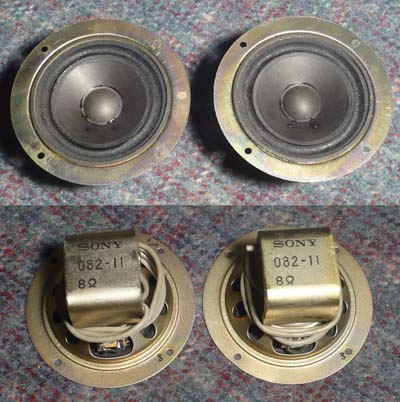

Hey Dave, Everyone,
I just found an interesting twig on the FE103A family tree. It appears to be a black-cone version of the holey-basket Coral. Same magnet and holey, round-flange basket, but the cone and dustcap are smooth black paper (no ribs), and the surround is black textile--less tacky, more like the feel of the Foster units.
The cream-cone holey-basket units I'm familiar with are stamped 082-12 or 082-13 on the magnet. These black-cone units are stamped 082-11. Earlier production, maybe? These are the first of their kind I've ever seen.
I'll post pics ASAP.
Bill
Bill
Bill F. said:Doug,
Yup, that's them. Are yours stamped 082-11 too?
Pics of mine below.
Bill
"082-11" correct. 8 ohms.
The 500A RtR decks were fitted with either with black or cream HB's, but I don't know the chronology.
Doug

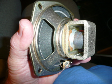

Another Fe103a variant?
This afternoon I got for AUS$10 a pair of Sony RtR speakerboxes. There was no marking to indicate which model.
Upon opening them I found a pair of SONY branded single drivers. Alnico magnet. 4". A 4-slot pressed steel basket.
The lettering is:
213-12
8 ohm 3W
JAPAN
87212
The have a black paper cone with 2 concentric embossed bands at about 1/2 the radius. A see-through black gauze dust cover.
What is known of this variant?
cheers
Doug

It may be the perspective of the picture, but to me the motor assemblies appear smaller than the FE103a family. Have you compared them side-by-side with another FE103a? Another family trait that seems to be missing is the treated gauze surround.
Bill is right, the magnet on these is significantly smaller, so these would fit into a class below the FE103A variants.
I have had these National OEMs in hand.
dave

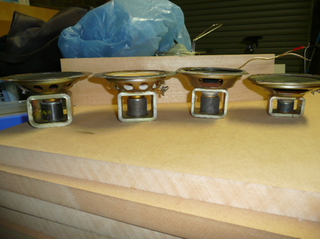

Correct, by golly!
Attached is a lineup (L to R):
black holey basket 082-11
beige holey basket 082-13
Sanyo Fe103A variant R-S6857
Sony 213-12
cheers
Doug
