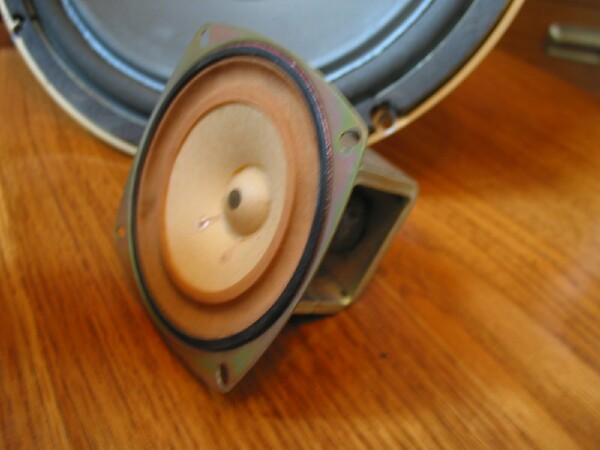

Which driver is the "real" Fe103a??
my drivers
here's another pic.

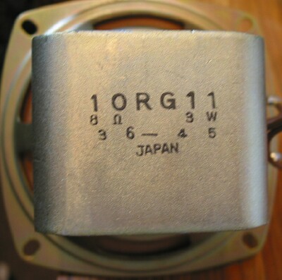

What model is mine? and is the mod consisting in removing the dustcap and inserting a phase plug?
Got a picture of the back? What numbers on it (likely 10RG11 or 5410182)? Mods consist of adding the phase plug, ductseal on the magnet/basket junction, puzzlecoating the cone, and adding the felt damper on the magnet. There are a couple other mods i often skip.

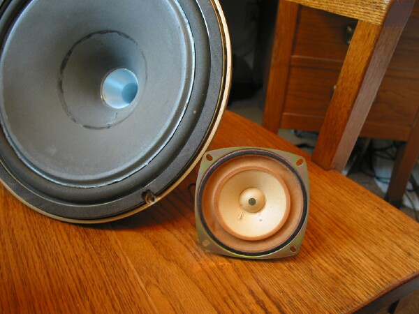

What is the big driver?

Hi Dave,
If you look at post number 21, you'll clearly see 10RG11 stamped on it.

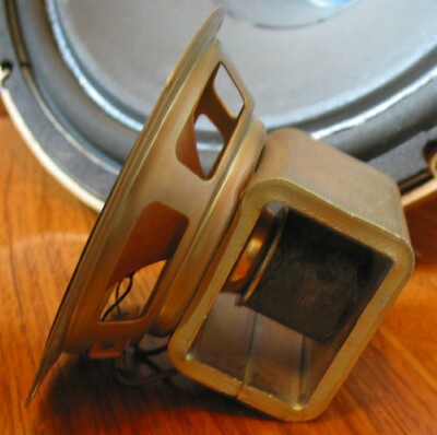

As for the phase plug, any suggestion to make one?
Big drivers? hum.. well, these are my daily faithful companions. I listen music music on them for more than 10 years now. Cheap but great Tannoys. (Tannoys for the poor guy like me! )

Fe103
Yep, my drivers wear the 10RG11 number stamped on the Alnico magnet, it has a cream color cone, a redish textile (rubber coated?) suspension, and a vented dustcap (with textile in the center hole)

planet10 said:
somehow i missed all but the 1st pic you posted when i commented this AM. This picture clearly shows that the surrounds need reattaching at the cone.
dave
Hi Dave,
Yes, the surrounds seem to have becomed partially unglued. What it is the best way to reglue them? what product should I use? I would like to make a clean job on them.
I use "outdoor" modge-podge. White wood glue would work as well. You need a small, fairly stiff paintbrush, and something to lift the surround with -- i use a little screwdriver.
Lifting the surround bit-by-bit, you paint the glue into the junction till you have done all the way round. As you go along you smooth down the surround with your finger, cleaning up any eccess glue as you go along. when all the way around, some "massaging" of the surround onto the cone. Watch for spots that want to lift. A tad more glue and more massaging.
