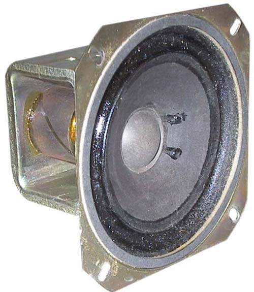

Which driver is the "real" Fe103a??

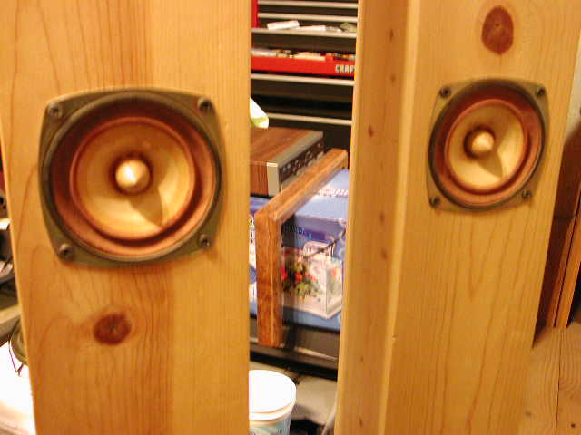

Fellers, these drivers with the plugs, duct seal, and wool felt in a pair of Z-horns are truly pleasant! Thanks! The 1197s, while not 103s, hold their own in the bass department. I had a little buzzing from the paper around the poles at first. But the slow build up in layers using Podge cured it.

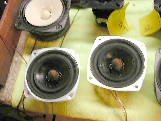

Whilst perusing the local durable goods, eco-friendly, recycling management facility (thrift store), I happened upon a pair of the ubiquitous "Realistic Solo 103" loudspeakers. Charming little wood boxes with a single alnico-backed driver labelled "Foster". Mmmmm.....tasty little pair for less than the price of a quart of Natty Ice. I have read about these and their sound but never seen a pair to pick up. I'm guessing they are comparable to the Tunnel Reflex mentioned elsewhere. Enjoy!
Thanks for the pictures, Bob.
I have the exact same speakers. They sound decent as a little bookshelf speaker for the bedroom, but I'm sure those little drivers can be so much more.
