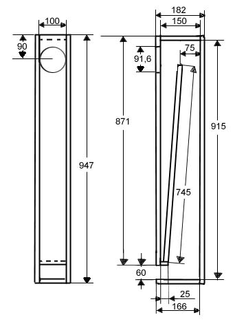

I have previously built a TQWT after Jean Hiraga's book, it is planned for 13cm drivers or so, and I it is well built, but I only had under hand a so so car full range driver.. but even then, it was sounding not bad at all, so, what would be a nice driver suggestion to buy for them??
I imagine the cabinets could accept drivers from 12 to 15-16cm..
Driver size (other than physically fitting the driver) actually has no direct impact on what would work. The Q, Vas, and Fs.
I assume it is a classic voigt? These are much more often than not, less than optimal. I'd suggest plugging t he cabinet into MJK worksheets and play with drivers -- given a fixed length you will have a small range of Fs to work in. You will likely find that restricting the terminus, will help a lot in getting a good response.
I expect GM will have something to say... he has a much better intuitive grasp on what works & what doesn't
dave

Well, it looks quite a bit like this: (see attached image) and the measurements are 90cm high, 18cm wide, and 25cm deep. (aprox 38inch x 7 x 10)
What are the spreadsheets your refer to? I am a newbie when it comes to speaker specs, I know.. Just wanting to learn.
Thanks!

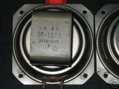

Is this a Fostex 103 variant?
Are these F 103 variants?
On the back is printed: 2W 4Ohm SP-10F5 and 92151240.
They came out of a set of cabinets that each had one driver and no manufacturer info.
Thanks,
Warren
Re: Is this a Fostex 103 variant?
If they are 4'/100mm yes. Do you have a picture of the front?

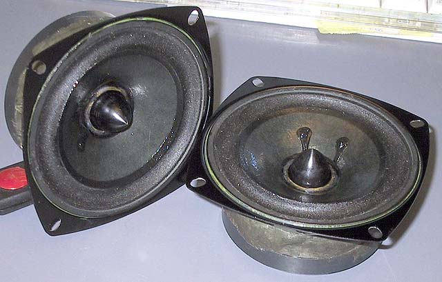

And while i'm here... here is a pic of a set of recently modded Radio Shack 40-1197 i did up for a customer.
The affordability, and accessibility of this driver probably did more for the popularity of the Fostex drivers in North America than any other single other thing.
dave

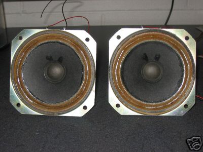

Fosters in question
Thanks for getting back to me. just go the (Atomix) on ebay and already have the phase plugs coming. I am thinking of putting them in the Solo 103. Have you heard anybody else's feedback on this enclosure?
Here's a pic of the front of the driver.
Re: Fosters in question
You'll have to help me on the eBay auction... a search of Atomix turned up mostly HotWheels & Clocks 🙂
Bass Relex cabinets are the kind of cabinet that is most sensitive to the speakers T/S parameters. The Solo 103 is a very attractive box -- i've used it as inspiration for a box for the new CSS FR125 -- but i would hesitate to build one verbatim. The parameters of these older drivers (i've not ever seen yours) typically have higher Fs & higher Q than the FE103 the Solo 103 was tuned for, so the liklihood of it being spot-on or even close is small.
A design like the Solo 103, but tuned for your drivers -- if their parameters are close -- is probably doable tho.
dave

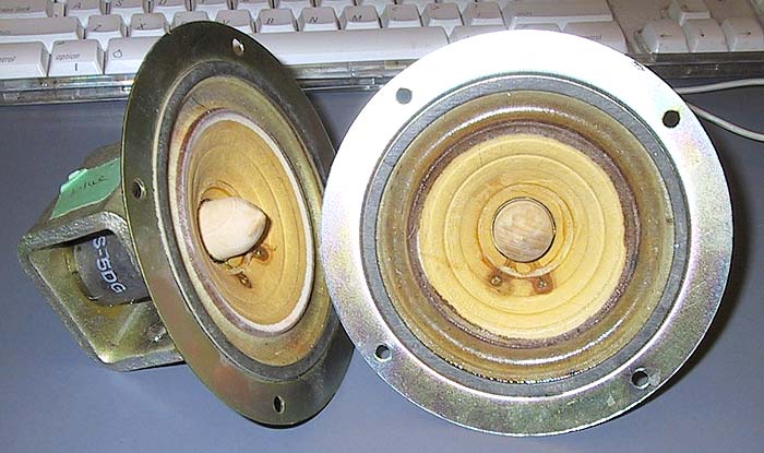

I'm very interested in purchasing a pair of your phase plugs for the Corals. Is this something I can install myself, or would I need to send them to you?
The Corals need a phase plug that we normally don't have. It is a bit smaller than for the Foster FE103A, so either needs to be custome built or you need to sand down a set of FE103A plugs (some work but doable -- picture of some 16 ohm holey basket Corals with sanded down plugs.
dave
