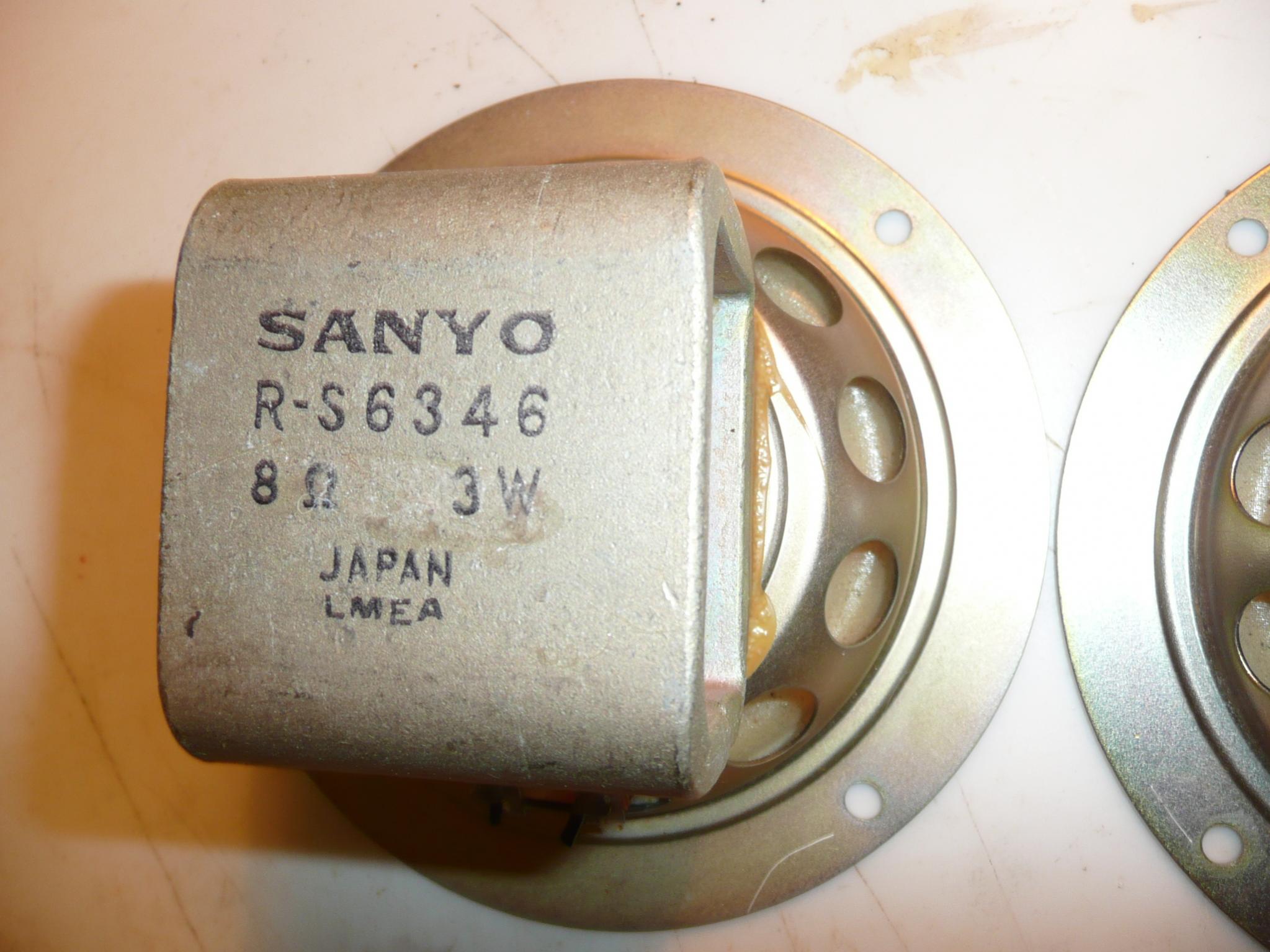

Well I did manage to grab them and to my great joy they appear to be in 1st class condition. I haven't swapped them into enclosures yet, but they appear physically identical to the beige Sony HB's.
The chap from whom I bought them removed them from a Sanyo RtR years ago, but can't remember the model. (Can anyone assist?)
cheers
Doug

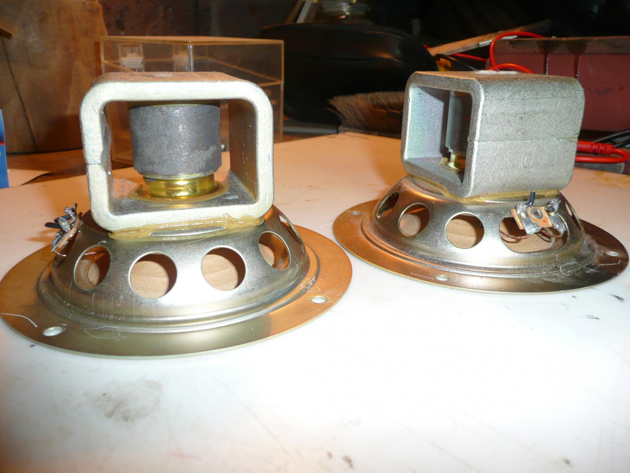

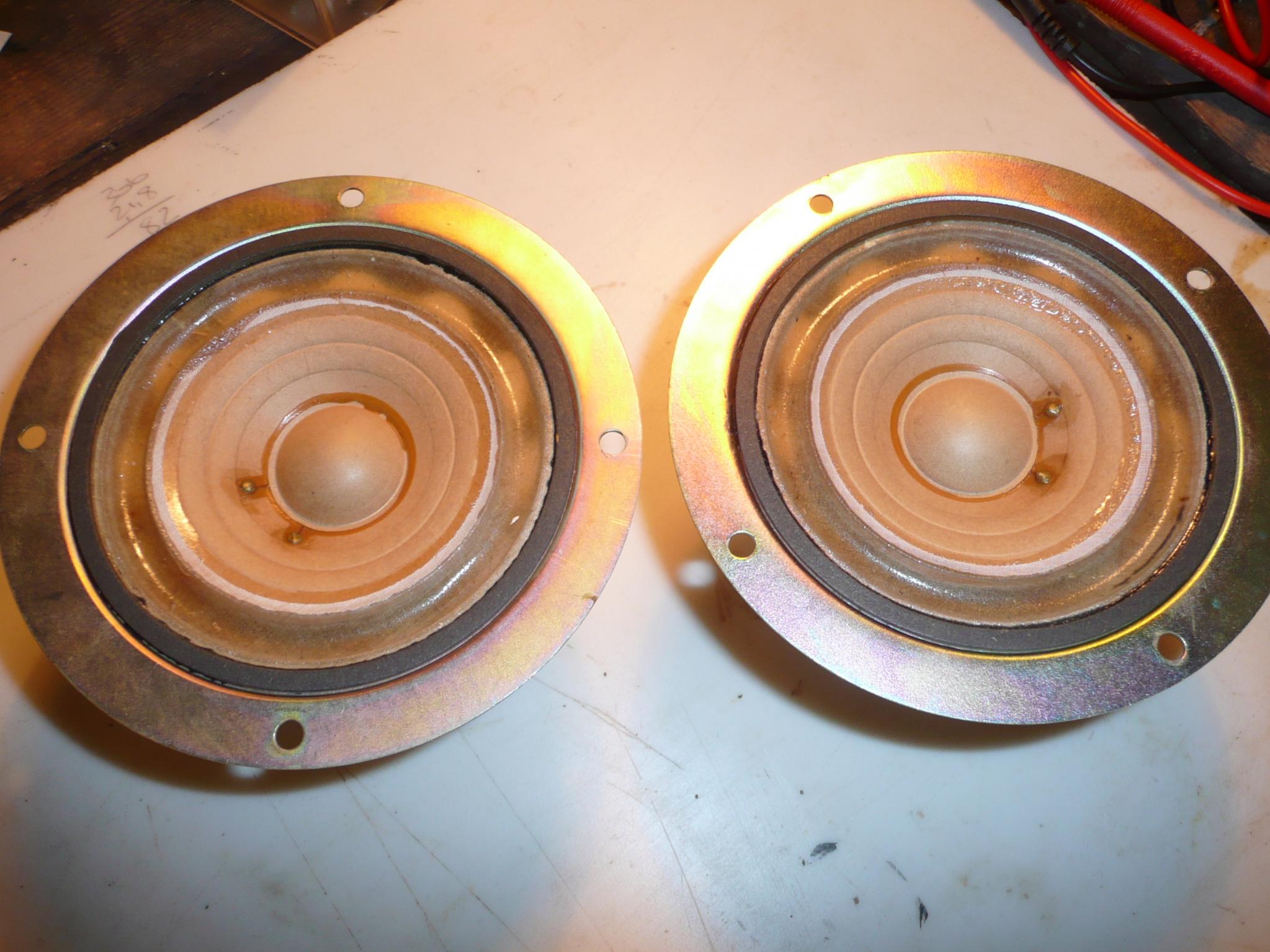

Let me add to the already vast array of FE103 variations/clones.
Sanyo "Bass Wave" enclosures, basically omni-directional double-fold concentric transmission lines, ~30" long, ~110Hz tuning, with up-firing driver into a conical diffusor. They each contain a single Sanyo-labled 4" fullrange, which appears similar to the RS 40-1197.
They suffer from SSS, with an elevated Fs~140Hz. I have applied armor all to the surrounds, brushed-in with a soft bristle toothbrush and got Fs down to 118Hz. Brushing-off the residues with light machine oil and then alcohol did not seem by itself to alter anything much more. But if I give the drivers a good "workout", 40Hz test tone to get ~4-5mm peak-to-peak cone excursion for a minute or so, Fs then measures around 108Hz. Qts are respectively 0.76 and 0.67 for the two states of Fs.
They sound pretty good once converted to direct radiators in the stock enclosure, other than bass being quite weak.
