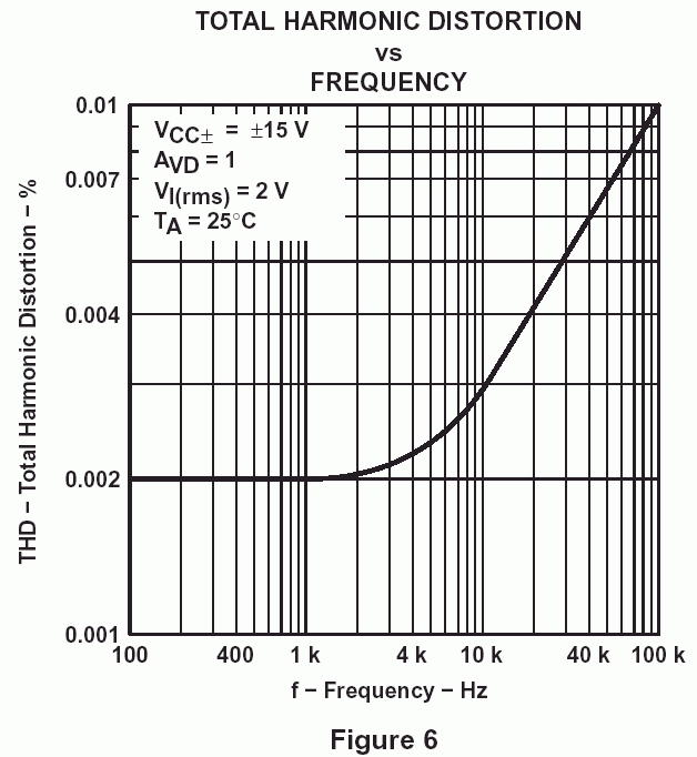

Hi JohnW,
I'm very impressed by the level of discussion between you experts, really. I wonder if I could hear 0.00005% of THD, especially at 100W or more. But I understand the necessity to keep all possible errors in the signal chain as low as possible.
Two little questions:
How does this quite low distortion level match with the datasheet statements (TI slos070B)? Is it a matter of the measurement equipment abilities?
What do you mean with the superior quality of the sound, coming from your turntable? If I remember right, you(?) stated some time ago, that anything, affecting sonic performance should be measurable (at least with the appropriate equipment). Is it possible, that you learned to love your components?😉
No offence, I take my hat off to you, I can only dream of this knowledge. I whish you a succesful test of the digital amp!
Best regards, Timo

The THD figure belongs to the TI's NE5534.

Timo,
I guess TI was having bad day when they measured there NE5534, below’s an FFT I perform just for you 🙂 - of a LM5534 @ 2Vrms 1KHz, THD 0.00017 - Excluding second harmonic THD 0.000033%. Due to the balanced nature of my modulator designs, even order distortion products are reject to a large degree.
Yes, I stand by my statement that anything that effects “sonics” is measurable – but its how & what we measure – and then how we translate these measurements into quantative results. E.g. what does 1% THD really mean? 1% second or 1% 10th… 1% second I can live with, however 1% 10th – and the units going to learn to fly….

LM5534 @ 2Vrms 1KHz 1K load

Jan-Peter (or Bruno, if not quite busy),
yesterday i had try to build UcD with second loop feedback, and THD have same tend to grow with frequency, of course.
By the MC7 simulations i expected 0.002% at 1khz, and 0.004% at 10khz,
but real THD was 0.016%@1khz and 0.07%@10khz (at 500hz about 0.007% etc to the limit of my audigy- 0.002%..what can i do if haven't AP? AP sys2 is ok, AP sys1-sob, without AP -$40audigy🙂.
Unfortunately only 4 hours of the weekend left for this experiment, and only TL084 (SO14) was available at moment (also, for this new PCB version, i'm still haven't listening/measurement), therefore i'm sure that's very preliminary result. However..
Mostly interesting that sound of the my old AB and modified UcD now exactly same,
and no more transparency & high resolution, just a blured [feedback?] sound.
My reference listener (my son🙂 after listening say same...
Jan-Peter, what about sound of your UcD+2nd loop?
PS (just a lyric): Yeah, 5E-5 THD it is something..IMHO it's HUGE work!Sometimes i ask myself: why people ready to spend so much resource for audio (entertainments generally), but not for fundamental or medical research?
