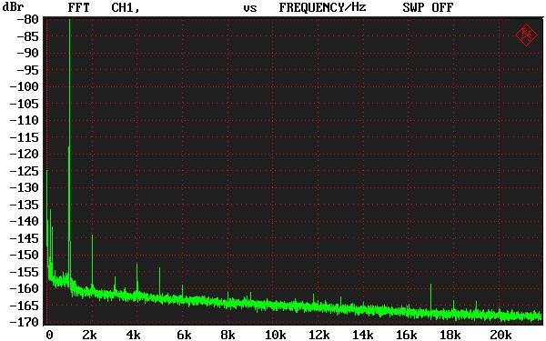

First, may I say thanks for your words of encouragement during my “Labour” 🙂
Just a quick update (maybe I should start a new thread?)
I spent the week constructing the PCB – jumping many hurdles – (thanks Flint for the COG’s that appear to be X7R’s, at least I think - dark brown dielectric not Salmon pink) 🙁
Construct only half side of HBridge – but first results seem promising, still away to go before a fully optimise design, constantly running into the limits of the UPD05 (long given up on the AP).
Biggest problem I now have is thermal / 1/f noise at lower power levels.
Below's an FFT of 1W 8R Single Ended, 0dB referenced to 100W, THD 0.00008% SE. Harmonics are the product of the R&S internal Generator.
That fact that there are basically no harmonics at lower powers bodes well for sound quality (Harmonics visible appear to be due to the R&S internal Gen).
Notice the gradual sloping of the noise floor – I believe indicating thermal noise, but further research is required. The FFT’s between the R&S generator and Amp output are identical – apart from the amps higher noise floor towards DC 🙁
But still very early days….
John

19 and 20KHz two tine IMD test results....

Hi John,
Can post the 19 and 20Khz two tone test results for us at say 100W into 8 Ohms.
Bruno / Jan Peter,
Did you have any 19 / 20K two tone IMD test for the UCD at the same power (John asked about this back along i think...?).
Cheers
Sheriff
John W
I must say that your results are astonishing. Was this a digital amp or a UCD? I suppose I can find out by reading previous pages but I am a bit lazy.

John,
Looks your are the winner for the lowest THD!
I did not yet understand your total setup, can you probably tell it again?
Perhaps some small block schematic will makes it easier to understand.
Jan-Peter
