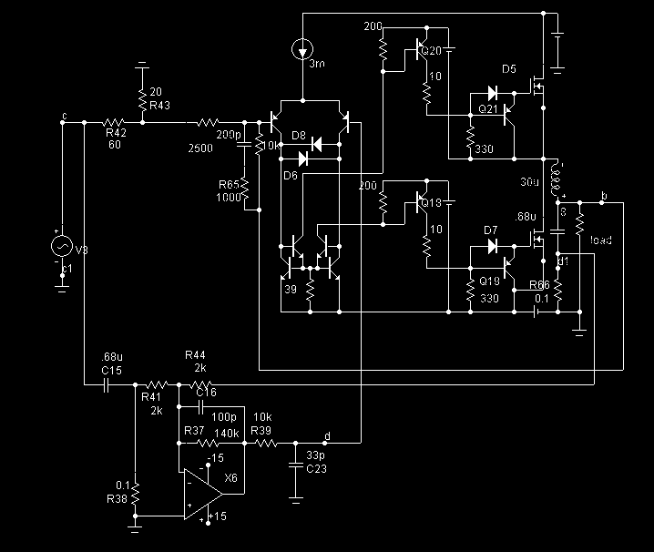

I have been working on a two loop classd design with a self oscillating hysteretic current loop using the return current from the output cap and the load (actually the inductor current) for generating hi/lo thresholds. The circuit is basically a voltage controlled current loop and I have been able to apply about 10dB of feedback at 20kHz and with an integrator in the voltage loop about 40dB at 1kHz. So far I have reached fairly good distorsion levels and sound qualities but I am sure that I can achieve even better with this technique. At 1kHz/1W into 8 ohm I have measured -106dB and the THD+N is below 0,05% at all powers and all frequencies (infinite lowpass filter at 22kHz). The damping factor is of course not very good at high frequencies but it is pretty good at low frequencies.
The thing that bothers me is that a voltage integrating circuit like IRs application note performs about -82dB at 1kHz/1W into 8ohm when my current loop only reaches about -70dB% during the same conditions. I mean, my loop does include the output filter and thereby should have lower nonlinearities. If I could at least reach the IR level in the current loop I would end up at about -110dB when applying the voltage loop (0,0003%).
I have noticed that you guys posses a huge amount of knowledge and was hoping that you could help me to answer a couple of questions.

Jan-Peter,
this schematic is nothing new for you, 2nd loop like amploiD, but i hope that at next weekend i'll try current feedback loop from filter cap. Simulations is ok, and THD in several times can be reduced, but if the sound will be worse vs UcD again..
Approximately such implementation, of course, input discriminator will be more realistic and maybe current trafo as output (like in Mueta appnote):

Why do you take the feedback from the capacitor current? The only reason why Mueta and I take the feedback from a current is in order to create a 1st order oscillation loop. In this schematic you allready have a wideband, linear oscillating loop generating a voltage directly and therefore measuring the current will only give you problems like EMI on the output, losses, and a huge gain at low frequencies (may not be a problem aftar all😉. It also appears as if you would end up with two -1 poles as the capacitor current will double each octave compared to the output voltage.
Correct me if I am wrong.

IVX,
If you take a look in the UcD Patent, you should also mount a schottky diode on the Basis Collector of Q20 and Q13. This function as a Baker Clamp and improves the switch of time.
Thereby I agree with Pabo that you have already a good phase feedback for creating the oscillating. Please read again the patent very carefully for how to create the oscillating ;-)
And why do you don't use the balanced input of the comparator as the input for the analog signal?

Yes, phase modulation is more frequency stable as the shift occurs when the output ripple crosses the output signal while the hysteresis forces the output to continues above the correct output signal for a while thereby making the "on-time" very long when the available voltage is low (which is the case at high output amplitudes). In my amplifier I have limited the modulation depth to 90% in order to keep the frequency from dropping too low. This means that I have 500kHz at zero signal, 250kHz at about 2/3 amplitude and 100kHz at 90% amplitude. There is an advantage with this behaviour as it lowers the frequency when the currents are high thereby decreasing EMI and switching losses in the output devices. The disadvantage is that I have to cross zero gain in the voltage loop before 50% of the lowest switching frequency in order to avoid mirroring (bad oscillation).
I must correct what I wrote earlier. The time that I reached -106dB in THD was not with a completely stable amp. I had to lower the pole in order to reach perfect stability which made the THD end at about -100dB. So in theory I should be able to go below -110dB but I will have to improve my current loop.

Ok guys, I knew that difficulties will be..😉
Schottki not in use because action of a medicine is more appreciable on the sick patient. So this patient gives 0.2%@10khz, and 0.019%@10khz after the treatment. I think that 10 times reducing is reason to try this wrong circuit in the next weekend. It isn't affected to UcD oscillation, and no huge gain at low frequencies. BTW, why i must use the balanced input of the comparator as the input for the analog signal?😕

Ivan,
I should mount a schottky, its only two diodes and it will improve it without extra feedback, that's what we all wants;-)
With the balanced input the is no signal current flewing thrue the ground, and everything around the comparator will be symmetrical. This will also improve your performance......

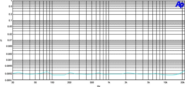

Hi Jan Peter,
I’ve dig my AP2C+ up from under piles of dust, and have been using it for distortion plots – but the internal residual THD+N level of my unit seems quite high: -
Could I Pls. request a favour and ask you to compare results to one of your units: -
1KHz 1V, GEN Mon 100Kohm input, 20Hz to 22KHz THD+N 0.00013%
Also is there a simple way to adjust output voltage of the generator without having to enter the level numerically – i.e. Up / Down curser controls?
Very much-appreciated in advance 🙂

John quote:
According to the specs from AP it should be ok:
http://www.audioprecision.com/bin/2700_series_specs_8211.0188r2.pdf
I just measure mine AP, yours is even better ;-(
If it's for sale, I am interested;-)
