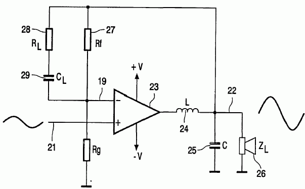

Some thoughts:
The EDN modulator is nothing else than the standard circuit for AMVs using an op-amp! We used this circuit 20 years ago during lab training.
The ICE power amp uses feedback from the switching stage AND from the filter. The lowpass in the feedback path of the inner loop causes the inner loop to behave like a lead filter and therby compensationg for one pole of the output filter.
The patent as such is not that sensational.
I think that the UCD doesn't infringe B&O's patent, since doing the same thing in a simpler and better way is definitely a technical improvement and therfore be worth getting patented.

The circuit Jaka Racman posted an image of seems so obvious and universal that it should not be patented whether anyone has tried and succeeded or not. I even feel that variations of it adding additional resistors and capacitors around the feedback node to modify the oscillation and loop properties also should not be patentable. That view is the one I have.. Sorry for ruffling feathers.
subwo1
The picture is from Putzeys ucd patent. Simon J Broadley has patented a similar topology but with a error amplifier comparing the input to the output before converting to PWM.
Jaka Racman
The circuit in which ICEpower uses the technique is VCOM (Voltage Controlled Oscillation Modulator). I think it was shown in fig13. in the patent mentioned earlier.
Jaka Racman
