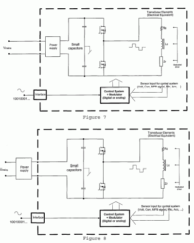

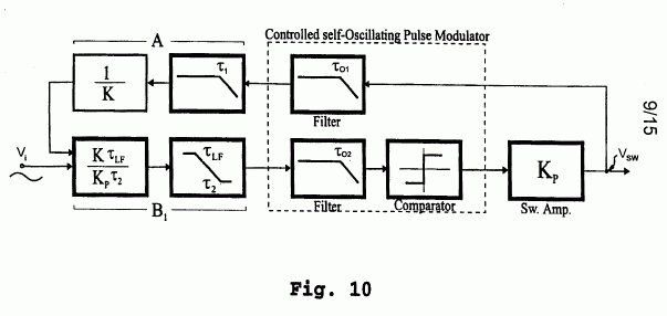

Hi Patrik,
Fig. 13 from the aforementioned patent has nothing to do with schematics posted. Maybe you were thinking of Fig. 10. Here is actually shown that the feedback is taken from the switching stage with additional low pass filters in feedback and forward paths.
The very reason I am disputing your opinion, is that I came to the Putzeys circuit by thinking how to improve ICEpower VCOM. I thought there is no reason to use low pass filtered output from switching stage, when there is already output filter. Let' s take feedback from output stage.
Only later I realized that this is the same circuit that Subwo1 had already posted. The only difference was that I thought that feedback compensation resistor RL was not necessary, while Subwo1 even included this one. We discussed this in the middle of a very long thread.
I also share Subwo1's opinion about Putzeys patent, but based on my post in another thread. It shows picture from US patent 6,489,841 which predates Putzeys patent. But then again, actual patent claims my be different.
The sad fact is that this circuit has to be the simplest possible implementation of the class D amplifier, and it is not in the public domain.

I'd like to throw in my cent's worth here. The Takagishi patent explicitly uses hysteresis (Vref1+/-dV in the comparator feedback in the picture). This is unnecessary - the delay of the power chain is wholly sufficient to obtain a well defined oscillation. Adding hysteresis will actually produce unwanted extra frequency modulation and adversely affect large-signal linearity of the modulation scheme. Unfortunately for MPS, the patent makes the hysteresis part of its claims.

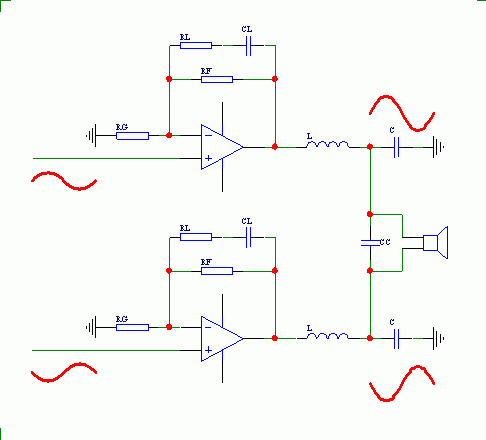

Hi Mr. Putzeys,
While Takagishi has been granted three patents on the same circuit it is true that all of them use hysteretic comparator. I stand corrected.
I would hovewer like to use this chance and hear your opinion if posted circuit infringes your patent. IMHO it improves on your circuit in two ways:
first it prevents power supply pumping at low frequencies (well known fact that can be considered public domain)
second, by using CC coupling capacitor in filter it forces both halfs of the amplifier to oscillate at the same frequency and phase. This canceles ripple in differentially coupled load as can be seen in this simulation .
Since I have no commercial interest in this design, I would like to proclaim it as public domain, but only if you feel that it does not infringe your patent.

Bruno, I have a gut feeling that full bridge version of UCD is not so sensitive to capacitive loads, since oscillating frequency is dependent on filter common mode capacitors which remain the same. Since Philips is using full bridge in production allready, it has priority and I think there is still chance that you include full bridge version into your national patent applications.
BTW, there was mistake in the schematics I posted, feedback shoud have been taken from output capacitors, not before the inductor.
