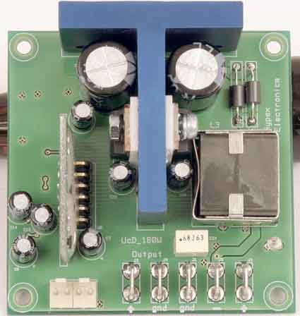

Hi All,
I had promised a presentation of the DIY Class-D module on our website. Unforternatly we are quit busy with upgrading a 2-way and 3-way analog amplifier for one of our OEM customers to UcD, so less time for upgrading our website.
But hereby a photo of our 180W DIY UcD Class-D module!
Jan-Peter
www.hypex.nl

Hi Charles,
Thanks for your nice comments.
A Class-D amplifier should always look `Cool`.....;-)
No, no....... no dedicated IC. All is SMD transistors, and full discrete. The only IC is an input gain opamp to increase the gain to 26dB. Currently I have used a NE5532 probably we move to a OPA2134.
This version will be with High graded Audiophile components.
Some specs:
Power 8 Ohm - 100W.
Power 4 Ohm - 180W.
Outputimpedance - 0,010 - 0,020 Ohm.
Flatfrequency responce undependend from load.
THD - 0,005% - 0,05%, 0,1W - 80W at 8 Ohm load.
Switchingfrequency - +/- 400kHz.
Easy mounting.
Only 2 voltages, +45VDC and -45VDC.
Shortcircuit protection.
Power supply pumping protection.
All Audiophile components.
Cool Blue looking, blue anodized aluminium and blue amp on LED.
Etc.....
Price one module €60,00 ex. VAT, ex. shipping.
We are currently busy with a 400W version.
Jan-Peter
www.hypex.nl
