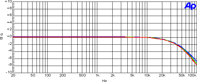

Upper frequency is -3dB at 50kHz, 1st order, see graph.
With a powersupply of 2 x 45VDC, the outputcarrier is around 300mV. I don't know yet if this was Vtt or Veff, I will measure this next week and post the answer.
Jan-Peter
www.hypex.nl
P.S. Graph is from the original document from Philips and measured by Bruno.

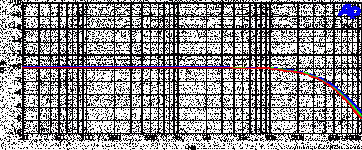

AUX0025 Frequency response, 0.002 Ohm input impedance, 100K output impedance

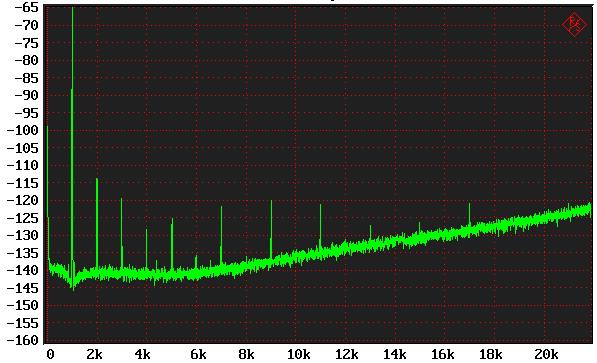

Below is an FFT of a TRUE digital amplifier, 118W 8Ohms 997Hz THD 0.0003% modulator and clock limited. Awtd dynamic range 114.5dB – again modulator limited.
The noise floor is analyser DR limited at low frequency (R&S UPD05) and noise – shaper limited (NS operating at 384KHz) at 20KHz. The R&S only has a ~30dB notch filter – I should use the AP, but I hate the AP’s user interface, the AP is not really a R&D tool – but its great for the production line….
118W 8Ohms 997Hz THD 0.0003% DR 114.5dB

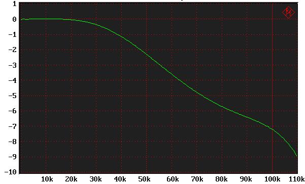

1W 8Ohms FFT plot of the above TRUE digital amplifier (about –30dB), now the “Poles & Zeros” of the noise shapers PWM “Linerizer” can be clearly seen. This is a 1st generation 384KHz PWMFs modulator. Later generation modulators achieve about –160dB noise floors (again @ 384PWMfs)
THD 0.0008% - but this result is noise only, as no harmonic (or non harmonics) can be seen above the noise floor – note the ~35dB notch of the fundamental by the R&S (0dB is referenced to the 118W 8ohm measurement).
