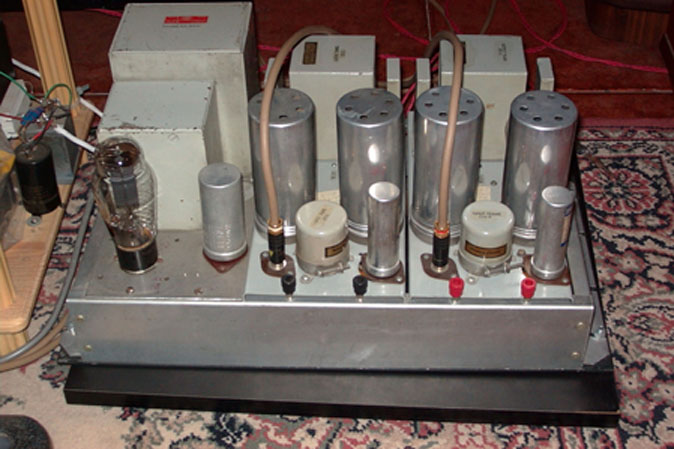

I had this opinion because I repair many old WE console amp & I find out many we old amp also use this mix use of resisters.
the photo is we k133 amp was use IRC mix AB resisters to use.

hi march_y,
my friend 's we124 amp also use same IRC metal film mix with AB carbon film resisters to use. in the amp.
He use Lowther TP1 & tannoy monitor gold 12 inch, ( I forgot the model no.) But added one Fostex into the Tannoy. Its very good. Still had Horn's density But Added more high air.
Pls see my friend's amp.
thanks
Thomas
thanks
