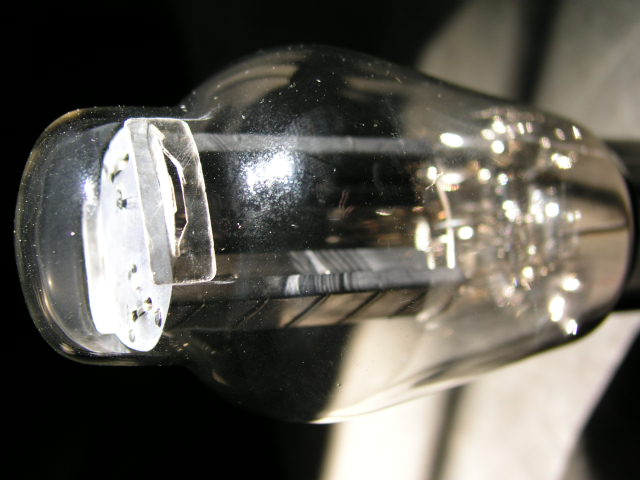

Would there be any benefit to building the power supplies on seperate chassis? What about putting both power supply sections on the same chassis? If I did this, what connectors / cable are recommended to go between the power and signal section? I would need 7 wires, correct? B+, ground, earth ground, 300b heater and return, and 6AN4 heater and return.
Last, can anyone comments on using the 6AU4GTA tubes? would there be a benefit to going to a 274B for example?

Hi mach_y,
I agreed that if the budget is Ok. Pls choose monoblock.
Then no cross talk. But if U mono Block & the driver stage use small rectify tube rectify to supply to the driver & input.
The Big rectify tube such as 5u4 will only supply for the power output stage.
But there must considerate the capital. this method use for times of rectify tube & cap & chokes.

hi mach_y,
I test the cheap version of china made 274 tube & 5ua tubes.
The sound quality is the 274b a little best. More detail but smooth than the cheap 5u4.
But this method use in monoblock will more better.
Use one 274b in one stereo & if teh current use more than 180ma. the 274 tube will a little serious. But the 5U4 cansupply more than 225ma, some will more than 250ma. In over 180ma condition, 5u4 still had less serious sound.
But at last i still select 274 because of detail & smooth sound than 5u4 tube.
P.S. My kit I will supply 274B, but certainly U can choose 5u4.
This is flexible & up to U choice.

Mach_Y,
As for different rectifier tube, the reason why a 6AU4 is used is because the circuit demands a very high voltage, I do not know the rating of a 274B, but a 5U4 or 5AR4 will not work due to its lower voltage rating. Actually the 6AU4 is a damper tube and really not designed for audio, but I do not know of any indirectly heated rectifer that has a slow turn-on that has a 700+volt rating.
Jack recommended 5R5GYB, and I have used it, but this tube is a directly heated tube and does not have a slow turn on, so I thought I might as well used SS. So I used 6AU4 instead. SS rectification for the DRD amp is really not that bad, I was reading ron welborne writeup on his DRD amp and he likes SS rectification. Jack Ellianos original design is also SS, so I do not know....

hi cdeveze,
the best is WE412a. Others choose 6X4 or EZ80,81.
412A Full-Wave Rectifier
(Filament=6.3V @ 1A, PIV=1250V, DC max ouput current = 100ma)
274b spec, visit.
