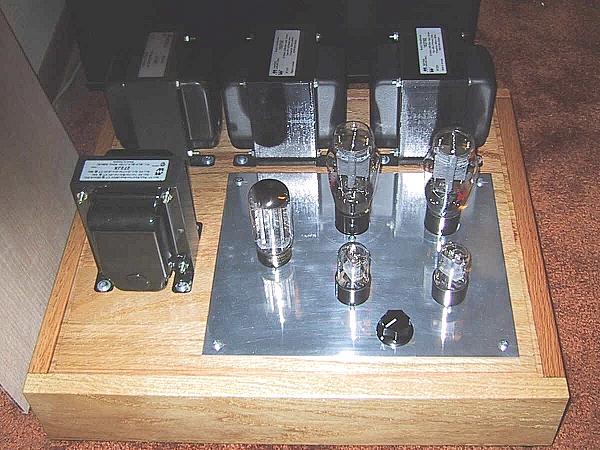

Hi Ashok;
Some time ago I built a 2A3 SET driven by 6SL7's - it uses a cathode follower arrangement (no flames please!) and sounds great. The schemo can be found at angela.com in their "how to" section. It's the JE Labs 2001 Edition. While the basic schemo is not mine, the layout and parts selection are, and the result can be seen at: http://home.earthlink.net/~shidenkai/id2.html along with pics of some of my other projects (you'll need to go to the links at the bottom of each page).
FWIW, here are the changes I would make if I had to do it over though. 1. PS Trafo - I used a Hammond 272JX - I would substitute the 372JX. 2. Chassis - I used oak hardwood throughout (the sidewalls are 1-1/2" thick) and would add a layer of 1/2" plywood under the top deck. That's because I had some problems with the stability of the oak due to transformer heating in one spot - the plywood really would have helped. It's fine now, but it took considerable bother to "fix up" that oversight. 3. Volume control - I used the hard to find Alps Black Beauty, and frankly would have been better served with the equally good and easier to find Alps Blue Velvet. The Blue Velvet is also sturdier in terms of the construction of it's solder tabs (that's the Black Beauty's Achilles Heel). Lastly, I used a 5U4G rectifier, rather than the superior GZ37 (5U4G is not a "slow turnon" variety, and it had caused problems with the turnon spike). After some mods (including a standby switch), it's fine - but it would have been easier to allow for that from the first, or just use the proper rectifier.

PS You've made a fine choice in the SovTek 2A3. It's tough as nails and sounds great! It's one of the best buys on the audio scene these days, IMHO.

Hi Morse,
Your amp looks very nice ! The wood especially looks quite nice.
Thanks for all the details. That circuit looks good. I also saw one with a SRPP input stage. I found SRPP to perform slightly better audibly in some preamp stages. I wonder if that will be true in this case. In any case the amps have so few components that it is worth while trying them out. I guess voltage gain is also important. The SRPP will have much less gain.

Hi Ashok;
Thanks for the compliments on the chassis work. One other addenda to my post would be that you should use a polyurethane glue (Titebond II "outdoor grade" or "professional" or something like that - read the fine print and you'll find out that the right stuff is a kind of polyurethane), which stands up to high temperatures better. The white glues tend to fall apart after a while of medium to high temp exposure.
>>>...That circuit looks good. I also saw one with a SRPP input stage. I found SRPP to perform slightly better audibly in some preamp stages. I wonder if that will be true in this case. In any case the amps have so few components that it is worth while trying them out...<<<
Frankly the circuits are so simple that you might want to try building both of them on separate, interchangeable, "plates". Then build a single power supply/chassis and try them both out. If you find that one topology sounds MUCH better to you, then you can always use the "surplus" mounting plate/amp circuit as a testbed for different topologies/components. To simplify the swapping out, you could design the chassis to use terminal strips so you wouldn't even need to undo any solder joins.
You could even try a 6SN7 cascade to drive the 2A3. It works for 300B, so why not for the 2A3?

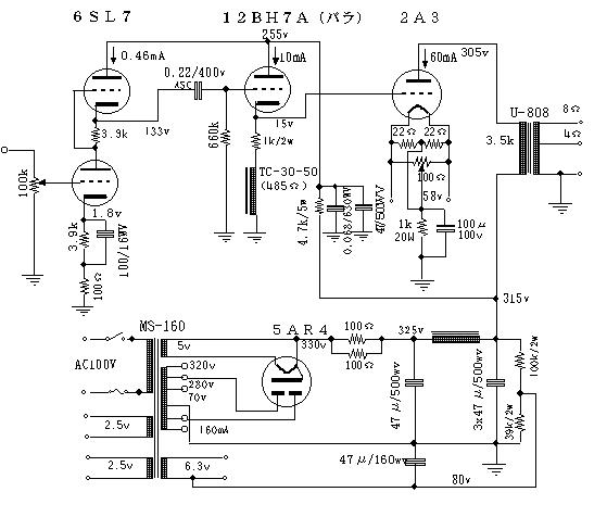

2a3 SRPP
hi Pingfiold,
pls see this 6SL7 & 12BH7 SRPP circuit. This is another circuit beside JE labs. I both test them & I use this circuit to build one SE amp two years old. Sounds quite good, my friend go to my home hear the sound & get it away. Paid money to me.
This circuit had a powerful & deep bass but good texture.
pls study & hope can fit for U.
thanks
thomas

Konnichiwa,
Well, here is a schematic for a 2A3 PSE Amp by Kondo, it also has a SRPP Driver and sounds quite good, if implemented correctly and with the correct parts.
Kondo nowadays also makes a version with build in Preamp, basically an "integrated" Amp alled Neiro-Ongaku, the linestage is close to the M7 shown below.
Sayonara
