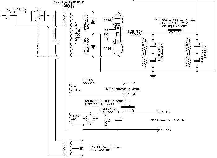

The Second DRD amp I build for myself, I just finished this week uses 6AN4 as the driver tube, All Electra-Print Transformers and chokes except the power transformers which is from Audio Electronics Supply, 60uf ASC Oil Cap and a 22uf GE Oil Cap connected in parallel. The rectifier is hybrid, the PS Tranny is rated at 375-0-375, so what I did to get 700v is build a bridge with 2 solid state Hexfreds to ground and 2 6AU4 to B+. This works, but how good is ???. All this parts that I build my amp from are from my previous projects, except the chassis that a friend of my build. I will post a photo as soon as I got one.
Here is the schematic:

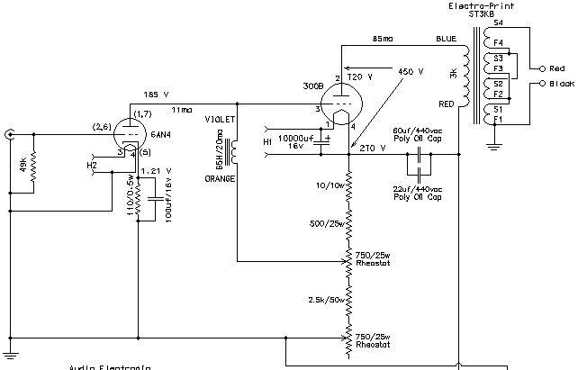

That's something that I don't understand as well, but my reason is due to ignorance. How does one get around using excessive voltage on the plate? I noticed that on the 2A3 design as well and most of the time my voltages wind up being higher than maximum plate voltage. The schematic from EP shows a B+ voltage of 700 volts with 705 volts on the plate, 280 volts on the cathode and 198 volts on the grid.

The 500v or 700v or any voltage B+ on a tube is referenced on the ground, the tube operating voltage is measured ACROSS the tube, so on this amp, as in my circuit, the voltage across the 300B is around 450v, even though the B+ measured is 720v but it is reference from the ground. As you can see the cathode is 270v, reference from the ground. The tube is operating at around 450v at 85ma, tube dissipation is 450 x .085 = 38.25 watts, which is below the rated plate dissipation of 40w.
Operating the tube at 550v will lower the grid voltage which is in turn is the plate voltage of the driver, which may be to low. This circuit may be simple, but it is complex to adjust as the operating point of the 300B depends on the operating point of the driver.

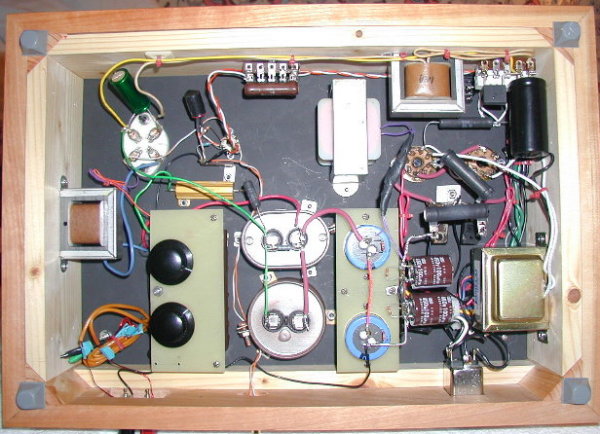

This amp I built for myself was made from parts I already have from my previous project. Although the PSU works, I do not recommend doing it, if you still have to buy a power tranny. What I do recommend is to follow the power supply from the original schematic and get the power tranny from Electra-Print or have somebody wind it for you, with that same spec. Follow my main amp circuit schematic though using the 6AN4 as driver tube. Also, on the 300b cathode, there is a divider network. The original schematic from the randall museum uses an adjustable power resistor made by Ohmite, with two wiper, one connected to the driver choke and the other to ground, my circuit uses two 750ohms/25watts rheostat, these are used to adjust the operating point of the 300B and the driver tube. It is easier to adjust using these rheostat than using an adjustable resistor in which you loosen up the screw that holds the wiper and then moving it up or down. Also you have to do this when the power is off, while using a rheostat, you can adjust while power is on. The only disadvantage is that the rheostats are expensive, I got mine from a surplus store for $12.50 a piece, and you need 4 of them.
Here are the major parts you need:
1 x Electra-Print OPT ST3KB (do not substitute)
1 x Electra-Print Choke 65H/20ma (driver load, do not substitute)
2 x ASC 40uf/440vac Polypropylene Oil Caps (From Allied Elec, do not substitute, connect in parallel to make 80uf)
1 x 5k/50w adjustable resistor with 2 wiper (Ohmite or equivalent)
110ohm/ 1/2watt resistor (metal film, driver cathode)
100uf/16v electrolytic cap (recommend black gate, but any good brand is ok, driver cathode by-pass)
47k/ 1/2watt resistor (metal film input load)
300B tube (I like the JJ)
6AN4 tube
1 x power tranny: 575v-0-575v 250ma, 5v/2a, 7.2v/2a, 6.3v/.5a Electra-print or equivalent)
10H/200ma choke (Electra-print or equivalent)(Electra-Print cheaper than hammond)
30mh/1.4a filament choke (Electra-print or equivalent)
2 x 6AU4 (rectifier)
2 x 100uf/450v (panasonic digikey or equivalent)
2 x 470uf/450v (panasonic digikey or equivalent)
2 x 10000uf/16v (for 300b heater)
4 x 330k/1w bleeder/balancing resistor
1 x 50ohm/5w resistor
1 x 4A 50PIV bridge rectifier for 300b heater
1 x 0.68ohm/3w for 300b heater (to lower the voltage a bit)
Ok, there you go, these are for one channel only, so multiply by two to make stereo. The only thing missing are the hardware and chassis.
1 x 6.8 ohm/3w for 6AN4 heater (to lower the voltage a bit)
Follow my main circuit schematic except the 300B cathode resistor assembly, just use a simple adjustable resistor and you should be ok. Follow the original power supply schematic, not mine as mine is sort of jury rigged.

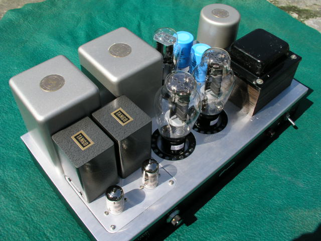

this several day I directly run in this amp & test the continous condition, stable or not for the coming kit over 30 hours.
( Transformer couple 300B/2a3/45 amp)
I still use 6C45/we437a Single triode to driver the Tango NC 16 to drive 300b with James Choke & output.
I also keep this in a very reasonable price. But I must make sure it will very stable to make the user not disappointed.
pls see the photos.
I reference this circuit & only a littler change it then more reasonable price<USD 1200 can get it. With all famous transformers. I also use 99.99 pure solid silver core to connect the ground. Its really very slient.
The sound is much better than my friend's audionote amp.
I really satify.

Thomas: The schematic you referenced has more parts in the signal path than the direct drive schematic provided by Alex. Your schematic has the signal passing through a variable resistor (pot) and the transformer. Also, with the resistor / capicitor dropped down between the input tube and driver tube, you have lost the constant current source provided by the transformer alone between the two. That being said I have no personal experience saying that your design would not sound as good as the other, but much has been said for the sound of the other design, and the theory behind it makes perfect sense.
