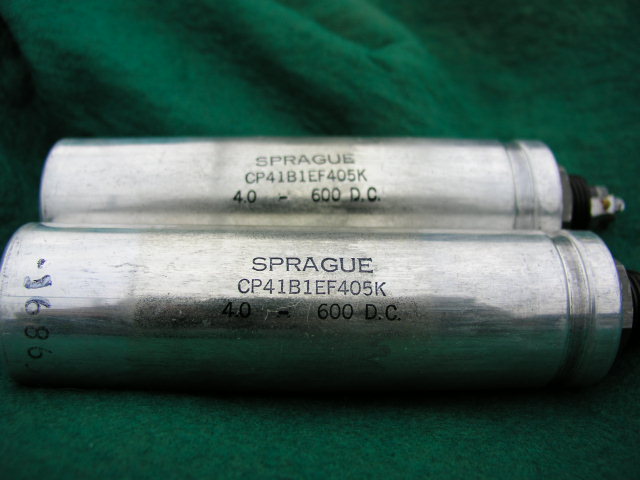

If Use in the first stage not need to use 40uf. 4uf is OK. If the choke is better. use small cap can low the high freq.
pass the choke choose 47uf or 100uf.
why not try to test this method Ok or not. I test them in my lowther & la scala.
I test with lowther to hear the high freq lost.
small cap is better. oil cap with PCB is better than non-PCB.
Choose DCone, AC is the motor start cap, really not good.
thanks
Thomas

Pls see the oil cap i choose.
I made thisa choose was NOS, OIl with PCB & size was fit to modify, circular size as elect-cap round size.
pls see the oil cao i use in the kit.

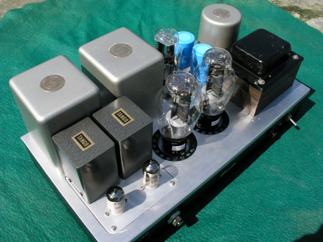

Certainly, the choke & output will in same brand name. as the photo show.
this is the power trans standard.
If u choose Tango or james must cost USD 200 or more without postage. But the quality may or may be better than my custom build.
Mike, U know all the parts I choose was the very good quality one. All in quite high price.
I only use my private method to get them in lower price but they still not made from me. I can't to maintain all in low price as they private build.
If U not like transformer couple. the picture show minus two tango interstage is OK.
