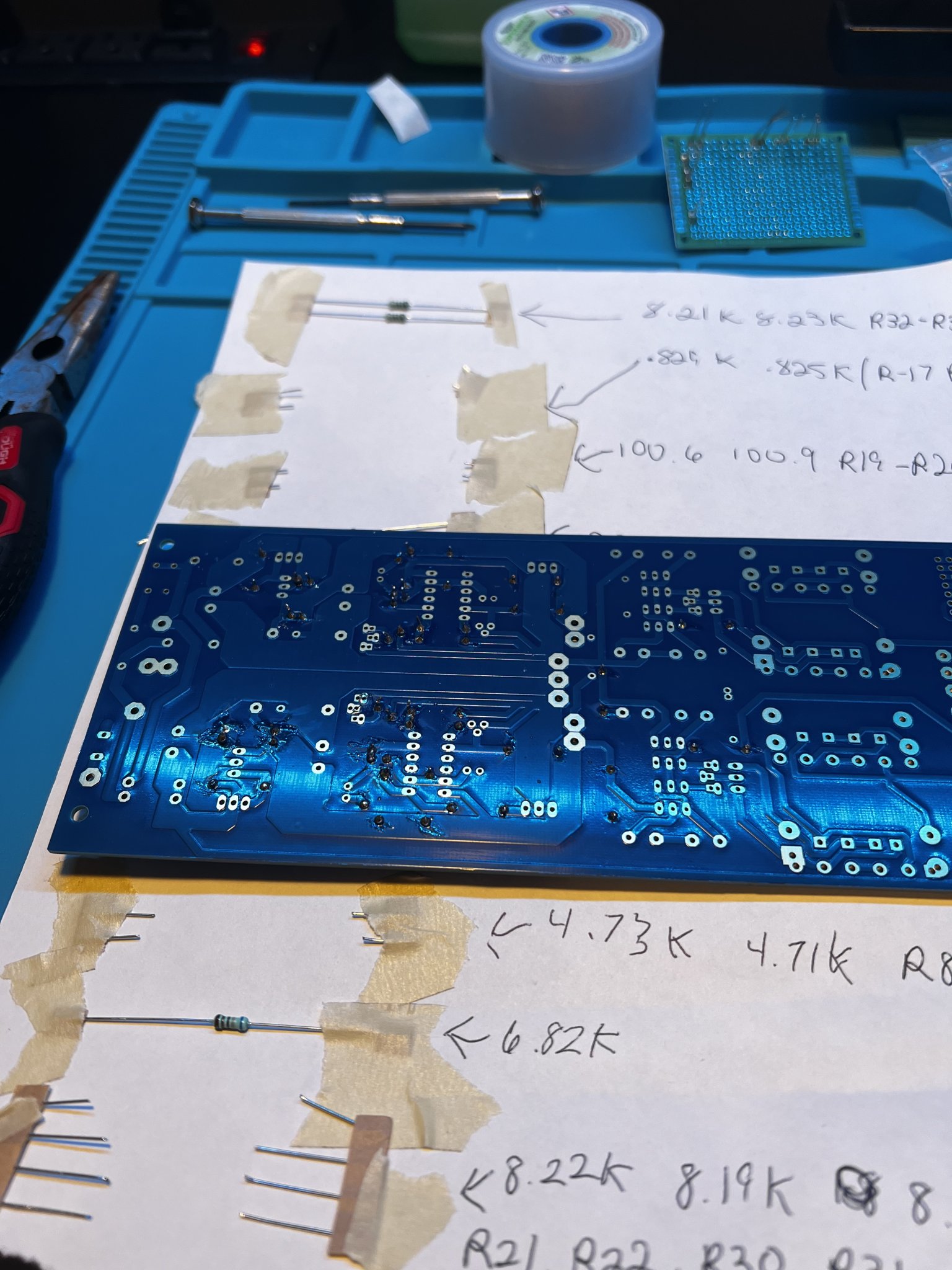

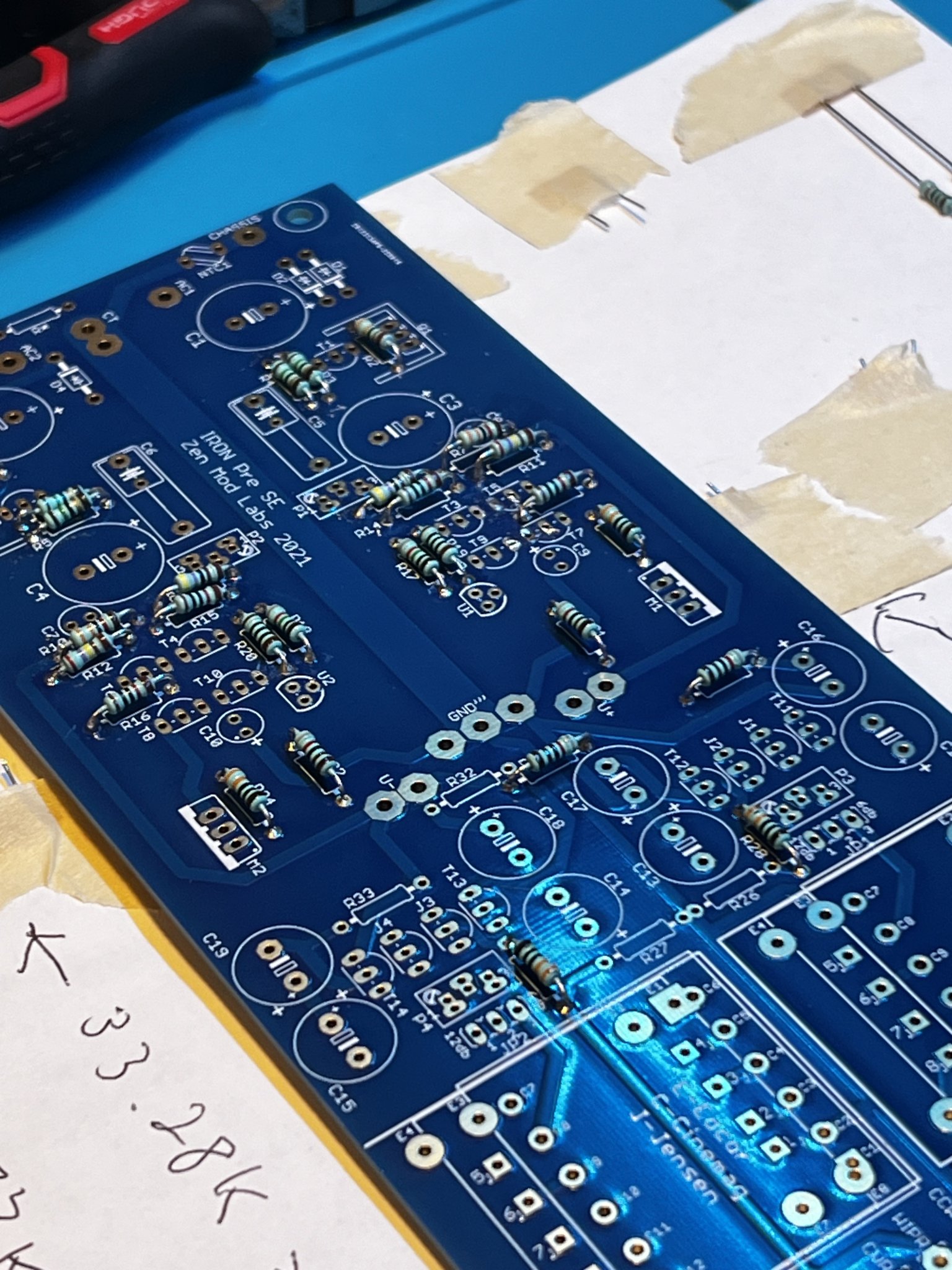

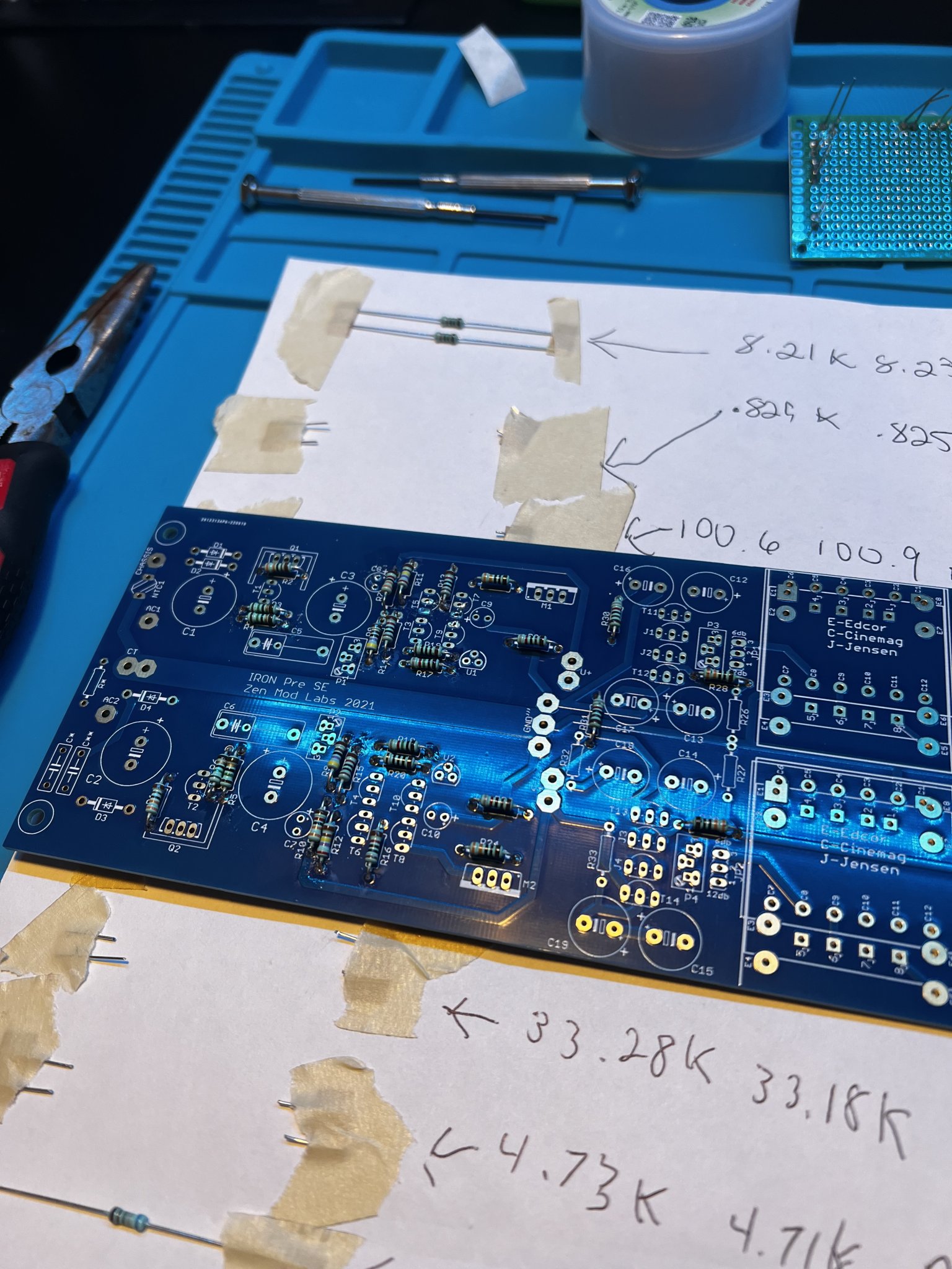

Almost done with resistors. Lead benders is on the list of things to get next. As usual, went fast and made a mess the last time, tried to clean it up and go slow this time. Still got to clean things up a bit.
Waiting on parts for other project. Was just itching to make progress on something. Less talk and more progress!

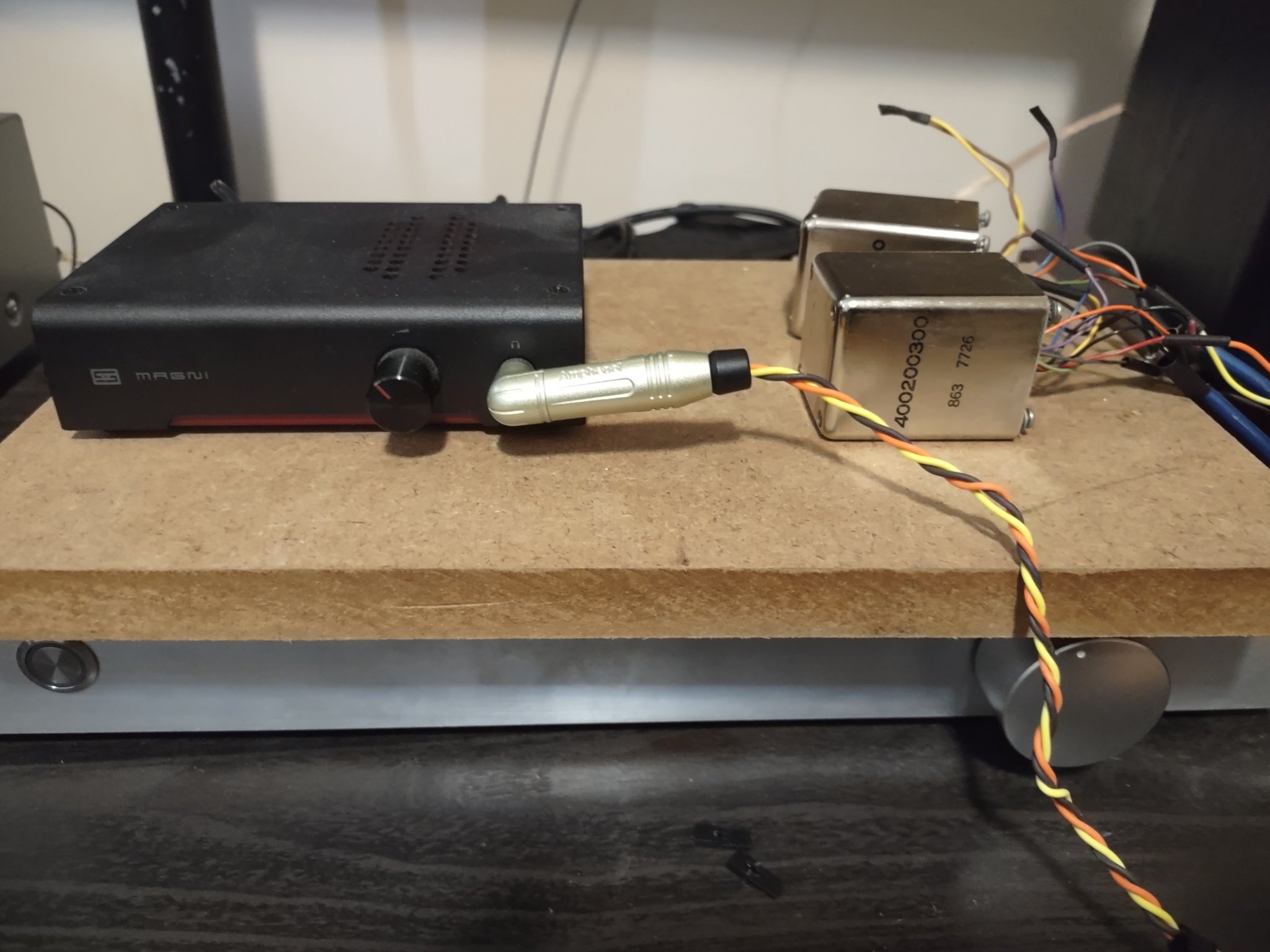

I've been using a B1 buffer to drive an ACA Minmax. And the setup works well but I wanted to try a preamp with a little gain. So I threw this together. It's a little Schitty, but I like it 😛
I got them from this place, https://www.mzentertainment.com/store_dr_zee_workshop_parts_transformers.html . It's the NEC p/n 400200300. The 11th one on that page.
Hi @thirdicomplex, have you compared the sound to that of the Iron Pre? It's probably very similar.
The reason I'm asking is that the B1 doesn't sound the same as the Iron Pre. Adding iron will probably bring the sound closer.
I also have a B1 buffer and for gain I sometimes use the H2 V2 with H2 turned down for less "good distortion". The H2 V1 also works well for gain.
No, I don't have ZM's Iron Preamp. So can't compare. This was just to test out the concept. I'm going to make a permanent build but I was planning on using XRK's M2X daughter board tester. So it'll be an Iron Pre X
. Before I get to that though, I want to play with some tubes. I'm currently sourcing parts for a 12b4 preamp. Which should have slightly more gain but still low enough to be practical with typical power amps.
