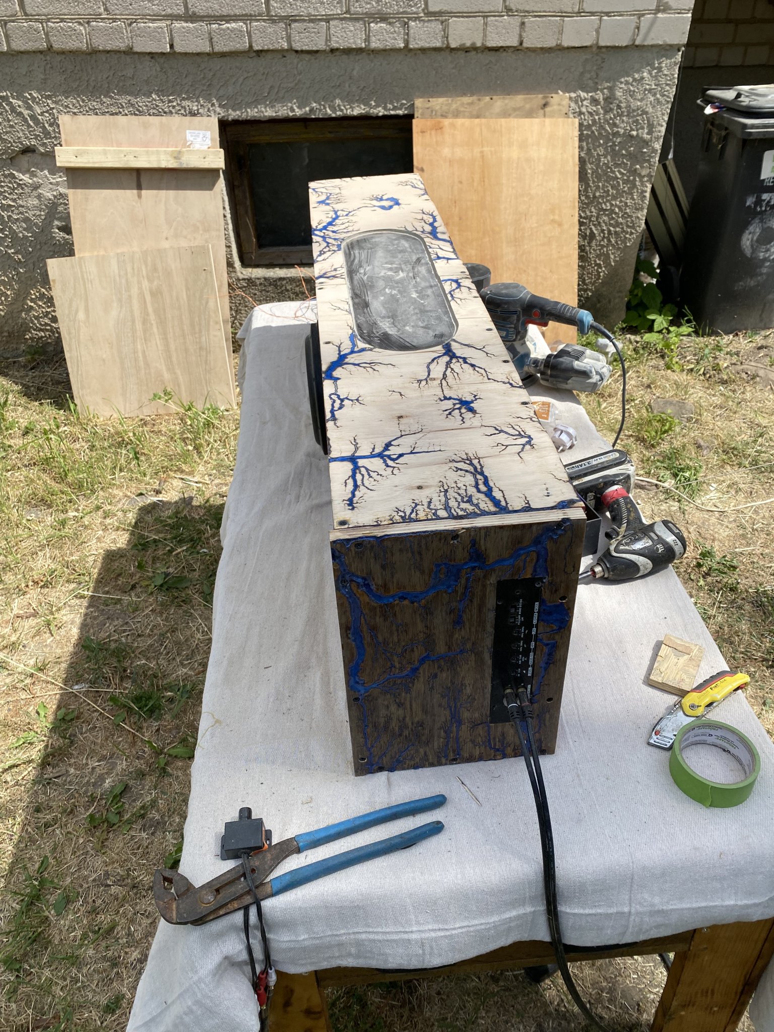

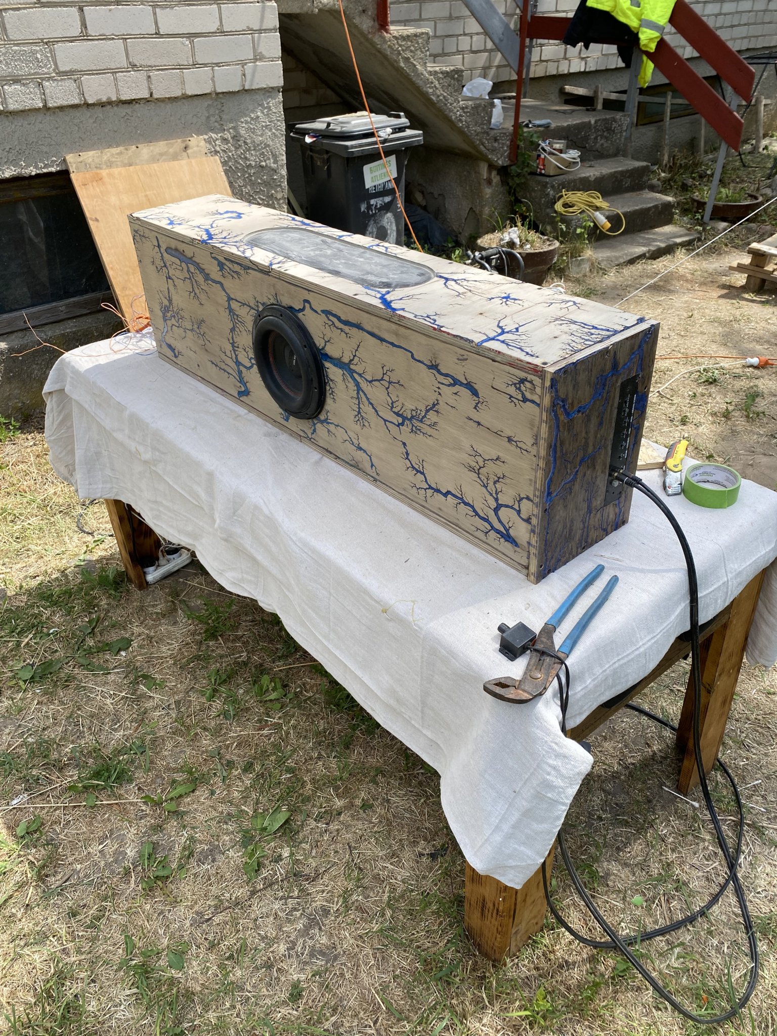

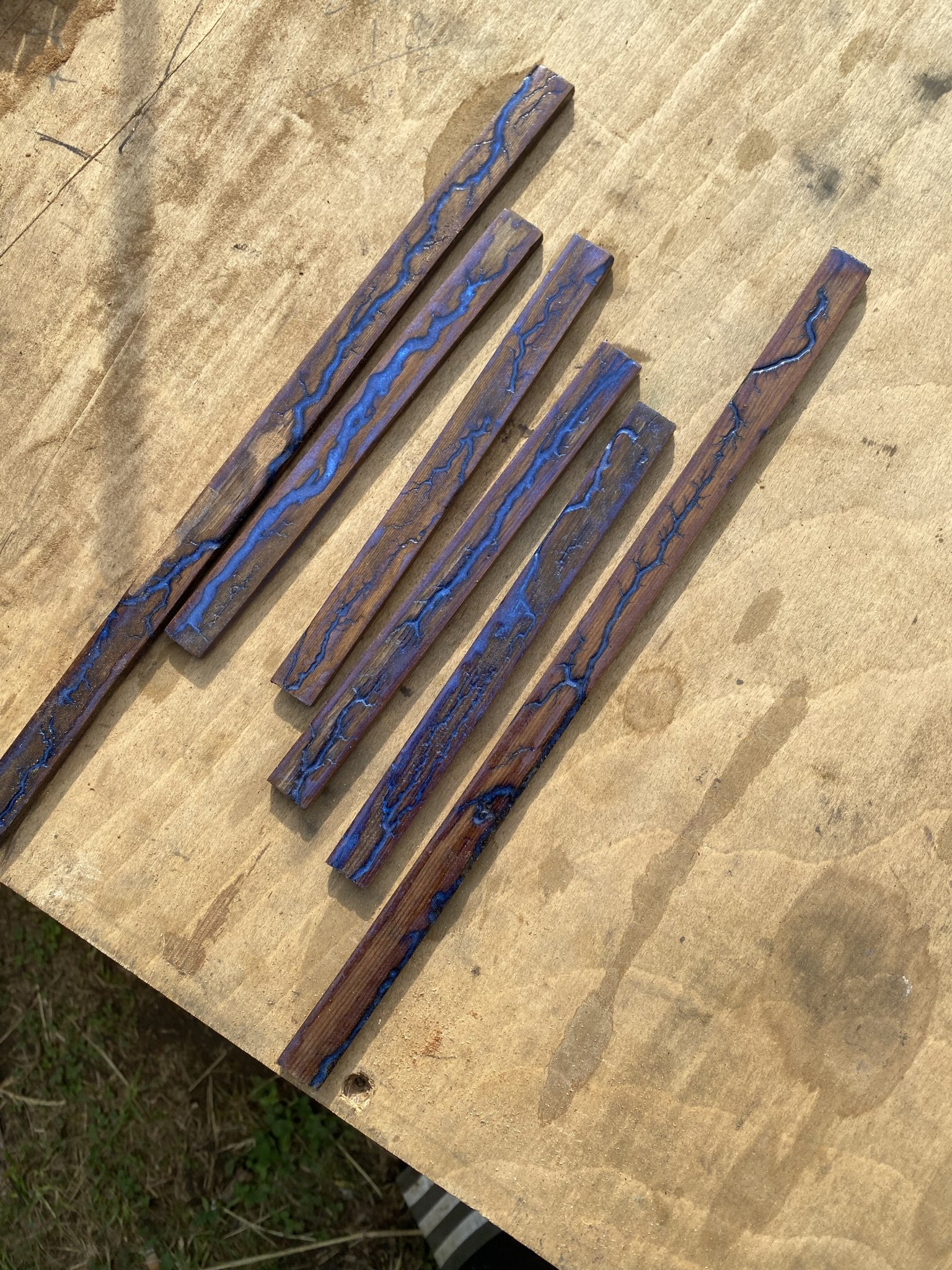

Well it’s really great at the moment I got the gains set and the Lpf on the right spot, so it works great with the other amp no latency just great, lol on a side note I broke the small amps headphone jack so I only got my new small amp today at 9pm 😫😫 didn’t listen to music for a week can’t wait for tomorrow 😎.

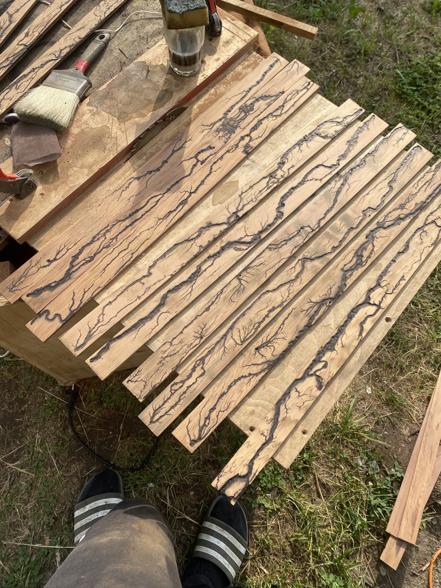

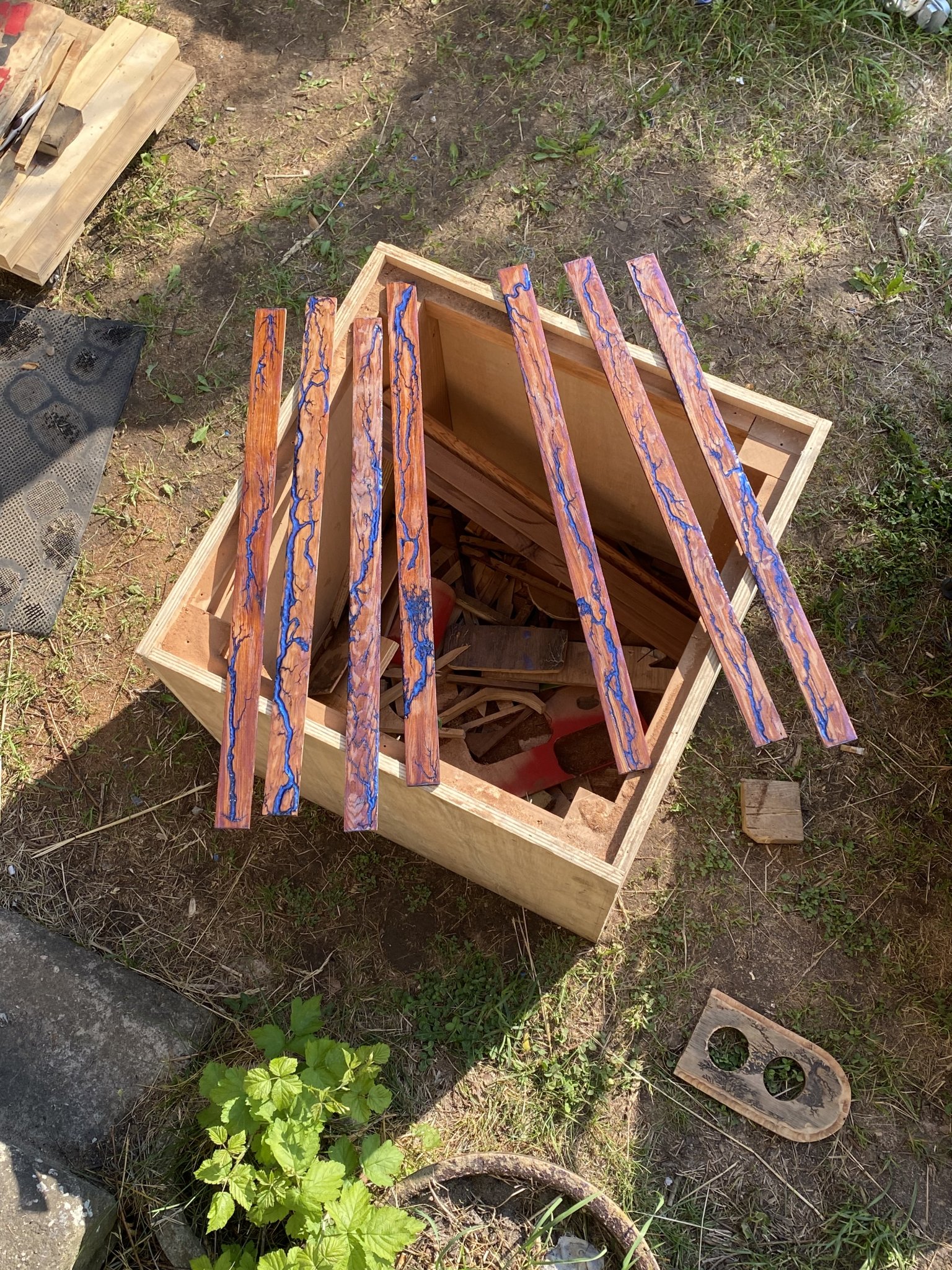

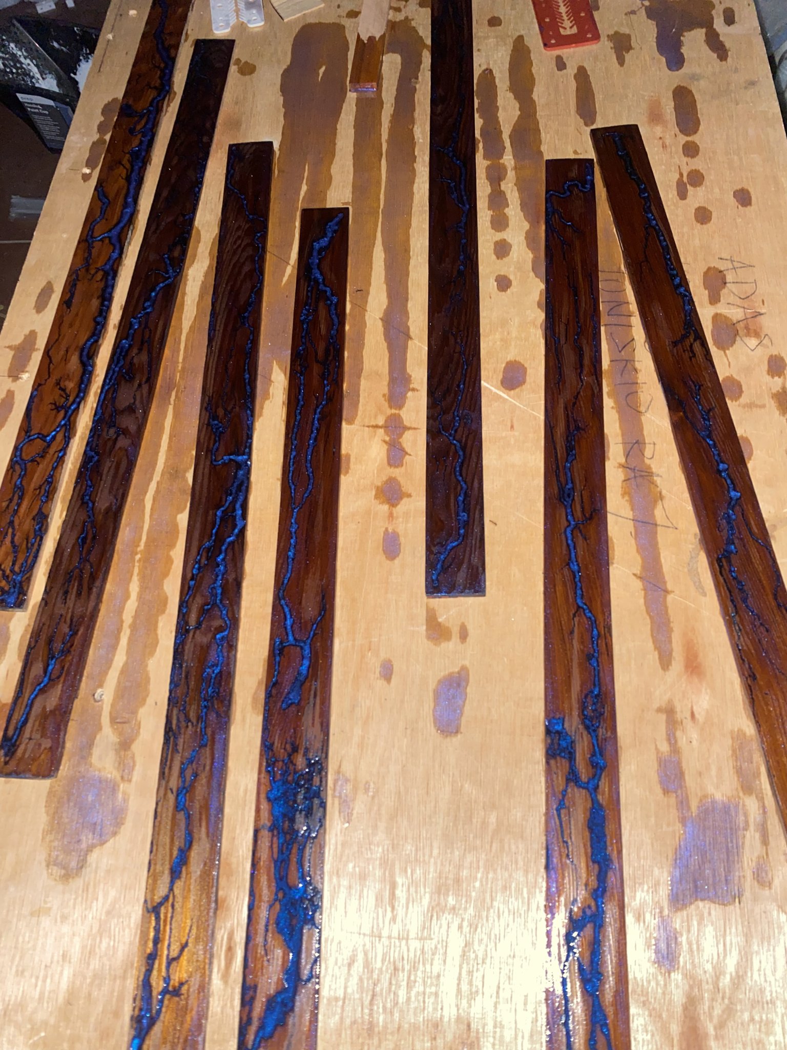

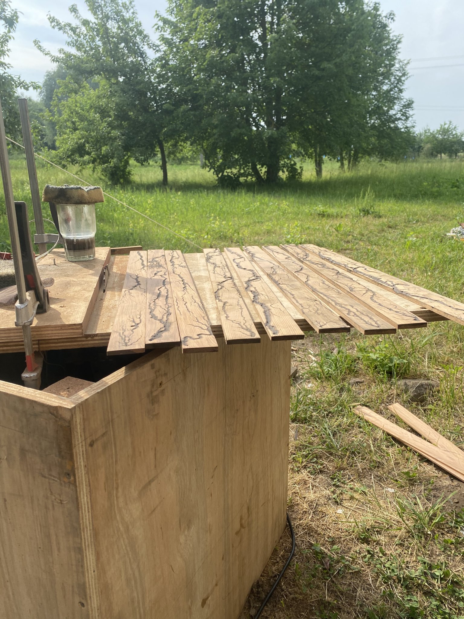

For the engraving, it’s called fractal burning REALLY DANGEROUS STUFF SHOULD NO TRY UNLESS YOU KNOW WHAT YOU ARE DOING, it uses a microwave transformer converting 240v to about 3,000-5,000volts making the wood conductive with some water and bicarb which gives these cool looking burns, after that I fill the burns with epoxy to give it some colour, but you can find some stuff on YouTube if you search fractal wood burning.
Once am finished with this box am thinking of doing a simpler sub box with amp and these engraving art/details and try list it on some websites, I haven’t seen any sub boxes looking like that, also these engraving are always different 😁.
I have couple pics of the of the cedar wood that il be using on the corners to hide the screws and the ply edge.
Also pics don’t show what I see, in the pictures it may look really nice but in person it’s on other level 😎

"Fractal" was the word that came to my mind on first viewing your artwork.
My elder son, who is arty, recognised the technique and told me how dangerous it was before I got to read out your description to him!
The engraving has produced a lovely effect on the cedar wood and, as you say, every pattern is unique. 😎

There is no safe way to do this artwork short of using a galvanically isolated robotic machine, the voltage and power levels in the presence of liquid electrolytes are stupidly dangerous and have killed and maimed many people... There are no gloves or PPE that can protect you from kV shocks and arc-flash when drenched in salty water spray generated. You might as well take a walk across a mine-field or go to the bottom of the ocean in a carbon-fibre cylinder - your days become numbered. Big Clive's warning video:
If you do your research the main cause of death is people removing the transformer, which is the high voltage capacitor in the microwave, even if it’s left un used still may be charged to a high voltage, for the transformer if you use a pedal and switches to make it safe as you can, I DONT RECOMMEND TO DO THIS, I done my research I used plenty of times and am here writing this 🙂
I'm sure all the victims thought exactly the same before things went wrong, hubris is rife, any attempt at a risk assessment would identify many routes to death, with very few viable mitigations - high voltage at high power, salt solutions and humans do not mix, end of story. Remove any one of them and it might be feasible, so galvanically isolated remote manipulation could be one way to make it actually safe.
However its much safer (and contollable) to laser cut a veneer into whatever pattern you like, or laser-etch into solid wood. You can get symmetrical speakers that way too.
