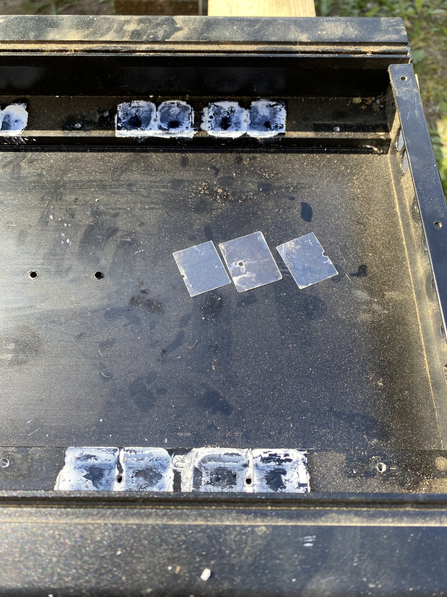

Those are mica insulators and are used to electrically isolate components such as transistors from a heat sink or a metal case.
Mica is a naturally occuring mineral which is a good conductor of heat. It comes in thin sheets which are brittle.
You should also use heat-sink compound between the mica and the component, as well as between the mica and the heat sink itself.
I would use the thinnest pad, and the heat-sink compound (if required) should be applied in a very thin layer also.
P.S. If the mica insulators are intact and in good condition, I would simply re-use them to ensure the heat transfer is up to the original specification.

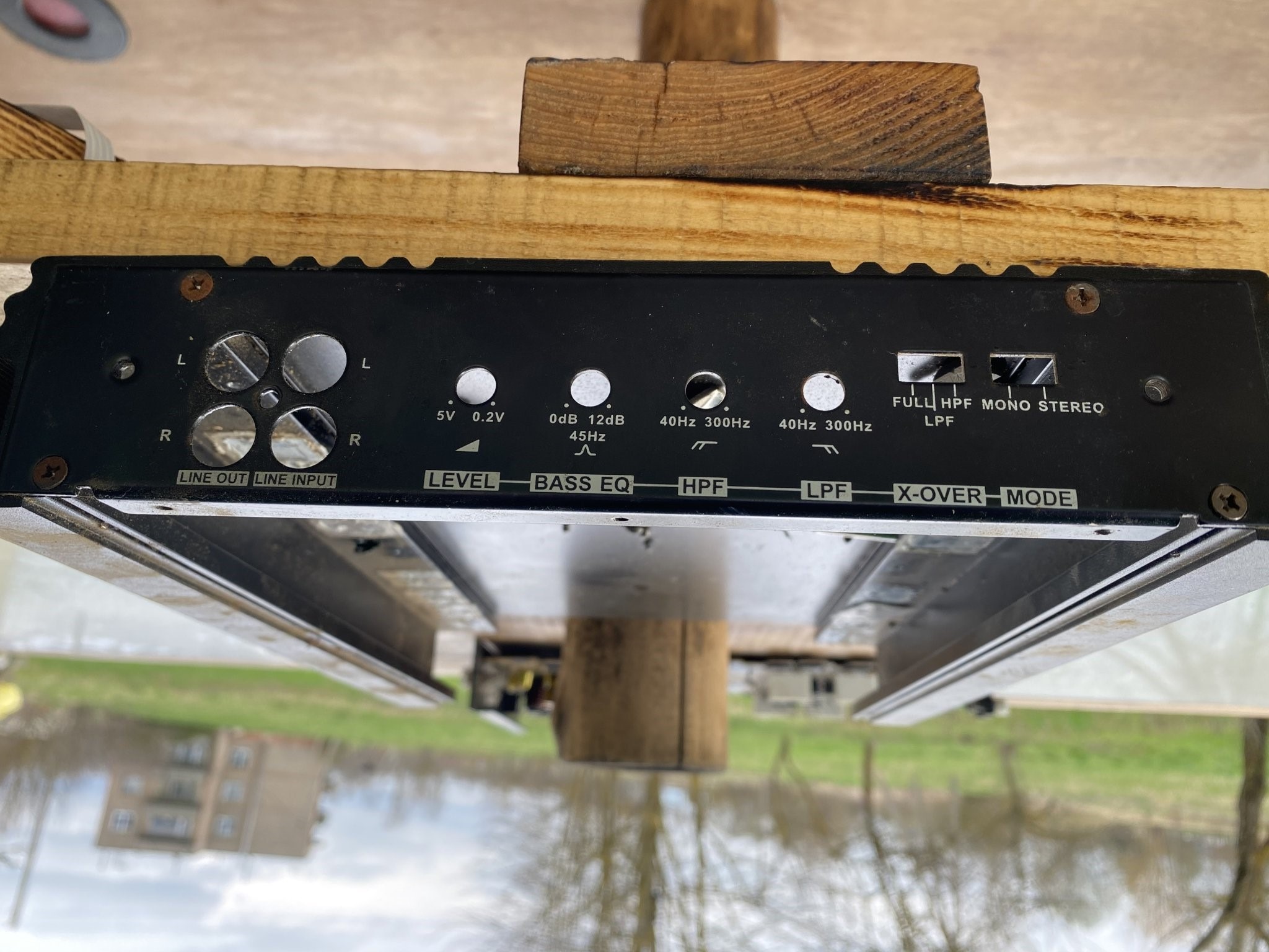

I'm not exactly clear on how you propose to use your Thunder amp to power your subwoofer. I see you can select a low pass filter (LPF) output with the 'X-OVER' switch, then choose LPF frequencies of either 40 Hz or 300 Hz on the 'LPF' selector.
If you select 300 Hz, I presume that the amp will then deliver bass frequencies up to 300 Hz to your subwoofer.
(I must say that I am not an expert on car audio and have no previous experience of working with such amplifiers.)
I would say that 300 Hz is the preferable LPF frequency for use with your coaxial speakers. The coaxials can be run full range without a high pass crossover, as their acoustic contribution wll fall away naturally at the lowest frequencies.

Thanks, just wondering if the response frequencies of the sub is 50-4500 then it won’t pick up the 4501 and above so I could just use the full range maybe lol idk it’s okay imma do some research but they make it so complicated on the YT
You seem confused about how a subwoofer works.
A domestic subwoofer is typically used to cover the bass frequencies up to 200 Hz and is not intended to reproduce the higher frequencies.
The subwoofer's function is simply to reinforce the low-frequency range of the stereo speakers (i.e. your coaxials).
It should make perfect sense if you think about your 2 x 50 W + 100 W class D amp.
The 2 x 50 W section is the stereo amp (for your coaxials) and the 100 W section is the low pass filtered mono amp for your subwoofer.
Using the Thunder amp instead of the subwoofer section of the class D amp introduces a complication, and I'm not 100% sure that I am giving you the correct advice.
You'll just have to try it and see!

The 2x50w+100w has bad frequency control Ofc I will play around with both, il be getting a multi meter to make sure not to blow my speakers, it should work next week will find out, il be using UGREEN Bluetooth Receiver for HiFi to provide input to class D and Thunder Amp so lol I don’t wanna think, am sure it will work
If using the Thunder to power your sub, select MONO on the MODE switch. You may use the amp in BRIDGE mode when only connecting one speaker load (the sub) to it.
