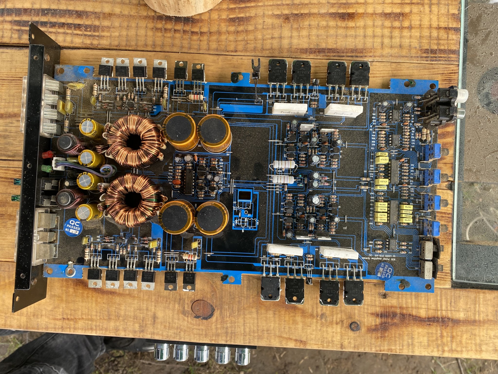

I got this amp it’s says 1200w Max blah blah…
The actual rms is 2x
200w for 2omhs
I got a sub coming that’s 200rms 400max
It should be fine, the amp got 2 speaker outputs and it’s 2-16omh amp, could I run my sub from one speaker output and my 4x30rms watt 3way coaxial 4omhs speakers from the second channel?
Running the coxial speakers at 8omhs will make them take 60rms, just not sure can’t find the amps 8omh load rms but am guessing from the image above it’s somewhere 70watt at 8omh
Please correct me if am wrong
This is for home project I already am running my coxial speakers with a cheap amp.
That seems rather a strange thing to do with a stereo amplifier.
The car amp is possibly capable of delivering 75 W into an 8 ohm load.
Do you intend to wire two 4 ohm, 30 W coaxial speakers in series to give you an 8 ohm, 60 W capable combination?
P.S. 60 W speakers can be run from a 75 W amp provided you do not max out the volume control!

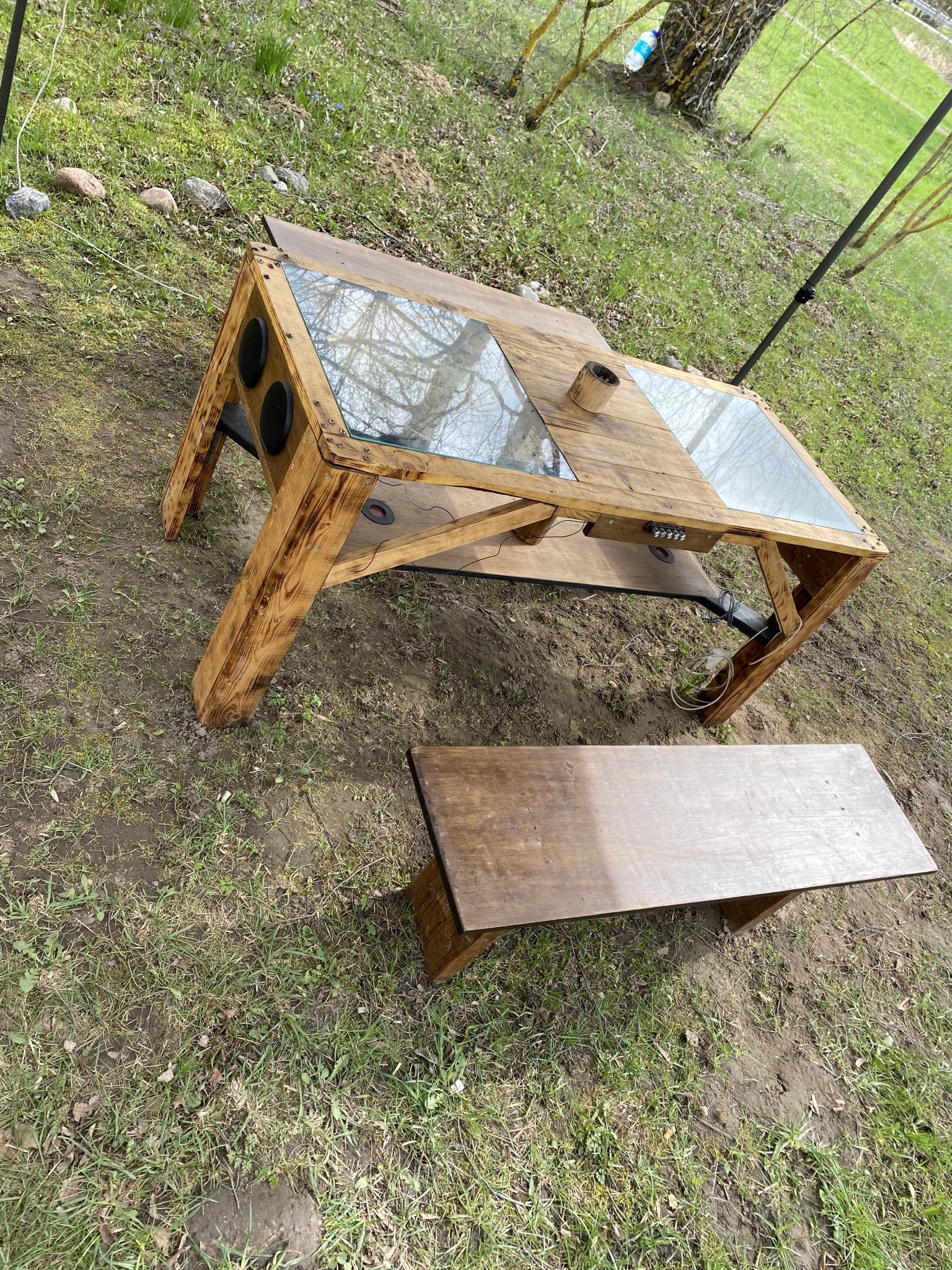

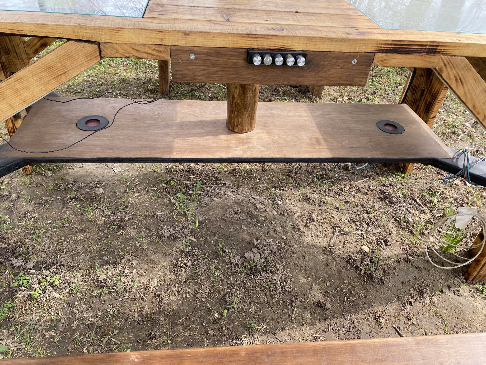

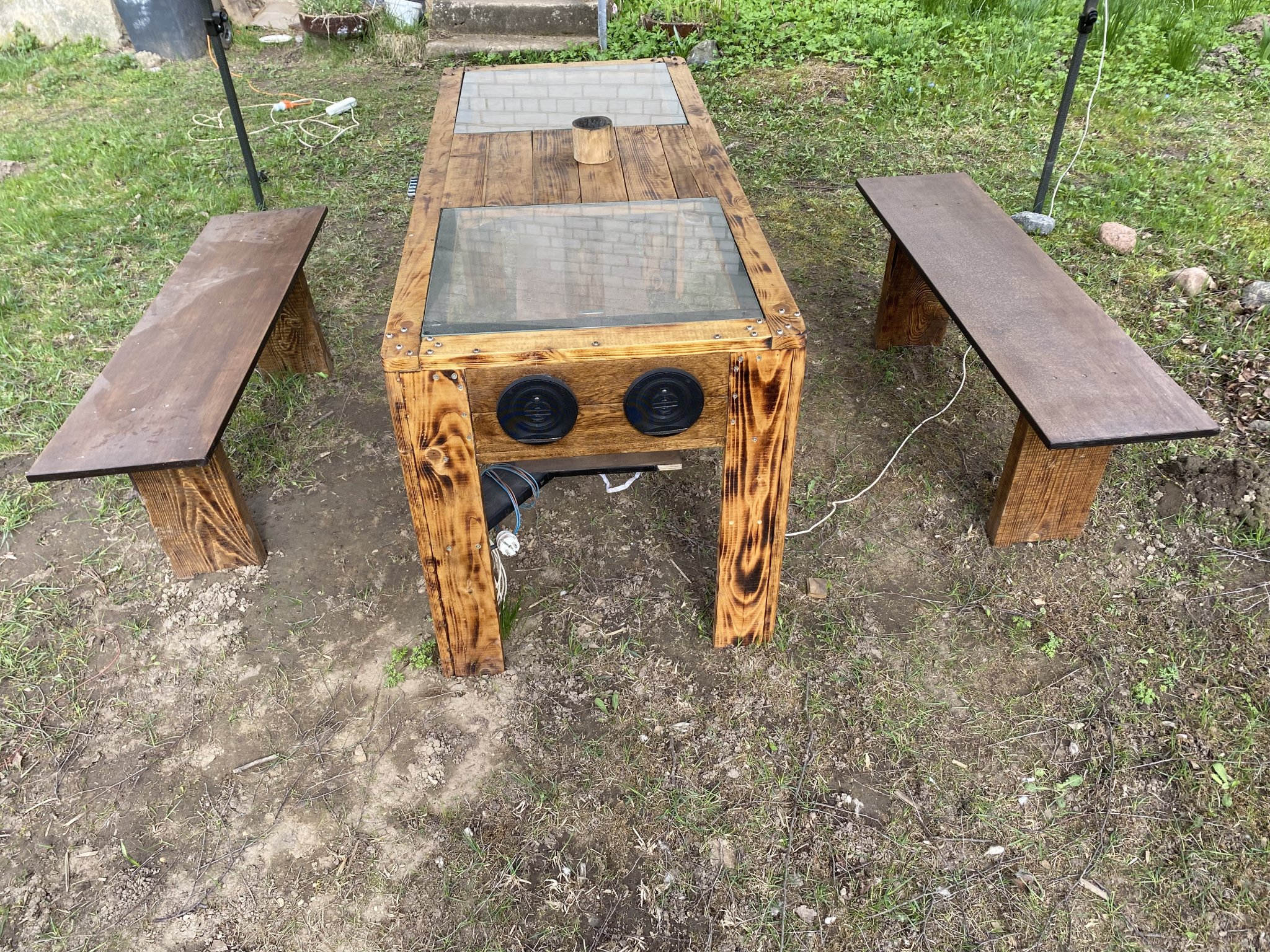

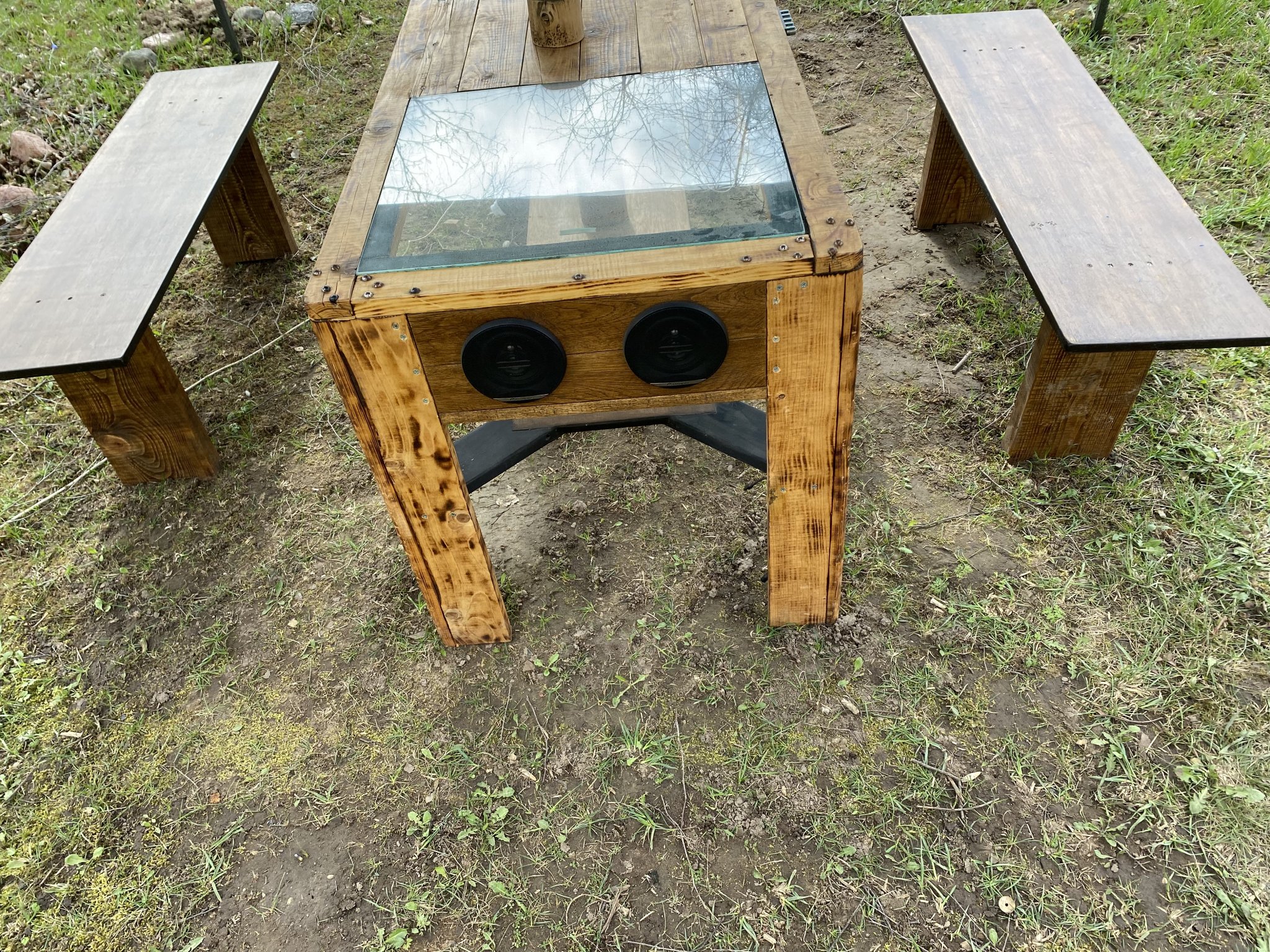

Thanks for the photos.
I see a pair of coaxial speakers at either end of the bench, and can see how you could place a sub box in the middle - that's cool!
For stereo reproduction, you would connect one pair of coaxial speakers to the RH channel of a stereo amp and the other pair to the LH channel.
The sub would have to be connected to its own, dedicated low pass filtered amp.
This can be achieved using your existing 2 x 50 W + 100 W class D amp. The 2 x 50 W section is the stereo amp and the 100 W section is the low pass filtered subwoofer amp.
I'm not sure if the Thunder TCA-2125 car amplifier can perform the same function as above. I would need to know more about it and its connections, but all the details I can find appear to be written in Bulgarian. I can, however, translate "Автомобилен усилвател" as "Car amplifier"!
Your suggestion of connecting the sub to one channel of the Thunder and the coaxial speakers to the other doesn't quite make sense to me, I'm afraid.

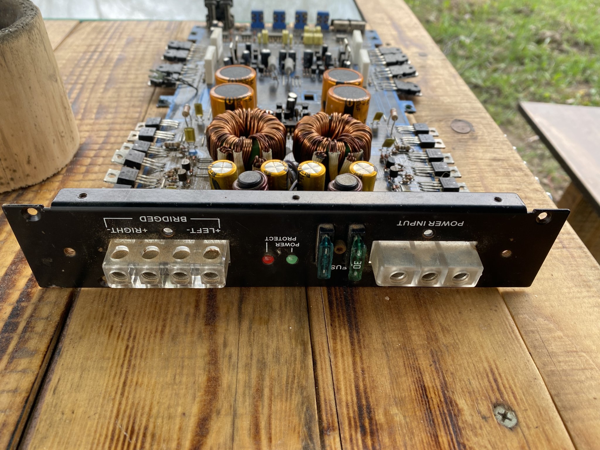

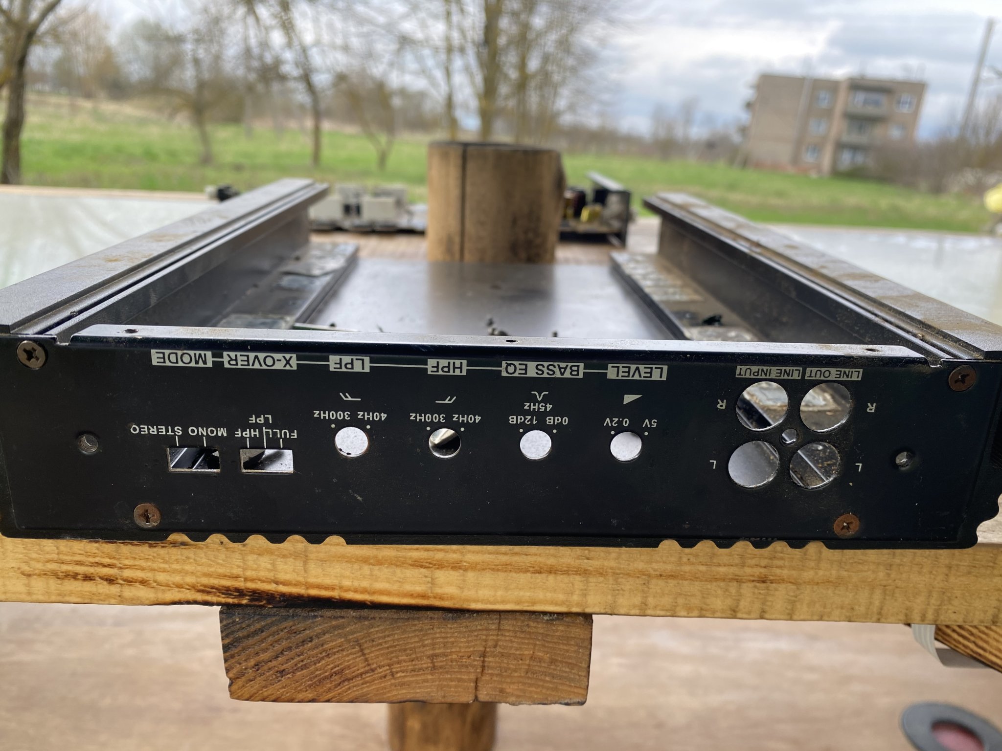

@Galu

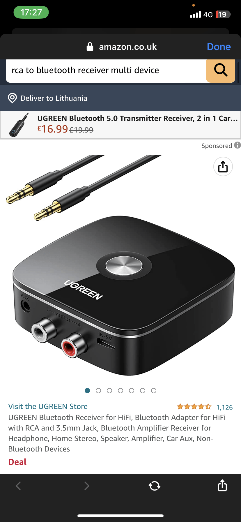

That’s the amps connections, I was thinking to use the 2x50+100watt amp for coaxial speakers and the Thunder 2125 amp for sub.
Using a Bluetooth receiver that supports RCA and Aux inputs
I use the 100watt output from the Class D amp for leds
Would that be the best option?
So, you intend to use a low pass filtered output from one of the channels on the Thunder to power the sub?
And to use the 2 x 50 W section of your class D amp can power the coaxial speakers in stereo?
